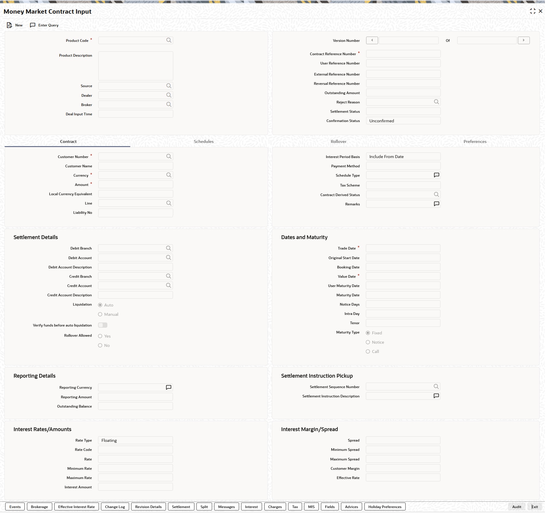

3.1.1.1 Money Market Contract Input
This topic provides the instructions to capture the details of Money Market Contract Input.
  1. On the Home page, type MMDTRONL in the text box, and click the next arrow.
    Money Market Contract Input screen is displayed.
    Figure 3-1 Money Market Contract Input
    Description of Figure 3-1 follows
    Description of "Figure 3-1 Money Market Contract Input "
  2. On the Money Market Contract Input screen, specify the following information:

    Reporting Currency
    Select the reporting currency from the option list.
    Reporting Amount
    The system displays the amount.
    Outstanding Balance
    The system displays the total amount due as of the value date.
    Settlement Sequence Number
    Choose a settlement instruction by specifying a settlement sequence number. You can skip this field if any default settlement instruction is already specified.
    Note: At the time of specifying settlement instructions, it is now possible to choose from multiple instructions that are maintained for the same branch, customer, currency, module and product combinations. You can choose any settlement instruction from a list of values. The list of values displays the Settlement Sequence Number and Settlement Instruction Description.
    Specifies the description of the selected settlement instruction.
    Rate Type
    The rate type applicable for the selected product will be displayed. It can be one of the following:
    Fixed: a fixed interest rate
    Floating rate: an interest rate that changes periodically or automatically as per your specifications in the Floating Rate Table
    Special: an amount instead of a rate. You cannot modify the displayed value.
    Rate Code
    For Floating Rate, the rate code will be displayed. You cannot modify it.
    Rate
    The Rate applicable for the selected product will be displayed. You cannot modify it.
    Max Rate & Minimum Rate
    The maximum and minimum rate allowed for the selected product will be displayed. You cannot modify it.
    Customer Margin
    The margin specified at customer level will be displayed here. You cannot modify it.
    Interest Amount
    The interest amount for the selected product will be displayed. You cannot modify it.
    Interest Margin/Spread
    The following are Interest Margin/spread details:
    Spread
    The spread value for the selected product is displayed as specified in the product level. You can modify it.
    Minimum Spread & Maximum Spread
    The maximum and minimum spread that is applied for the selected product is displayed. You cannot modify it.
    Note: This spread should be greater than or equal to the Minimum Spread and less than or equal to the Maximum Spread defined for the product involved in the deal. If the spread you apply happens to be greater than the Maximum Spread, then the Maximum Spread is applied on the rate. On the other hand, if it is less than the Minimum Spread defined for the product, the Minimum Spread is picked up. For a floating rate, the spread is applied over the market rate applicable for the day.
    Negative Interest Rates
    Negative fixed rates or resolved rates is allowed in the MM contract or amendment only if negative interest is allowed for the main interest component. You can maintain the contract interest rate (negative or positive) against main interest component only.
    If the effective interest rate is negative, then it is internally assigned to negative interest component, and you have to set up accrual and liquidation entries for the negative interest component. Special interest amount and negative interest amount will not be allowed in Interest Amount and Acquired Amount fields of ICCB screen respectively.
    If negative interest is not allowed for a product and if the effective rate becomes negative during batch rate revision, then the rate revision is skipped for the contract and exception will be logged.
