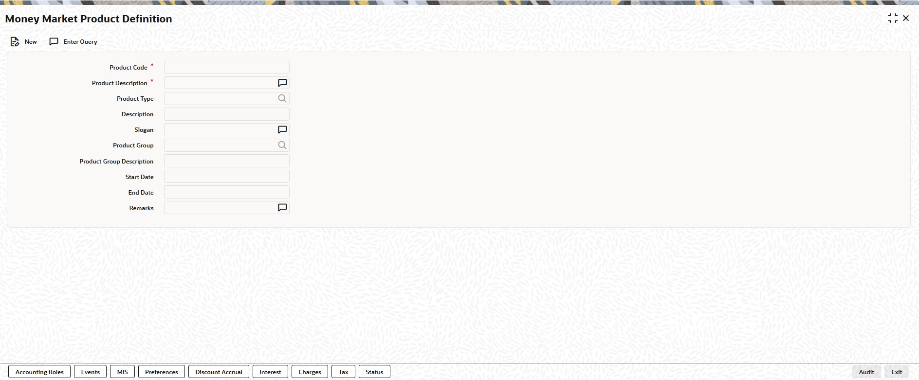

You can create a Money Market (MM) product in the Money Market Product Definition screen.
In this screen, you can enter basic information relating to a Money Market product such as the Product Code, the Description, and so on.
  1. On the Home page, type MMDPRMNT in the text box, and click the next arrow.
    Money Market Product Definition screen is displayed.
    Figure 2-1 Money Market Product Definition
    Description of Figure 2-1 follows
    Description of "Figure 2-1 Money Market Product Definition"
  2. On the Money Market Product Definition screen, click New.
  3. On the Money Market Product Definition- New screen, Specify the details as required.
  4. Click Save to save the details or Cancel to close the screen.
    In addition to these generic attributes, you can define attributes specifically for a money market product. These attributes are discussed in detail in this topic.
    For further information on these generic product attributes, please refer the following Oracle Banking Treasury Management User Manuals under Modularity.
    • Product Definition
    • Interest
    • Charges and Fees
    • Tax
    • User-Defined Fields
    • Settlement
    For information on fields, refer to the below table.
    Table 2-1 Money Market Product Definition - Field Description
    Field Description
    Product Code
    This is a Mandatory field.
    Enter a unique code to identify the product throughout the module. This code should have four characters. You can follow your conventions for devising this code.
    While defining a new product, you should enter a code, which is unique across the different modules of Oracle Banking Treasury Management. For instance, if you have used MM01 for the Money Market module, you cannot use it as a code in any other module.
    Product Description
    Enter a unique code and a brief description for the product that you want to set up. Enter a brief description of the product. The description is associated with the product for information retrieval purposes.
    Slogan
    Enter the marketing punch line to be associated with the product. This slogan is printed on all the advices that are sent to the customer for a deal involving this product.
    For example, if you have a borrowings product called Money Multiplier you could enter the slogan Watch your money grow with Money Multiplier.
    Product Type
    A product that you are defining can belong to any of the following categories:
    • Placement
    • Borrowing
    These product categories are referred to as ‘product types.’ When you create a product, you must specify the ‘type’ to which it belongs. For example, you should specify the product type as ‘Placement’ if you are defining a placement product and ‘Borrowing’ if you are defining a borrowing product.
    Product Group
    Each product classified under a specific group is defined in the Product Group Definition table. Select a Group ID from the option list. The product will belong to this group.
    Start Date
    A product is set up to be used over a particular period. The Start Date for this product is specified in this field. The Value Date (initiation date) of a deal involving this product should be:
    The same as or later than this date and
    The same as or earlier than the End Date
    End Date:
    Specify the End Date for the product. The Value Date (initiation date) of a deal involving this product should be the same as or earlier than the End Date. If you do not specify an End Date, the product is used until it is closed.
    The start and end dates of a product come in handy when you are defining a product for a scheme, which is open for a specific period. Remarks
    Remarks
    The remarks are displayed when the details of the deal are displayed or printed.
    Click Free Format Text button. Enter information about the product intended for your bank’s internal reference. This information will not be printed on any correspondence with the customer. Click Ok after you enter the information.

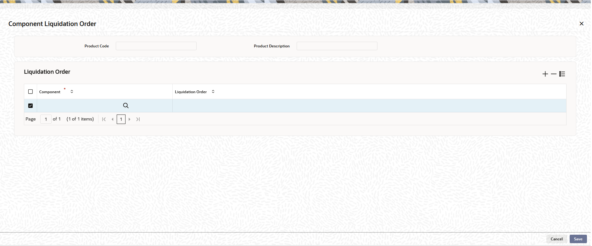

  14. On the Preferences screen, click Liquidation order.
    If you have defined automatic liquidation for the product, you can specify the order of liquidation of the various components, which have:
    • Schedules that fall due on the same day and
    • Same repayment account.
    You can specify the order in which you would like to liquidate components in the Component Liquidation Order screen.
    Component Liquidation Order screen is displayed.
    Figure 2-5 Component Liquidation Order
    Description of Figure 2-5 follows
    Description of "Figure 2-5 Component Liquidation Order"
  15. On the Component Liquidation Order screen, specify the details as required.
  16. Click Ok to save the details or click Cancel to close the screen.
    For a contract defined with manual liquidation of components, the Liquidation Order is considered when a payment has to be automatically distributed among the various outstanding components.
    For a contract with automatic liquidation, the order of liquidation becomes important when funds are insufficient in the repayment account on the day of liquidation, and more than one component has a schedule falling due on that day.
    Under such circumstances, you may want to allot priority to the recovery of certain components. For example, you may want to recover the interest (or interest type of components) first and then the principal. The aging analysis function takes over once a component is overdue, and an appropriate penalty is applied. For a component on which penalty interest has been applied, you may wish to recover penalty interest first, the interest next and finally the principal.
    You can specify the liquidation order for all the interest type of components and the principal.
