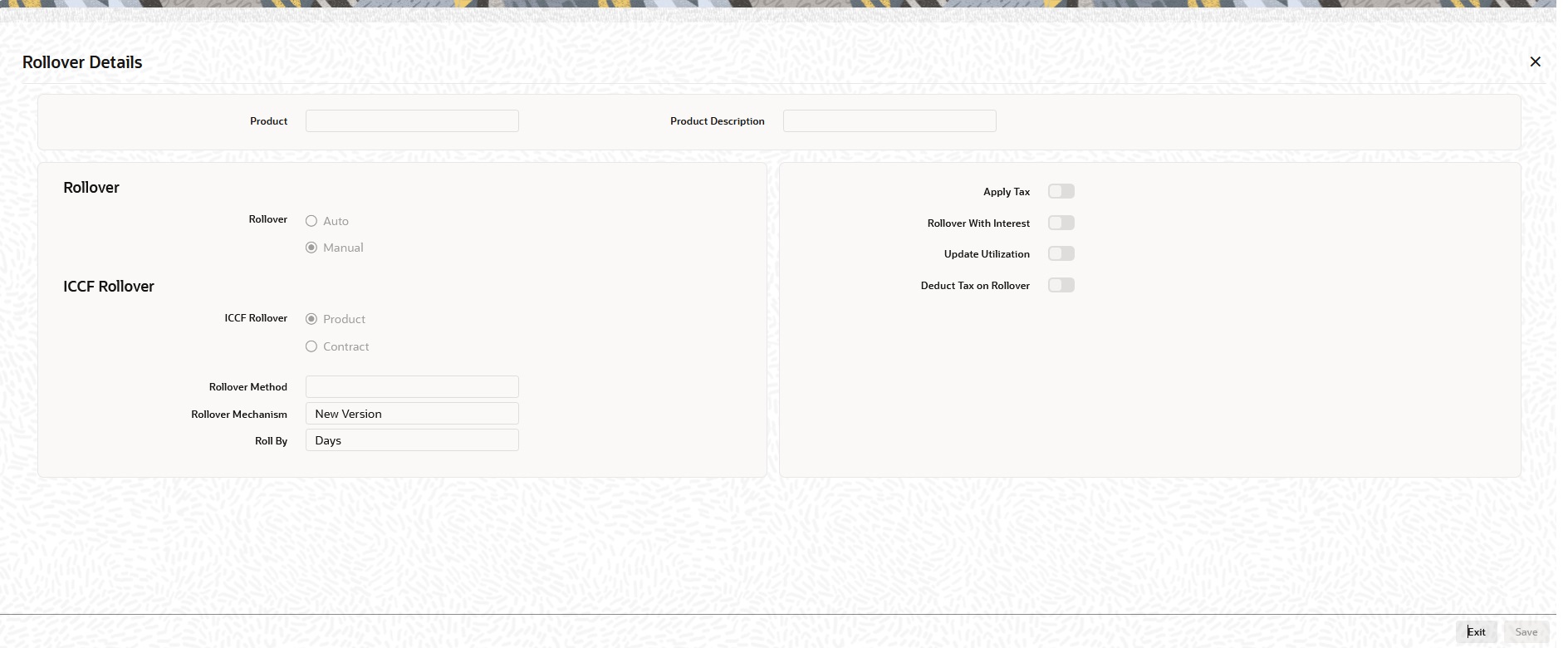

7.1.2.1 Rollover Details
This topic provides the instructions to capture the Rollover Details.
- On the Product Preferences screen, click Rollover.
Rollover details screen is displayed.
- On the Rollover details screen, specify the details as required.
- Click Ok to save the details or click Exit to close the screen.
For information on the fields, refer to the below table.
Table 7-2 Rollover details - Field Description
