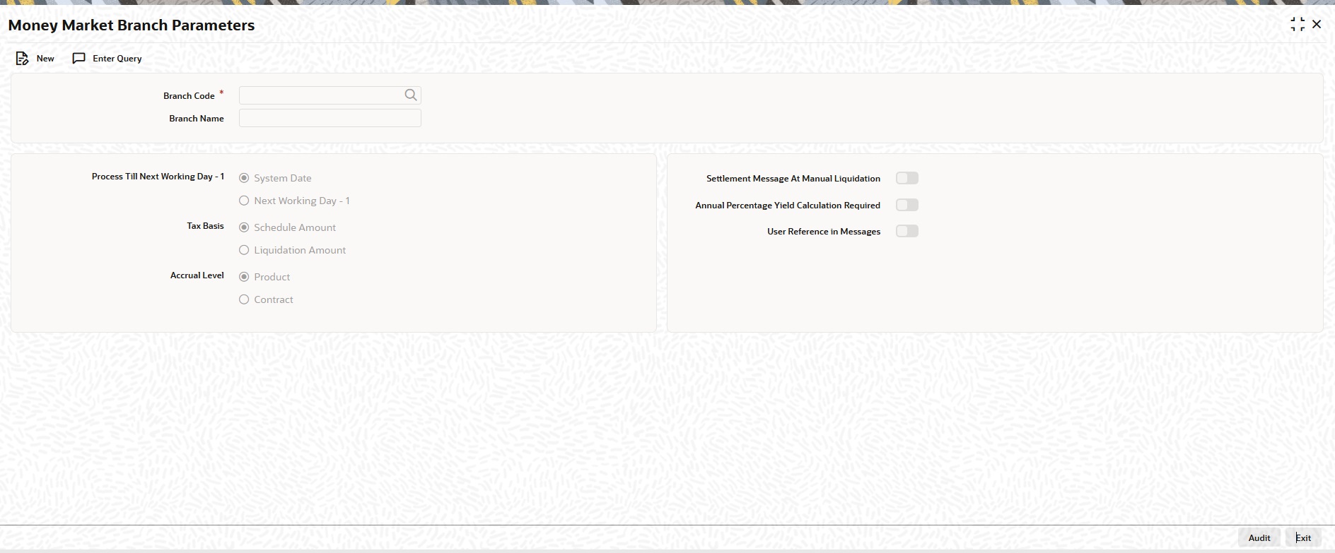

  1. On the Home page, type MMDBRMNT in the text box, and click the next arrow.
    Money Market Branch Parameters screen is displayed.
    Figure 8-1 Branch Parameters
    Description of lddbrmnt__cvs_main.jpg follows
  2. On the Branch Parameters screen, click New.
  3. On the Branch Parameters - New screen, specify the details as required.
  4. Click Ok to save the details or Exit to close the screen.

    Table 8-1 Branch Parameters Field Description
    Field Description
    Branch Code Specify the Branch code here.
    Branch Name Specify the branch name in this field.
    System Date If you specify that processing of automatic events should be done upto the System Date, automatic events scheduled till (inclusive of) the current system date is processed.
    Next working day - 1 Indicate whether events should be processed until the day before the next working day when the Automatic Batch Update function is run. If you do so, all the events that fall on days between the current system date and the next working date is processed.
