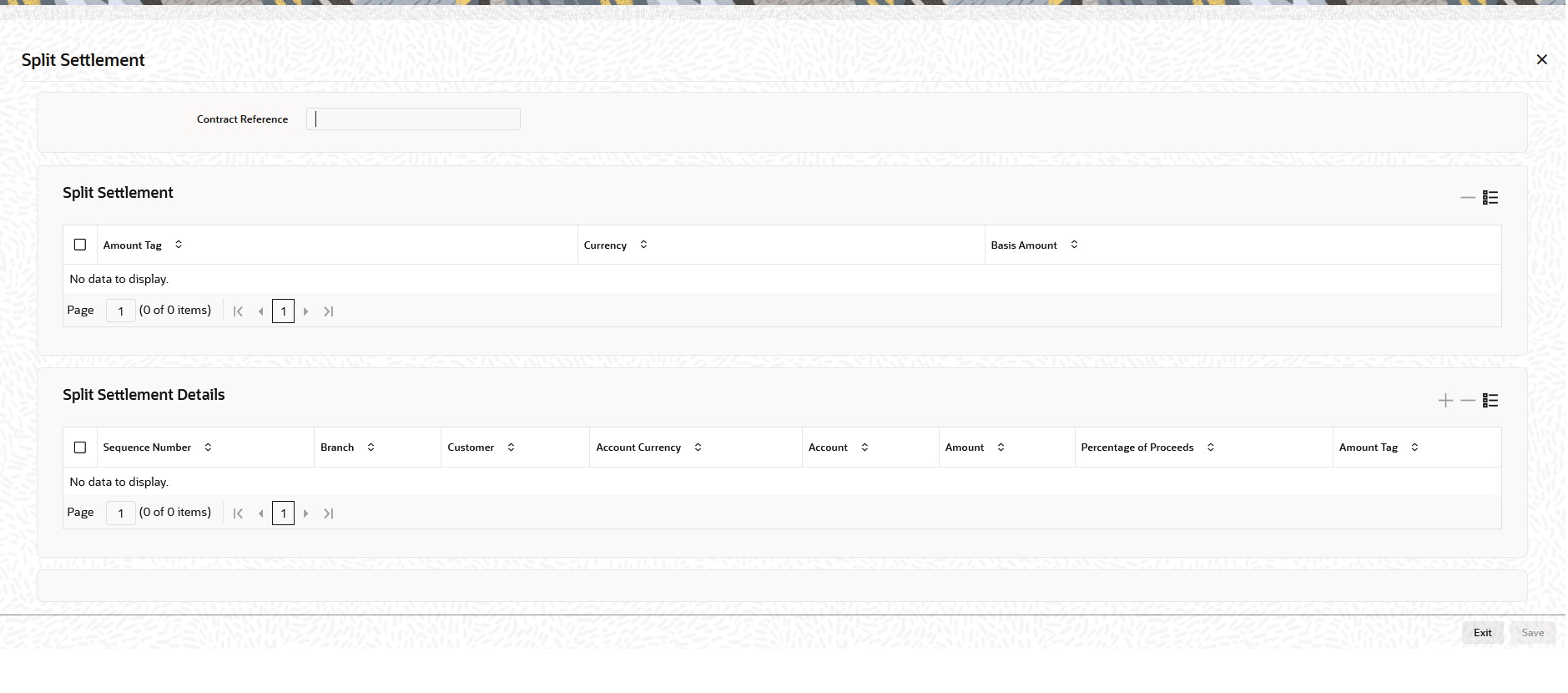

  1. On the Money Market Contract Input screen, click Split.
    Split Settlement screen is displayed.
  2. From the displayed list, select a contract.

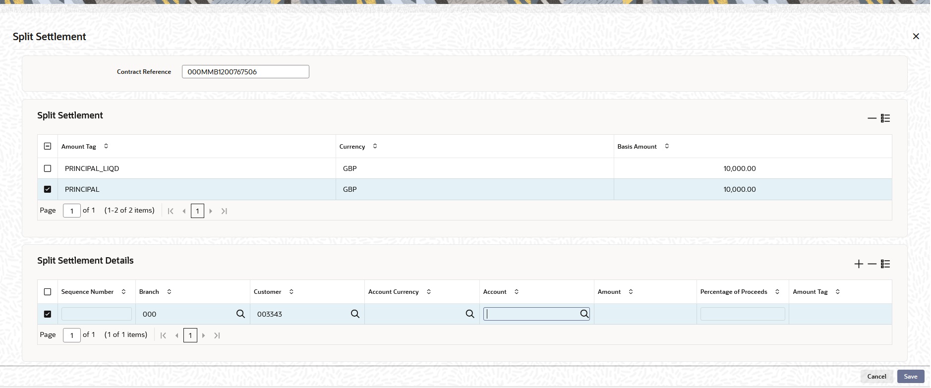

  3. On the Split Settlement screen, under the Split Settlement Details, click the Plus symbol.
    A new row is added under Split Settlement Details as shown in below.
    Figure 3-13 Split Settlement with a new row added
    Description of Figure 3-13 follows
    Description of "Figure 3-13 Split Settlement with a new row added"
    This process of splitting the settlements for a contract is allowed on the principal, Interest (Anticipated Interest for new contracts), and charges.
  4. Choose the Account Currency, Account, and other necessary details, to create a split.
