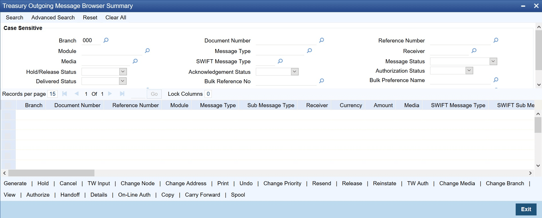

This topic provides systematic instructions for generating messages from an outgoing browser.
- On Homescreen, specify MSSTROBR in the text box, and click Next.Treasury Outgoing Message Browser Summary screen displays.
Figure 5-1 Treasury Outgoing Message Browser Summary
Description of "Figure 5-1 Treasury Outgoing Message Browser Summary" - On Treasury Outgoing Message Browser Summary screen, specify the details.

- If none of the criteria is selected, then the system displays all the messages in the outgoing browser.
- Funding Status will be updated during the processing of incoming MT102 and MT109.
- Check the box against the message(s) for which needs to perform an operation and then click the corresponding operation. The operations that can be performed on an outgoing message are determined by the rights that are assigned with at Security Management System (SMS) level. If a function in the Outgoing Browser is disabled, then the function is not allowed for the record. The action performed will require authorization, if maintained at the Messaging Branch Preferences level. The system allows only Print, View and Detail actions for messages generated by External Payment system. The following operations can be performed on the outgoing messages:
