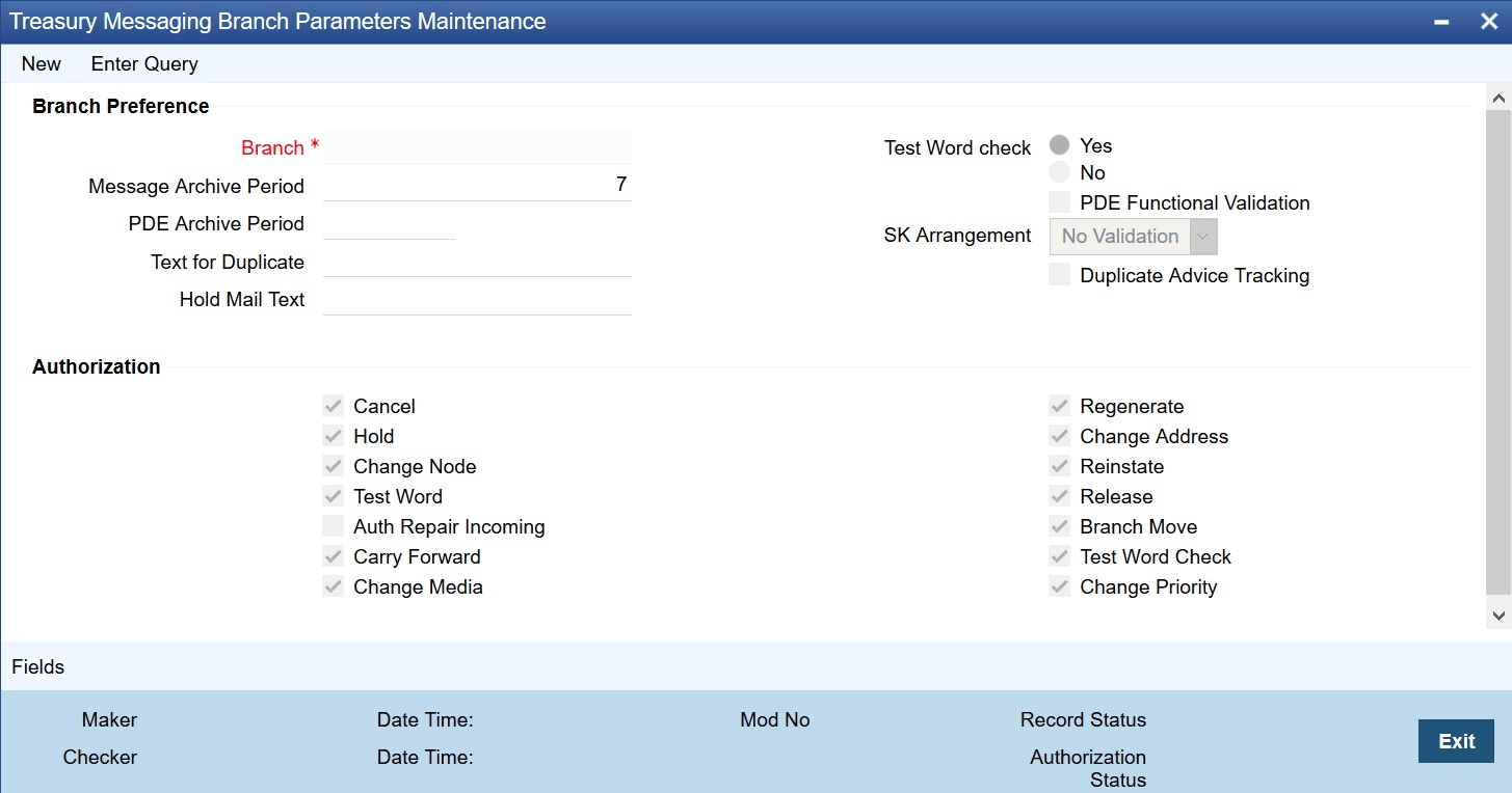

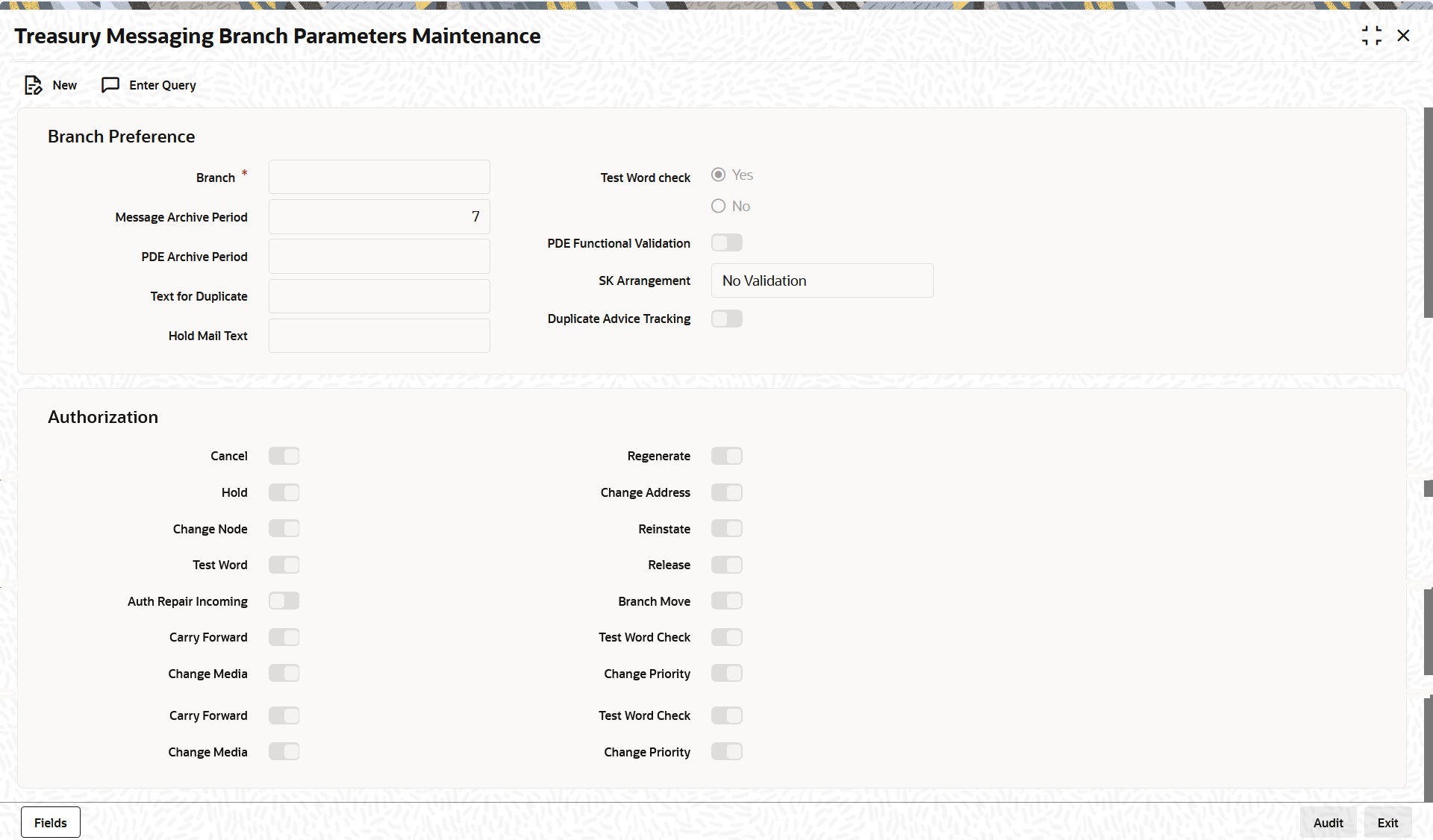

- On Homescreen screen, type MSDTRPREF in the text box, and click next.Treasury Messaging Branch Parameters Maintenance screen displays.
Figure 2-1 Treasury Messaging Branch Parameters Maintenance
Description of "Figure 2-1 Treasury Messaging Branch Parameters Maintenance" - To maintain preferences for a new branch, click the New button on the application toolbar.
- On Treasury Messaging Branch Parameters Maintenance screen, specify the details.
Table 2-1 Treasury Messaging Branch Parameters Maintenance - Field Description
Field Description Branch Specify the branch for which the preferences are to be maintained. Message Archive Period Archival is the process of storing old messages for future retrieval. Specify the number of days for which an outgoing message should be kept in the Outgoing Message Browser. A message will be automatically archived after the number of days that are specified. The details of outgoing message that has been archived can be un-archive through the Message History Retrieval Summary screen. Then these un-archive messages can be processed as any other outgoing message. Note:It is recommended to enter a value of 1 in this field. In this case, only those messages that have been triggered for the generation today will be displayed in the Outgoing Message Browser.
