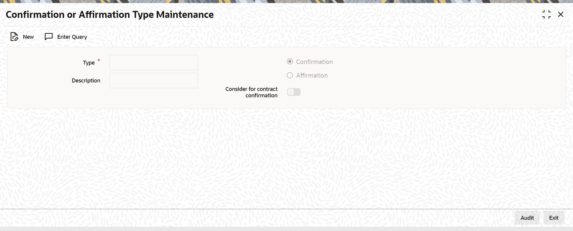

Flag ‘Consider for contract confirmation’ flag is applicable for only Affirmation type of maintenance.
If this flag is checked for an affirmation type and when an affirmation is done for the contract with this affirmation type, then the contract is considered as ‘Confirmed’.
If this flag is unchecked for an affirmation type and an affirmation is done for the contract with this affirmation type, then the contract is considered as ‘Un -Confirmed’.
