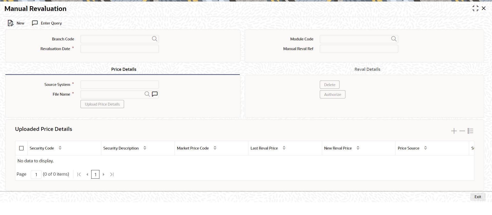

- On Home page, specify SEDXMRTU in the text-box, and click next arrow.
Manual Revaluation screen is displayed.
- On the Manual Revaluation screen, specify the details as required.
Click a new icon from the toolbar. The screen is displayed with no value in the fields. To view details of records previously maintained, call on the Summary View screen. The details of all the records maintained is displayed in a tabular format. Highlight the record of your choice and double click it.
For more information on these fields, refer to the below table.
Table 25-1 Manual Revaluation- Field Description
Field Description Branch Code
The system displays the branch code for which you need to perform the adhoc back dated revaluation MTM processing.
Module code
The system displays the module that supports the back dated revaluation MTM processing.
Revaluation Date
Specify the revaluation date as a past date.
If the date specified is beyond the number of days allowed at the branch parameter level, then there will be no records displayed in the Uploaded Price Details section
Manual Reval Ref
The system displays a unique reference number generated for each price upload.
Source System
Specify the source from which the system gets the price details.
File Name
Specify the name of the file which is to be uploaded.
Security code
The system displays the security code or instrument for which the back dated revaluation is to be processed.
Market Price Code
The system displays the market price code maintained at the instrument definition level.
Last Reval Price
The system displays the old market price or price maintained at the price maintenance level.
New Reval Price
The system displays the price updated in the upload market price file.
Price source
The system displays the source from where the price is published/uploaded.
Status Description
The system displays the status of the file that is uploaded.
- Click the Upload Price Details button. The system displays the details.
If the back dated revaluation is not required, then you can delete a specific security price details record by clicking ‘Delete’ button. You can also select the multiple records at a time and delete it.
If you are ready to update the new reval price to perform the back dated revaluation, then click on the Authorize button to authorize.

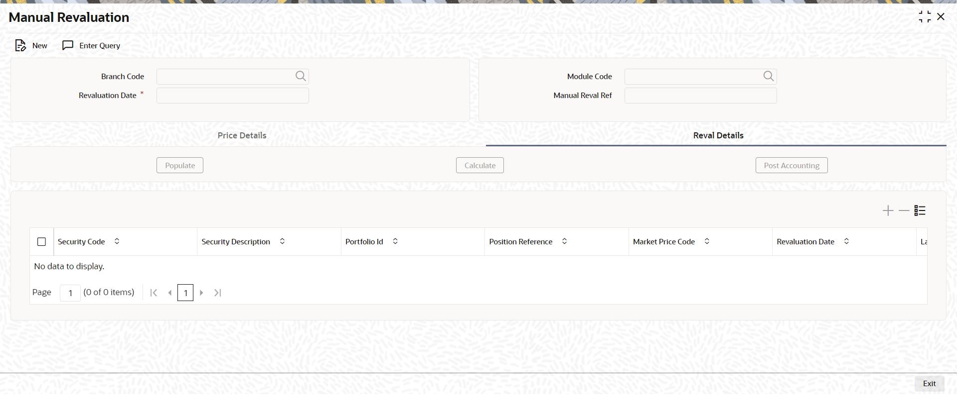

- On the Manual Revaluation screen, click Reval Details.
Manual revaluation- Reval details is displayed.
Figure 25-2 Manual revaluation- Reval details
Description of the illustration sedxmrtu_reval_details_tab.jpg - On the Reval Details tab, click the Populate button. The system displays the details required.
Table 25-2 Reval Tab - Field Descriptions
Field Description Security code
Portfolio Code
Bank Portfolio where the position level revaluation entries are passed.
Position Reference
Bank Leg Reference number in SE Deal Screen.
Market Price Code
Revaluation Date
The system displays the revaluation date.
Last Reval Price
New Reval Price
Price Quotation
The system displays the absolute price citation.
Interest Quotation
The system displays the interest quoted.
Revaluation Level
The system displays the revaluation level which was configured at the branch parameter and portfolio level.
Unsettled Revaluation
The system displays the revaluation option setup at the portfolio preference, which level of position the back dated revaluation to be processed.
This field will display Y when Settled and Unsettled Position Revaluation options are enabled at the portfolio preference. This field will display N when Settled Position option is enabled only at the portfolio preference.
Face Value
The system displays the price at which the bond is issued at the security definition level.
Quantity
The system displays the number of bonds purchased at SE deal.
Book Value
The system displays the value/price at which the deal is purchased.
Market value
The system displays the new price/value for which the deal quantity is calculated.
On clicking the ‘Calculate’ button, the system calculates and updates the revaluation details for the new market price
Last Revaluation PL
The system displays the revaluation (per unit) posted for the old market price value. Negative sign will be indicated if the Revaluation is in loss.
Revaluation PL
The system displays the new Revaluation (per unit) value calculated with the new market price.
Reval Profit
If the back dated revaluation processing is on profit side, then the profit amount/value is displayed in this field. The old Profit value calculated for old price is overwritten.
Reval Loss
If the back dated revaluation processing is on loss side, then the loss amount/value is displayed in this field. The old Profit value calculated for old price is overwritten.
Reval Change
The system displays the difference of book value and the new market value.
MTM Income
If the revaluation is in profit side, the income GL is credited.
MTM Expense
If the revaluation is in Loss side, the expense GL is debited
