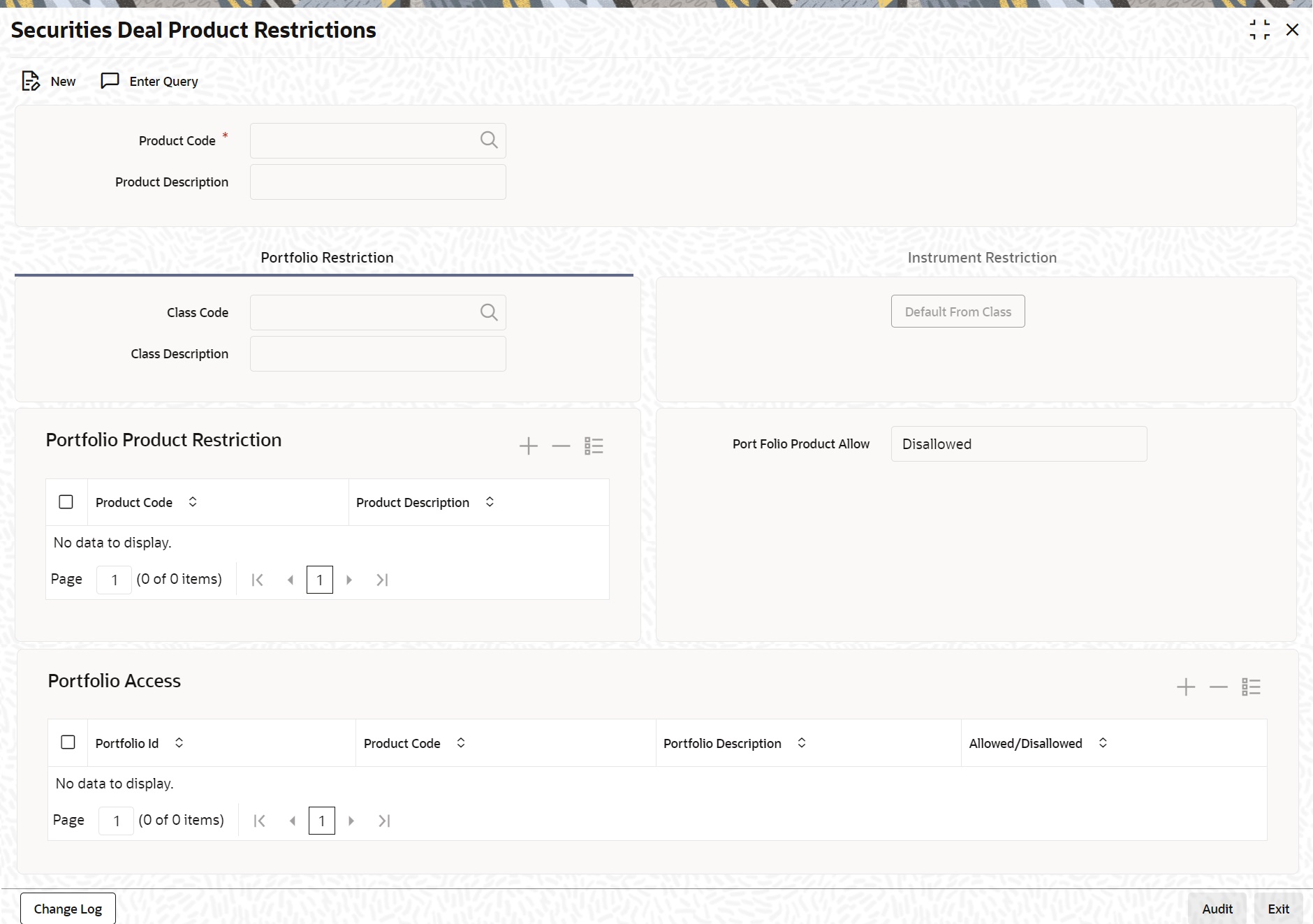

- On the Home page, specify SEDPRDRS in the text box, and click next arrow.
Securities Deal Product Restriction screen is displayed.
Figure 16-2 Securities Deal Product Restriction
Description of the illustration sedprdrs__cvs_main.jpg - On the Securities Deal Product Restriction screen, specify the fields.
For more information on fields, refer to the below table.
Table 16-5 Security Deal Product Restriction - Field Description
