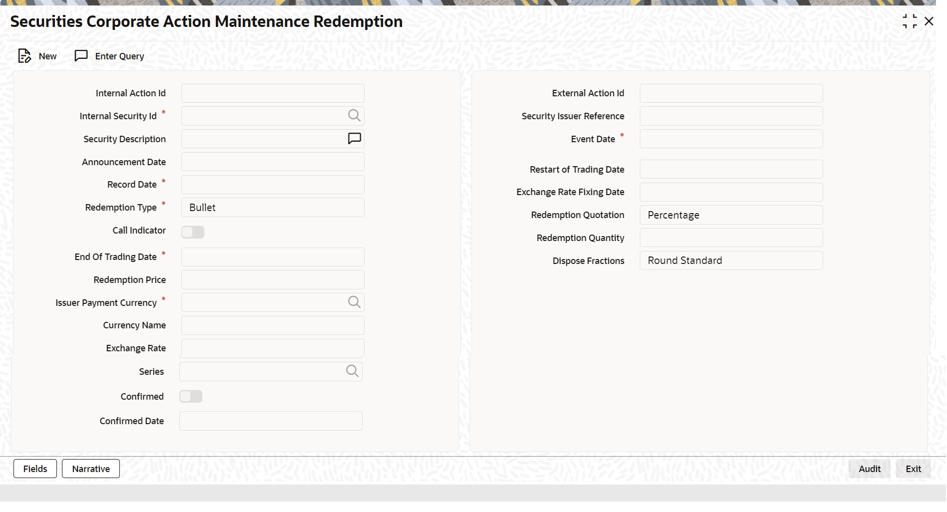

- On the Home page, specify SEDXREDF in the text box, and click next arrow.
Securities Corporate Action Maintenance Redemption screen is displayed.
Figure 19-4 Securities Corporate Action Maintenance Redemption
Description of "Figure 19-4 Securities Corporate Action Maintenance Redemption" - On the Securities Corporate Action Maintenance Redemption screen, specify the fields.
If you are defining details of new redeemable security, click new icon from the toolbar. The Corporate Action Maintenance Redemption detailed screen will be displayed, without any details. If you are calling a redeemable security record that has already been created, click on the Summary view. The details of existing records will be displayed in a tabular form. From the Summary, the screen chooses an existing record to open it.

Field Description Redemption Type
The Redemption type for security will default as defined at the Security Instrument. While defining redeemable securities you can specify the method in which the security is to be redeemed. You can indicate whether the redemption type is to be Bullet, Quantity or Series.
In a bullet type of redemption, all the holdings in the security will be redeemed on maturity. For quantity redemption, the nominal held in the security is redeemed by a specific percentage on a date different from the maturity date.
While redeeming the security either the face value of the security or the number of units held in the security will be reduced by the percentage you specify. In a series type of redemption, the holdings in the specified security pertaining to the specified list will be redeemed on a date other than the maturity date.
