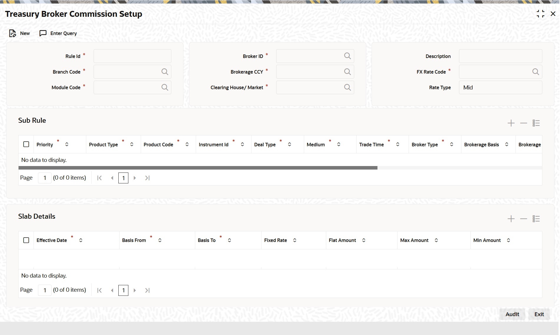

  1. On the Home page, type TRDBKRUL in the text box, and then click next arrow.
    The Treasury Broker Commission Setup screen is displayed.
    Figure 1-7 Treasury Broker Commission Setup
    Description of Figure 1-7 follows
    Description of "Figure 1-7 Treasury Broker Commission Setup"
  2. On the Treasury Broker Commission Setup screen, click New.
  3. On the Treasury Broker Commission Setup screen, specify the field details and then click Enter Query.
