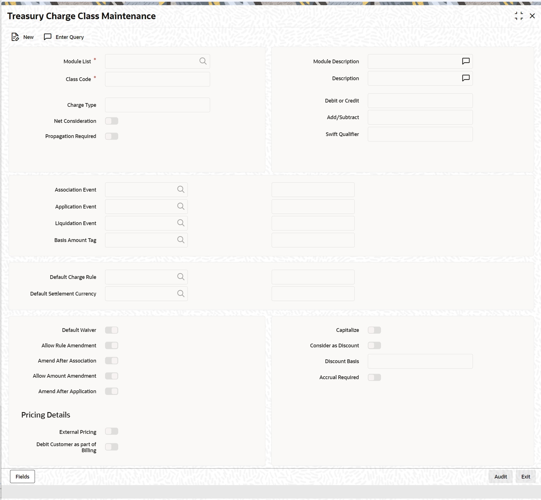

  1. On the Homepage, enter CFDTRCCM in the text field and then click the next arrow.
    The Treasury Charge Class Maintenance screen is displayed.
    Figure 1-6 Treasury Charge Class Maintenance
    Description of Figure 1-6 follows
    Description of "Figure 1-6 Treasury Charge Class Maintenance"
  2. On the Treasury Charge Class Definition screen, specify the fields.
    For field details and description, refer to the below table.
