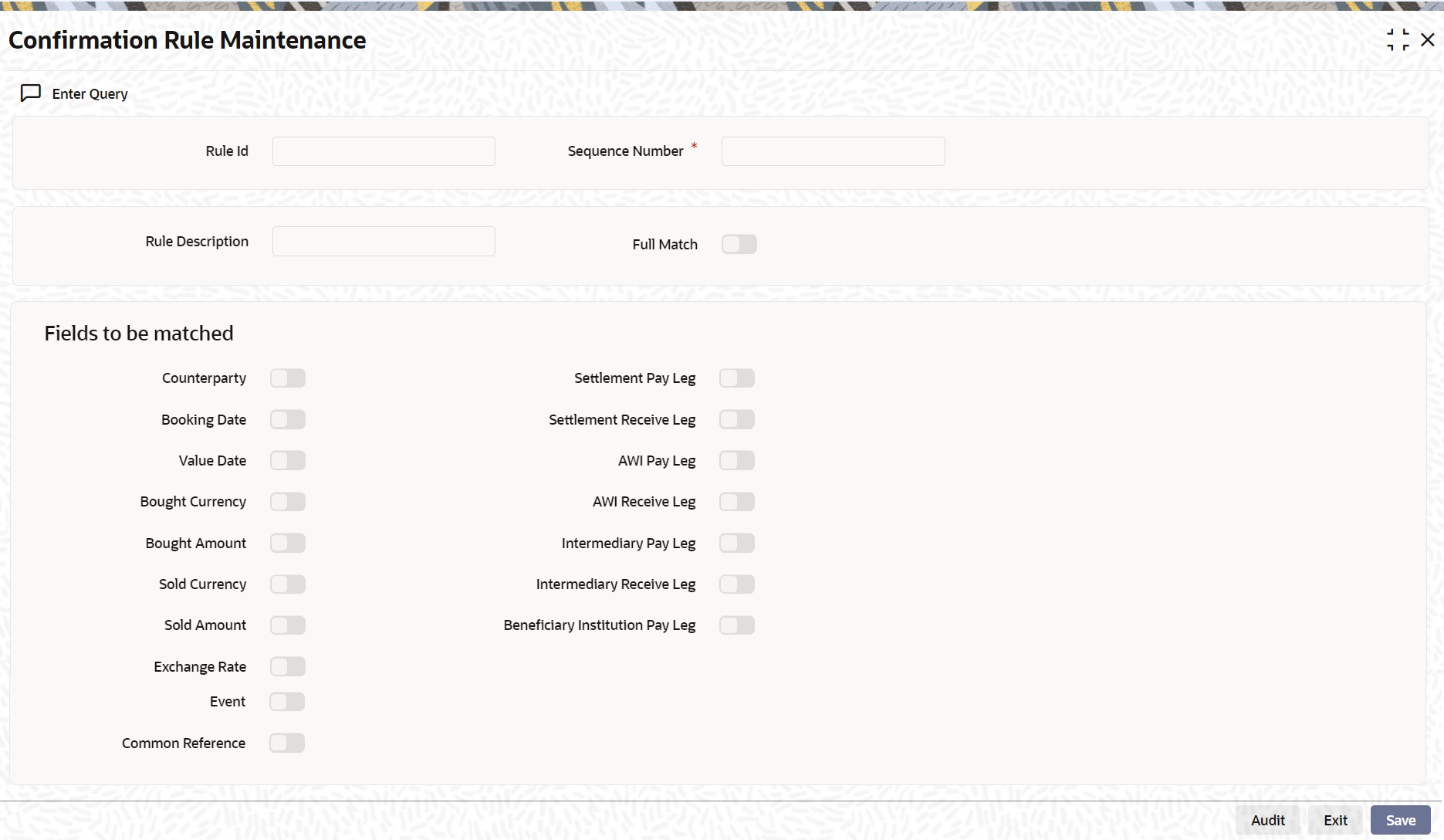

The system automatically matches the Incoming FX confirmation messages based on confirmation rules maintained. You can maintain the confirmation rules using Confirmation Rule Maintenance screen.
- On the Home page, type FXDCNFMT in the text box, and click next arrow.
The Confirmation Rule Maintenance screen is displayed.
- On the Confirmation Rule Maintenance screen, specify the details as required.
- Click Ok to save the details or Cancel to close the screen.
For information about the fields, refer to the below table.

Field Description Rule Id
Specify the unique ID for a rule.
Rule Description
Specify the description for the specified rule ID.
Sequence Number
The system displays the sequence number. You can modify this. If there are multiple Rules, the processing for auto matching the messages will happen based on the sequence number in an ascending order.
Full Match
Check this box if the confirmation rule maintained is a Full Match Rule. It is mandatory to check all the above fields except the below-mentioned fields if the maintained rule is to as ‘Full Match’:
Event
Settlement for Receive Leg
Settlement for Pay Leg
AWI for Receive Leg
AWI for Pay Leg
Intermediary Receive Leg
Intermediary Pay Leg
Beneficiary Institution Pay Leg
Common Reference
You can maintain more than one rule as full match
The system verifies the message details with the contract details based on the confirmation rules maintained. If single contract details match with message details for a ‘Full match’ rule, then the message is marked as completely matched, and the contract is marked as confirmed.
