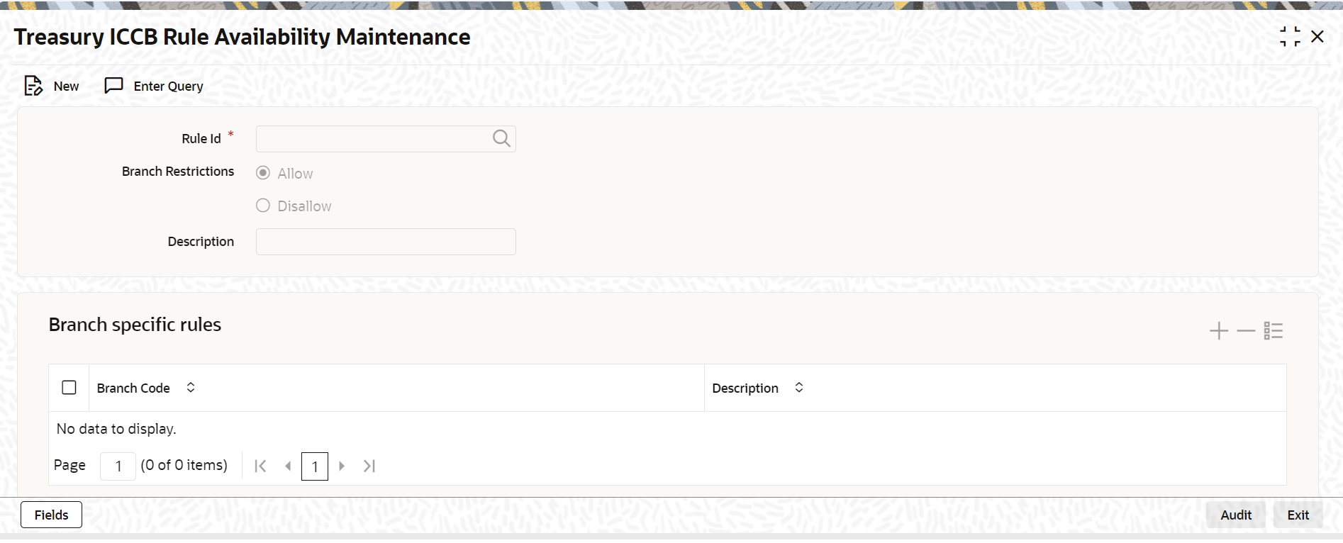

  1. On the Homepage, enter CFDTRRLA in the text field and then click the next arrow.
    The system displays the Treasury ICCB Rule Maintenance screen.
    Figure 1-4 Treasury ICCB Rule Maintenance
    Description of Figure 1-4 follows
    Description of "Figure 1-4 Treasury ICCB Rule Maintenance"
  2. Specify the fields in the displayed screen.
    Table 1-4 Treasury ICCB Rule Maintenance - Field Description
    Field Description
    Rule Identification and Description
    You must specify a unique identification for the ICCB rule you are creating. If you are creating a charge rule, specify a unique identification for the interest rule. This is the code that will be used to identify the rule, in all subsequent references to it. You must also specify a unique description for the rule.
    After the rule has been created in the Treasury ICCB Rule Branch Availability screen, the attributes for the rule must be defined in the Treasury ICCB Rule Details screen.
    Branch Restrictions
    You can maintain a list of allowed branches (that is, the rule will be available for use in the allowed list of branches) or disallowed branches (the rule will not be available for use in the branches in the disallowed list).
    To recall, the attributes for the rule are defined, in the ‘Treasury ICCB Rule Details’ screen. Maintaining the attributes in this screen, for a branch, is subject to whether maintenance of ICCB rules is allowed for the branch, and also whether the rule for which attributes are being defined, is allowed for the branch.
    For details about the Common Branch Restrictions, refer the Security Management System user manual. For example, you have created the following Common Branch Restrictions:
    Table 1-5 Common Branch Restrictions
    Home Branch Restriction Type Allowed Branches
    000 ICCBRULE 000, 001, 002, 005
    001 ICCBRULE 001, 006
    The administrator of branch 000 can create, modify and delete ICCB rules in the branches 000, 001, 002 and 005, but not for 006.
