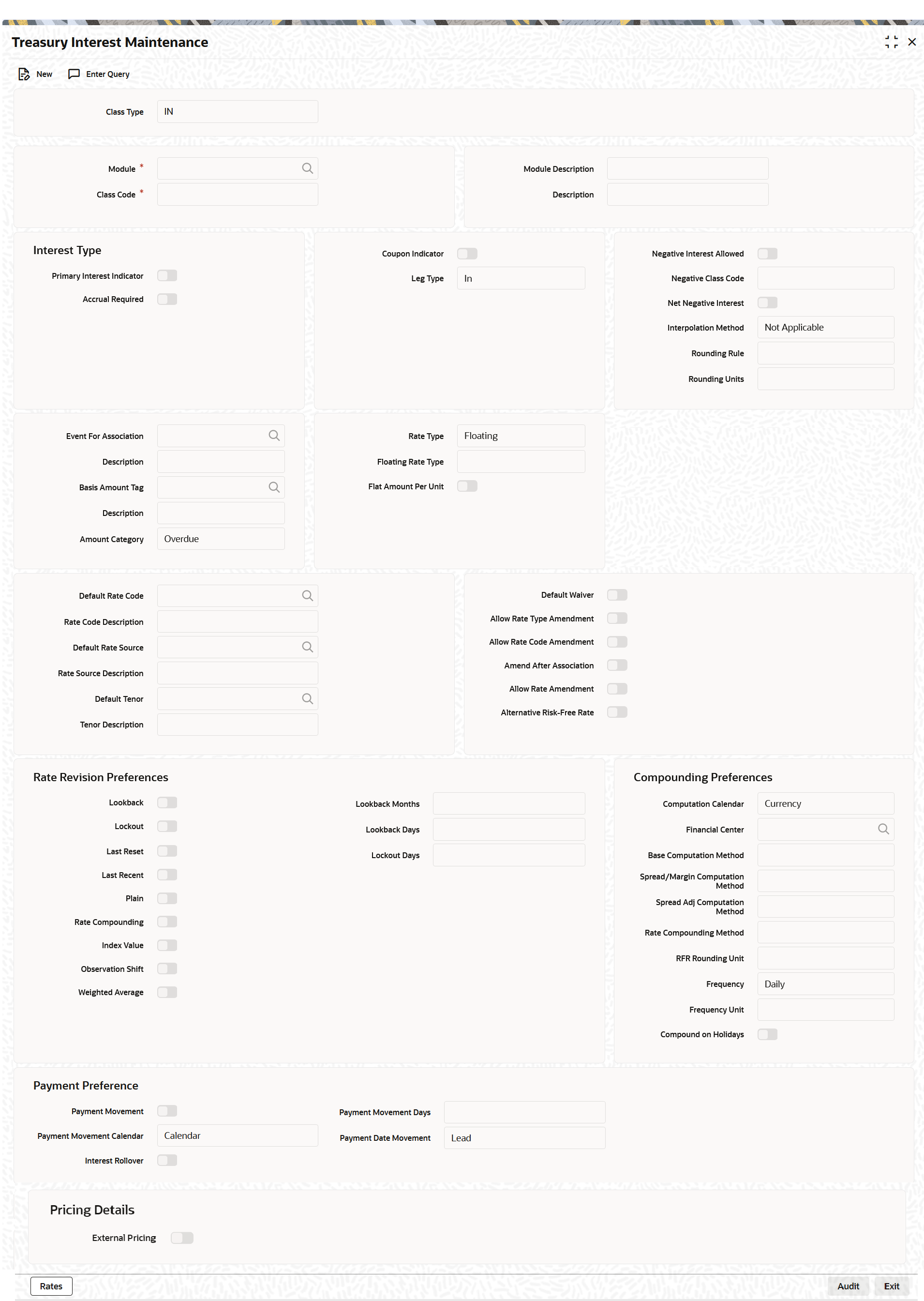

- On the Homepage, enter CFDTRINT in the text field and
then click the next arrow.The Treasury Interest Maintenance screen is displayed.
- On the Treasury Interest Maintenance screen, specify the
fields.For field details and description, refer to the below table.
Table 1-11 Treasury Interest Maintenance
Field Description Module An interest class is built for use in a specific module. This is because; an interest component would be applied on different basis amounts, in different modules.
Note: The Basis Amount Tags available would depend on the module for which you build the class.
