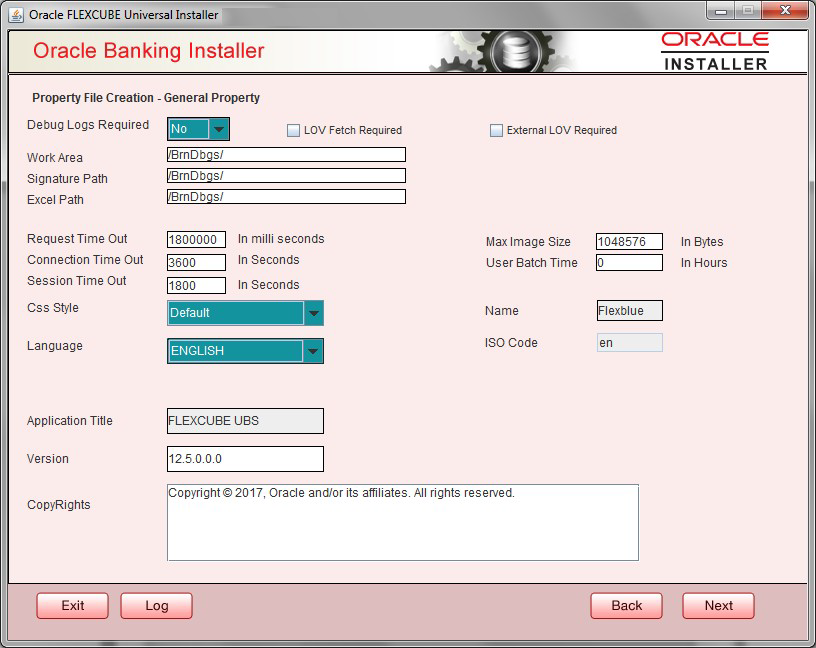

1.3 Setting General Properties
This topic describes the process of setting common properties of Oracle Banking Treasury Manangement.
The installer displays the General Property screen.
You can specify the following details in this screen:
Table 1-2 General Property
Field Description
Debug Logs Required If debug option is required, select Yes from the drop-down list. If not required, select No. By default the value is No.

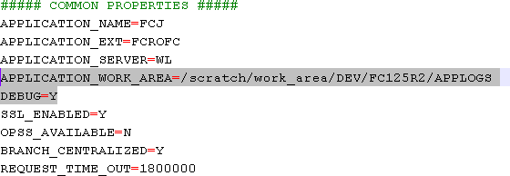

Parameter APPLICATION_WORK_AREA in fcubs.properties is updated to Work Area path provided during installation.
Parameter DEBUG is updated based on Debug Logs Required selection.
To log debug for the user, following should be available.
  • In Day 0 Setup CSTB_PARAM table is appended with parameter name WORK_AREA and path provided for debug logs.
  • CSTB_DEBUG table should have entries for required modules.
  • Corresponding user entries should be input in CSTB_DEBUG_USERS.
Example: If SM module log is enabled for the user, then there should be an entry in cstb_debug_users.
Table: CSTB_DEBUG_USERS (User Level) CSTB DEBUG USERS
Table: CSTB_DEBUG (Bank Level)CSTB DEBUG
All the configuration is done using back-end scripts, which can be executed by Data Controller.
Snapshot of fcubs.properties is displayed below:FCUBS Properties
Change Logs can be visited to view audit information.
LOV Fetch Required If you select this check box, the option lists displays the matching values based on the first characters that you enter in a field. If you specify the first three characters of a value to be entered in an option list and tab out, the system displays the complete list of values that are matching the first three characters.
If you do not select this, option lists does not show the matching values based on the first few characters. You need to specify the complete value against the field.
External LOV Required If you select this check box, External Lov option for external Limits is enabled.
Work Area Specify the work area.
For example: D:\BrnDbgs\
Signature Path Specify the location at which the signature images should be placed.
Excel Path Specify the location at which the excel files should be generated.
Request Time Out Specify the database request timeout value in milli seconds. This is the maximum number of seconds the database waits for a query to return the result.By default it is 1800000 milli seconds.
Connection Time Out Specify the database connection timeout value in seconds. This is the maximum number of seconds the application waits for a connection to the database to open.
Session Time Out Enter the session time out value in seconds. This is the maximum number of seconds during which the application gets active without any user intervention. If there is no user intervention continuously for the duration specified here, the user session gets expire.
Max Image Size Specifies the maximum image size that can be uploaded. The default size is 1048576 bytes.
CSS Style Specify the CSS style to be used from the adjoining drop down list. You can select one of the following CSS styles:
  • Default – select this to apply the default style provided.
  • Custom – select this to apply a custom style
Name Specify the name of the CSS style.
Once you have specified the above details, click Next.
Language Specify the language in which you wish to see in the application. English is the default language. However, based on the requirement, you can set a different language. Select the appropriate one from the drop-down list.
Based on the language selected, the installer displays the ISO code.
Application Title Specify the application title. C
Version Specify the application version.
For example: 14.0.0.0.0
CopyRights Specify the copyright details.
Integration With ODA ChatBot Select this check box to enable ODA ChatBot. ODA ChatBot setup details are available in ChatBot guide document.
