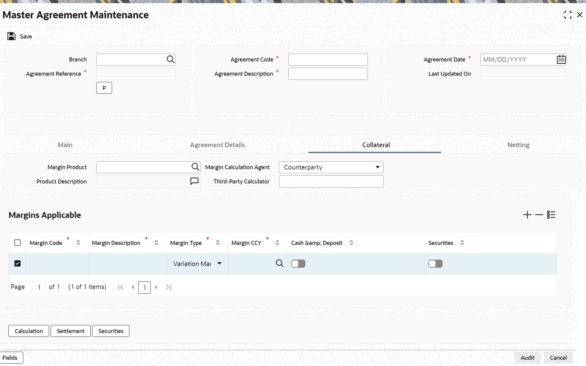

Click the Collateral tab in the Master Agreement Maintenance screen to open this screen.
Figure 2-22 Master Agreement Maintenance - Collateral
Description of Figure 2-22 follows
Description of "Figure 2-22 Master Agreement Maintenance - Collateral"
