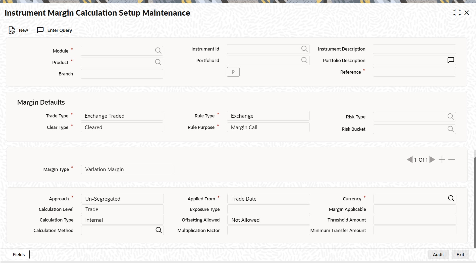

2.5.1 Instrument Margin Calculation Maintenance Screen
- On the Homepage, type ENDINMRG in the text box, and click the next arrow.
Instrument Margin Calculation Maintenance screen is displayed.
Figure 2-3 Instrument Margin Calculation Setup Maintenance
Description of "Figure 2-3 Instrument Margin Calculation Setup Maintenance" - On the Instrument Margin Calculation Maintenance screen, Click New.
- On the Instrument Margin Calculation Maintenance - New screen, Specify the details as required.
- Click Save to save the details or Cancel to close the screen.
For information on fields, refer table below:
*indicates mandatory fields.

Multiplication Factor
Specify the multiplication factor (if applicable) to be used for arriving at the adjusted exposure considered for margin calculation purposes for this margin type.
- This field is disabled and not applicable, if Margin Type selected is ‘Variation Margin’ or if Calculation Method selected is ‘Flat Amount’
- Factor may depend on many parameters like the risk type of the exposure, etc.
- Adjusted Exposure = Net Exposure (after offsetting) * Multiplication Factor
- Example: For a Long 1,000,000 and Short 700,000 with offsetting allowed, with multiplication factor 0.65, Adjusted Exposure = 300,000 * 0.65 = 195,000
- ‘1’ is set by default, if not specified
Currency
Specify the currency in which the margin required is calculated for this margin type.
- This field is mandatory if Calculation Level selected is ‘Portfolio / Product’
- This field is set to Contract Currency ‘CCY’ by default, if Calculation Level selected is ‘Trade’
- Exposure in different currencies are converted to the margin currency equivalent for arriving at the final exposure for margin calculation purposes
Margin Applicable
Specify the applicable margin as flat amount or % of the final exposure to calculate the margin required for this margin type.
- This field is disabled and not applicable, if Margin Type selected is ‘Variation Margin’ or if Calculation Type selected is ‘External’
- If Calculation Method selected is ‘Standard Rate(%)’, then Margin Required = Adjusted Exposure * Margin Applicable /100
- Example: If Adjusted Exposure = 115,000 and with margin applicable = 35%, Margin Required = 115,000 * 35/100 = 40,250
- If Calculation Method selected is ‘Flat Amount’, then Margin Required = Margin Applicable
- Example: If Margin Applicable = 35,000, Margin Required = 35,000
- if not specified, ‘0’ is set by default resulting in no margin required
Threshold Amount
Specify the maximum amount that can be excluded from the margin required before margin call should be mandatorily triggered for this margin type.
- This field is disabled and not applicable, if Margin Type selected is ‘Variation Margin’ or if Calculation Method selected is ‘Flat Amount’ or if Calculation Type selected is ‘External’
- Margin Calculated = Maximum(0, (Margin Required – Threshold Amount))
- Example: If Margin Required = 40,250 and threshold = 25,000 then Margin Calculated = Max(0, (40,250 – 25,000)) = 15,250
- If not specified, ‘0’ is set by default resulting in margin required to be fully transferred without any exclusion
Minimum Transfer amount
Specify the minimum amount that should be transferred for each margin call for this margin type, even if the calculated margin amount is lesser.
- Margin Transferred = Maximum(Margin Calculated, Minimum Transfer Amount)
- Example: If Margin Calculated = 15,250 and MTA = 20,000, Margin Transferred = MAX(15,250, 20,000) = 20,000
- if not specified, 0 will be set by default and full amount calculated as margin need to be transferred.
On click of P button, after selecting the values for mandatory fields, system automatically generates a unique ‘Reference’ for the calculation setup.
