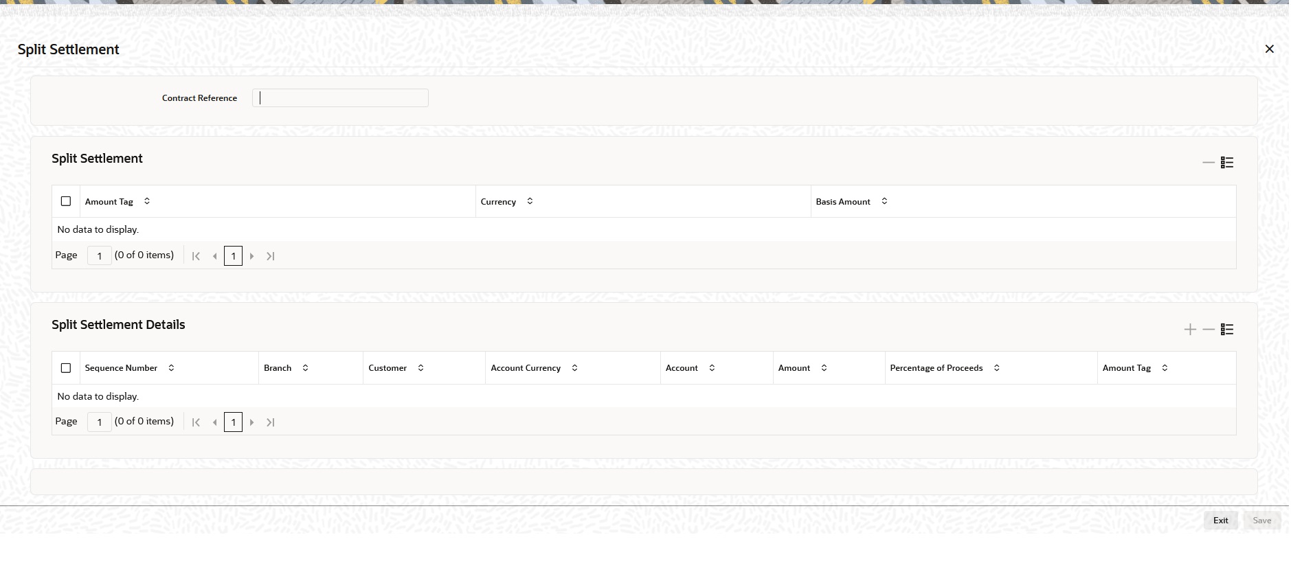

- On the Money Market Contract Input screen, click
Split.
Split Settlement screen is displayed.
- From the displayed list, select a contract.
- On the Split Settlement screen, under the Split Settlement Details, click the Plus symbol.
A new row is added under Split Settlement Details as shown in below.
Figure 3-13 Split Settlement with a new row added
Description of "Figure 3-13 Split Settlement with a new row added"Note:
