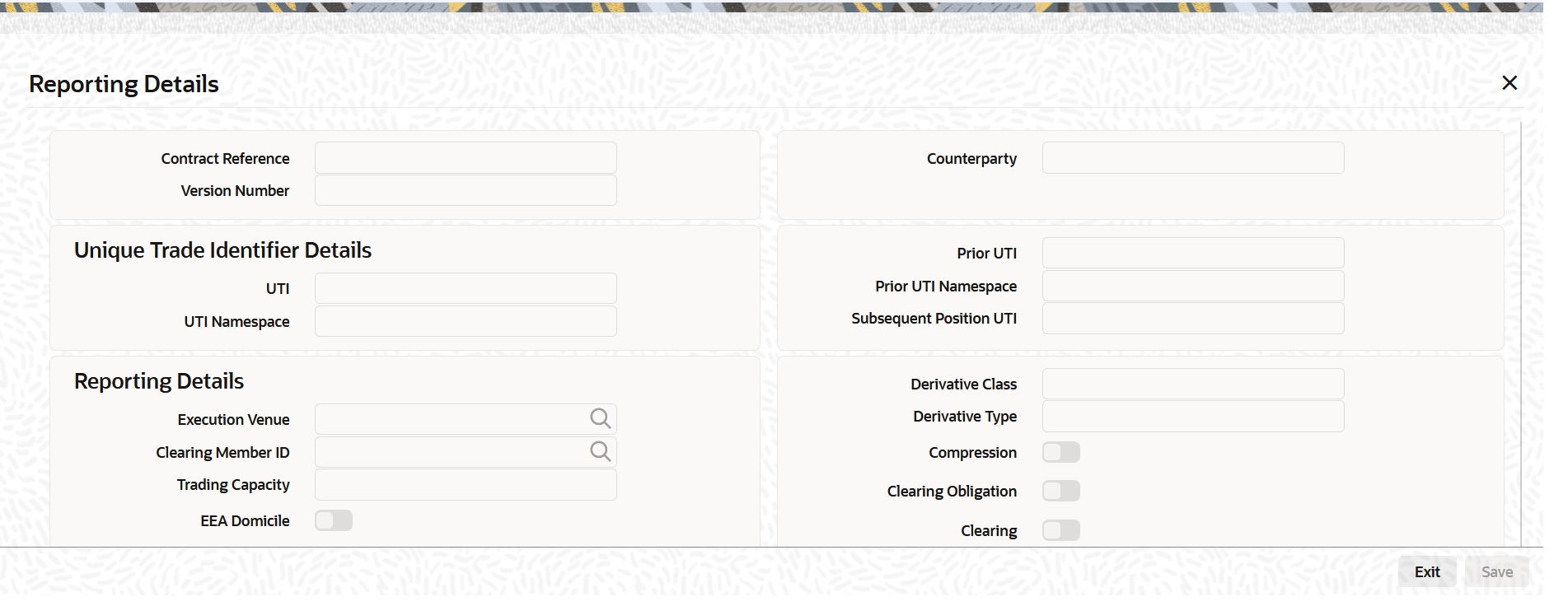

4.1.1.1 Reporting Details Maintenance
- On the Contract Input screen, click the Reporting Details tab.
The Reporting Details screen is displayed.
- On the Reporting Details screen, specify the details as required, and click Ok.For more information on the fields, refer to the below table.
Table 4-24 European Market Infrastructure Regulation - Field Descriptions
Field Description Contract Reference
Indicates contract reference number specified during report generation
Version Number
Indicates the latest version number of the report. The system assigns a version number to a contract whenever it is created in the system. From then, each amendment and reinstatement results in the next version of the contract being created. When a report is generated, the latest version number of the contact is reported
Unique Trade Identifier Details
Specify the Unique Trade Identifier Details.
UTI
Specify the Unique Transaction Identifier (UTI) in combination with the namespace created at the time of transaction is first executed. The UTI is shared with all registered entities and counterparties involved in the transaction, and used to track that particular transaction over its life.
UTI Namespace
Specify the unique code that identifies the registered entity creating the unique transaction identifier.
Prior UTI
Specify the previous unique transaction identifier in combination with the namespace that was created at the time of transaction execution.
Prior UTI Namespace
Specify the registered entity that created the previous unique transaction identifier at the time of transaction execution.
Subsequent Position UTI
Specify the UTI of the position in which a derivative is included.
Note: This field is applicable only for the reports related to the termination of a derivative due to its inclusion in a position.
Execution Venue
Select the execution venue from the available list of values.
Note: The execution venue is maintained manually in the Treasury Static Type maintenance screen by mapping Type as EX_Venue and Type Name as the Market Identifier Code (MIC). The execution venue maintained in this screen will be available to fetch from the execution venue list of values.
Clearing Member ID
Select the unique code from the displayed list for identifying the responsible clearing member ID of the reporting counterparty.
Trading Capacity
Select the Trading Capacity from the drop-down list:
- Principal
- Agent
Indicates whether the reporting counterparty has concluded the contract as principal on its account or as an agent for the account on behalf of a client.
EEA Domicile
Select the EEA Domicile check box, if the other counterparty is domiciled in the European Economic Area (EEA)
Treasury Financing
Select the Treasury Financing check box, if the contract is objectively measurable as directly linked to the reporting counterparty’s commercial or treasury financing activity, as referred to in Art. 10(3) of Regulation (EU) No 648/2012. Indicates whether the contract is objectively measurable as directly linked to the reporting counterparty’s commercial or treasury financing activity, as referred in Art. 10(3) of Regulation (EU) No 648/2012.
Clearing Threshold
Select Clearing Threshold from the drop-down list. The available options are:- Above
- Below
Collateralized
Select the Collateralized value from the drop-down list. The drop-down list shows the following options:
- Uncollateralized
- Partially Collateralized
- One way Collateralized
- Fully Collateralized
Collateral Portfolio
Select the Collateral Portfolio check box, if the collateralization was performed on a portfolio basis.
Indicates whether the collateralization was performed on a portfolio basis. A portfolio means the collateral is calculated based on net positions resulting from a set of contracts, rather than per trade.
Collateral Portfolio Code
Click the search icon and select the unique code of the Collateral Portfolio in this field.
Note: If the collateral is reported on a portfolio basis, the portfolio should be identified by a unique code determined by the reporting counterparty.
Taxonomy Used
Select the Taxonomy Used for the contract from the drop-down list. The drop-down list shows the following options:
- Product Identifier
- ISIN/ALL
- Interim Taxonomy
ISIN/All
Specify the ISIN/All number, if ISIN/All option is selected in the Taxonomy Used field.
Derivative Class
Select the Derivative Class from the drop-down list, if the Interim Taxonomy option is selected in the Taxonomy Used field.The drop-down list shows the following options:
- Commodity
- Credit
- Currency
- Equity
- Interest Rate
- Others
Derivative Type
Select the Derivative Class from the drop-down list, if the Interim Taxonomy option is selected in the Taxonomy Used field. The drop-down list shows the following options:
- Contract for Difference
- Forward Rate Agreement
- Futures
- Forward
- Options
- Swap
- Others
Compression
Select the Compression check box to indicate whether the contract results from a compression exercise.
Clearing obligation
Select the Clearing obligation check box to indicate whether the reported contract is subject to the clearing obligation under Regulation (EU) No 648/2012.
Clearing
Select the Clearing check box to indicate whether clearing has taken place.
Clearing timestamp
Enter the time and date when clearing took place.
CCP
Click the search icon and select the unique code from the displayed list for identifying the reported contract is subject to the clearing obligation under Regulation (EU) No 648/2012.
Intragroup
Select the Intragroup check box, to Indicate whether the contract was entered into as an intra-group transaction, defined in Article 3 of Regulation (EU) No 648/2012.
Action Type
Select the Action Type from the drop-down list. The available options are:
- New
- Modify
- Error
- Cancel
- Compression
- Valuation Update
- Others
Indicates the action on the contract.
Action Type Details
Specify the details of the amendment, if the previous Action Type field is selected as Others.
Agreement Type
Select the agreement type from the displayed list of values or enter the type of agreement directly in the field.
This field specifies the type of the agreement covering the transaction. The Agreement Type cannot be overwritten, as Master Agreement is maintained, default value from Agreement will be picked.
Reporting Jurisdiction
Select the supervisory party from the displayed list of values. This field specifies the supervisory party to which the trade needs to be reported. If Reporting jurisdiction is selected as OTHR, the Additional Reporting Details are required by the regulator. For more information, refer to Step 6 in section 2.5.1 Settlement details of Settlement User Guide. Reporting Jurisdiction cannot be overwritten as Master Agreement is maintained, default value from Agreement will be picked.
