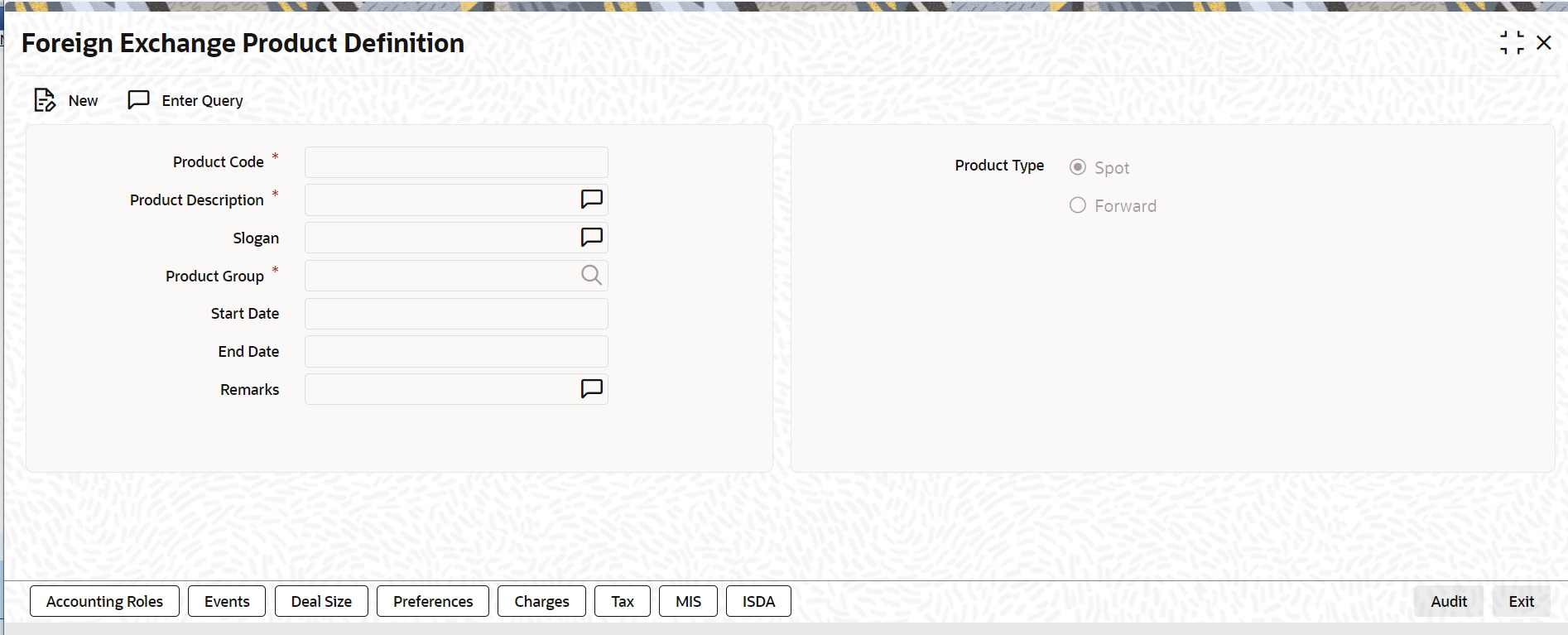

  1. On the Homepage, enter FXDPRMNT in the text field and click Next in the application toolbar.
    The Foreign Exchange Product Definition screen is displayed.
    Figure 1-1 Foreign Exchange Product Definition
    Description of Figure 1-1 follows
    Description of "Figure 1-1 Foreign Exchange Product Definition"
  2. On the Foreign Exchange Product Definition screen, specify the fields.
