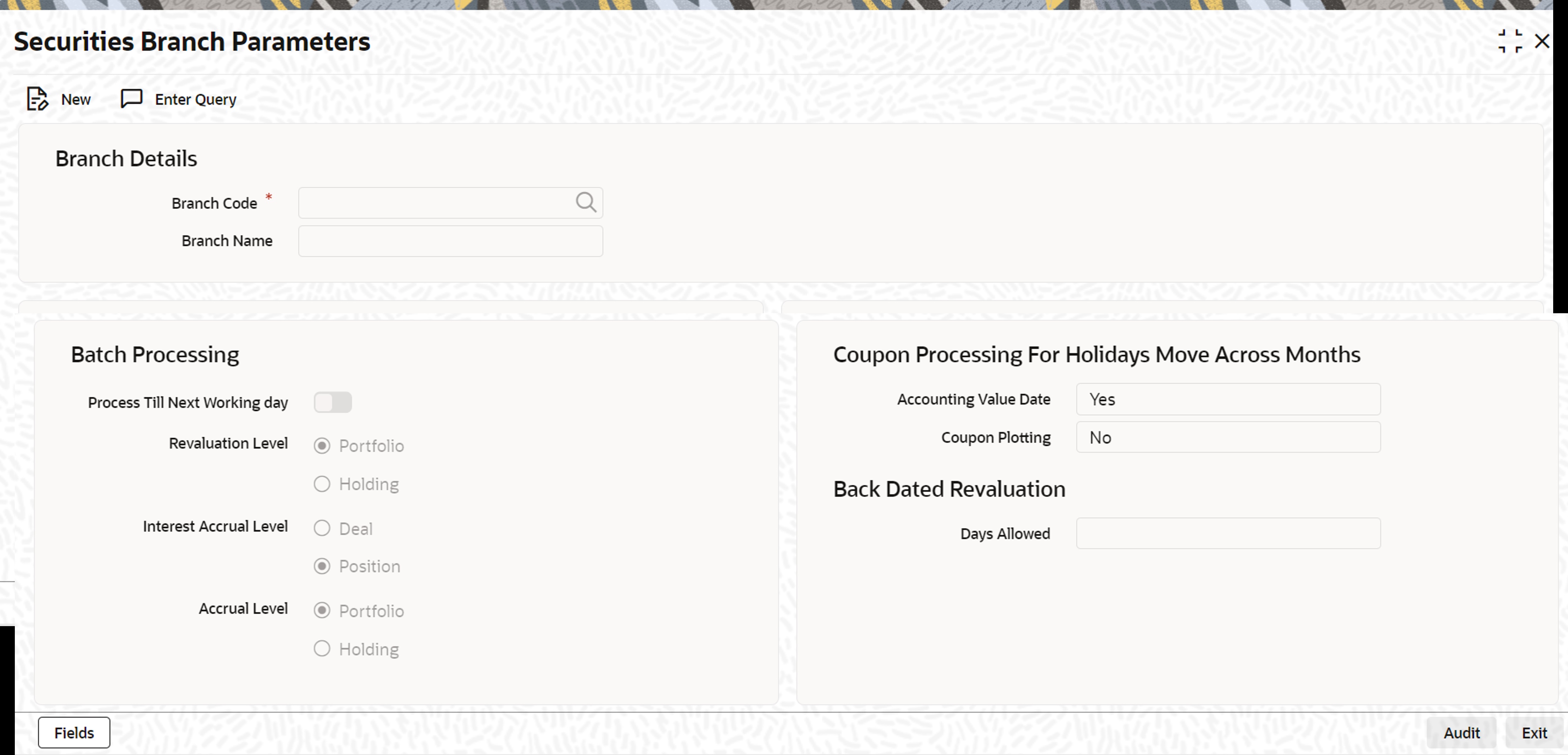

3.5.1 Define Branch Parameters
- On the Home page, specify SEDXBRPM in the text box, and click the arrow next t.
The Securities Branch Parameters screen is displayed.
- On the Securities Branch Parameters screen and specify the fields.
For more information on fields, refer to the below table.
The events, for which you had indicated automatic processing, are triggered off during the Batch Process. You can specify preferences for the automatic events that fall on a holiday, in the Branch Parameters screen.
Table 3-3 Securities Branch Parameters - Field Description
Field Description Batch process Parameter You have the option to specify when the batch process, must process automatic events falling due on a holiday. It could be either:
- As part of the EOD on the last working date before the holiday.
- As part of the BOD process on the next working day after the holiday
Revaluation Level Revaluation entries can be passed at the portfolio level or the holding level.
- Portfolio: At the portfolio level, revaluation entries will be passed for the portfolio and currency combination.
- Holding: At the holdings, level entries will be passed for the net holdings for a portfolio, and security across SK locations and SK location accounts.

Specifying the Accrual level
- Portfolio: At the portfolio level, accruals will be passed for the portfolio and currency combination.
- Holding: At the holdings, level entries will be passed for net holdings of a portfolio and security across SK locations and SK location accounts.
Interest Accrual level
You can opt to accrue interest at a position level or at a deal level.
Position: At the position level, accrual happens for a combination of security and portfolio
Deal Matching: Deal level interest accrual is done for every individual buy deal for the same combination of security and portfolioInterest accrual at deal level is for Bank Portfolios only.

Days Allowed
Specify the number of days allowed for back dated revaluation. This field is required to maintain during creation of branch parameter setup and is not modifiable after authorization of record.
