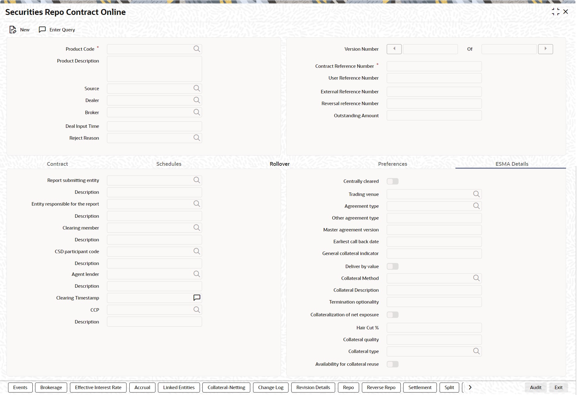

2.7 Capture Details of Repo Contract
This topic describes how to capture details of Repo Contract in the Securities Repo Contract Online.
When the user enters into a repo (or reverse repo) deal, the user must associate it with a product that the user has maintained. By default, a deal inherits all the attributes of the product with which it is associated. Most deal details are captured for the product the deal involves. These details default to the deal. The user can capture the details of repo deals in the Securities Repo – Online screen.

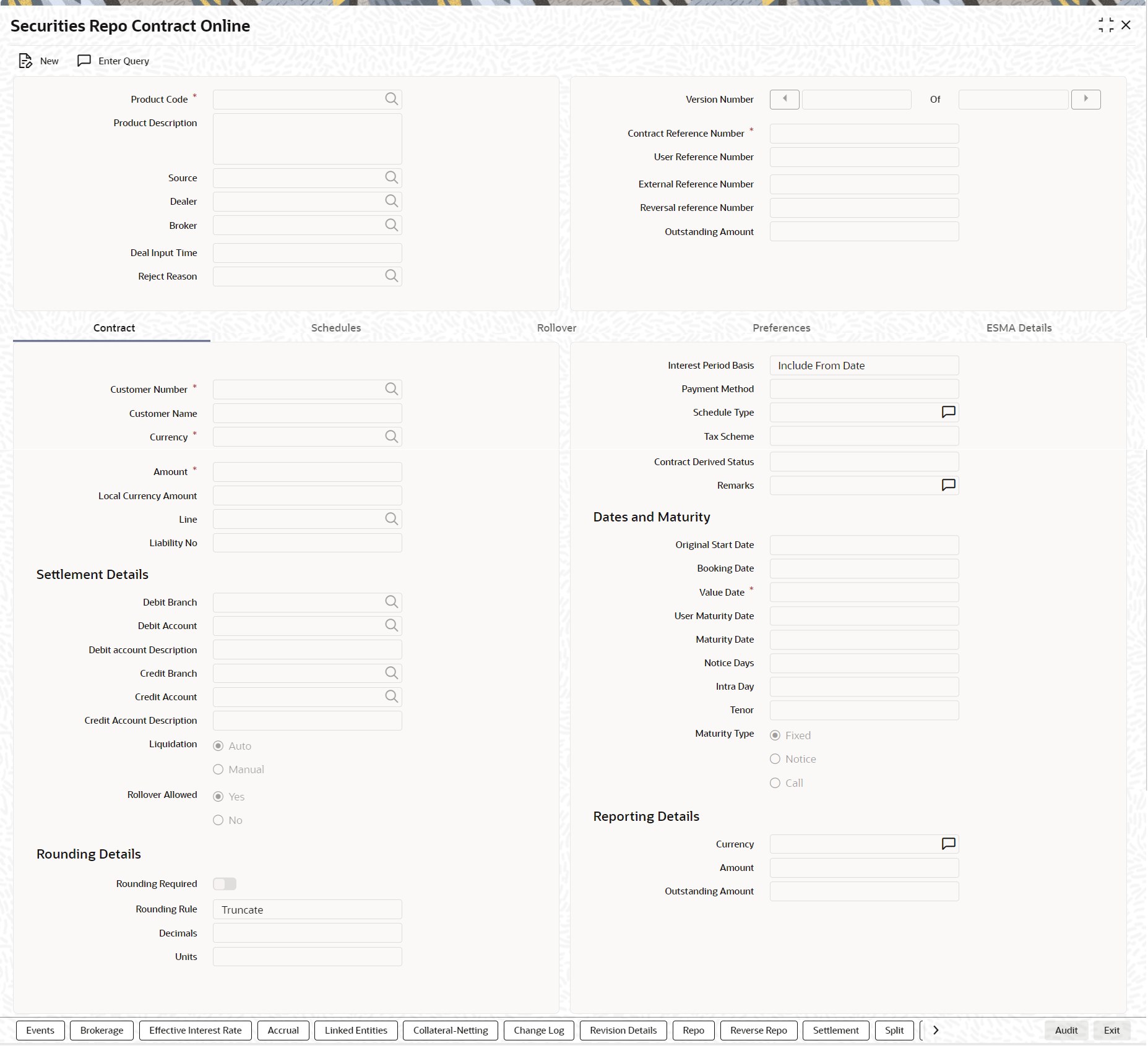

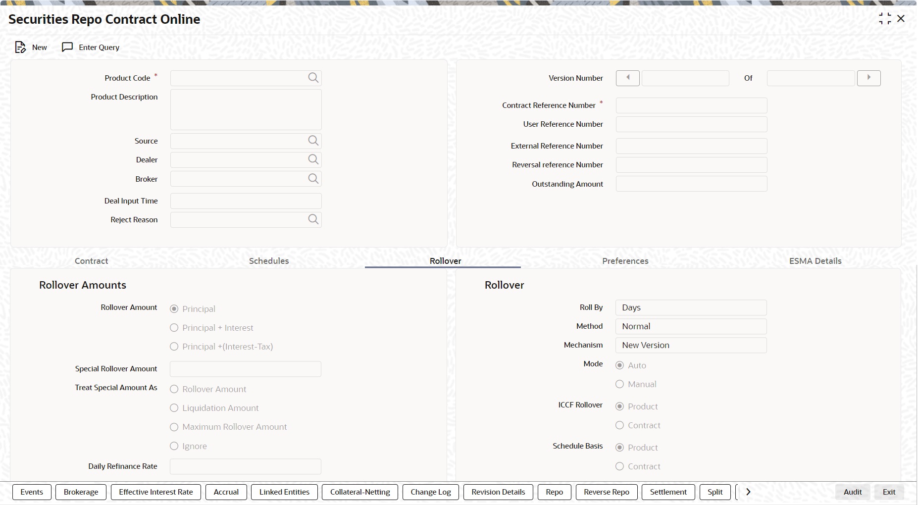

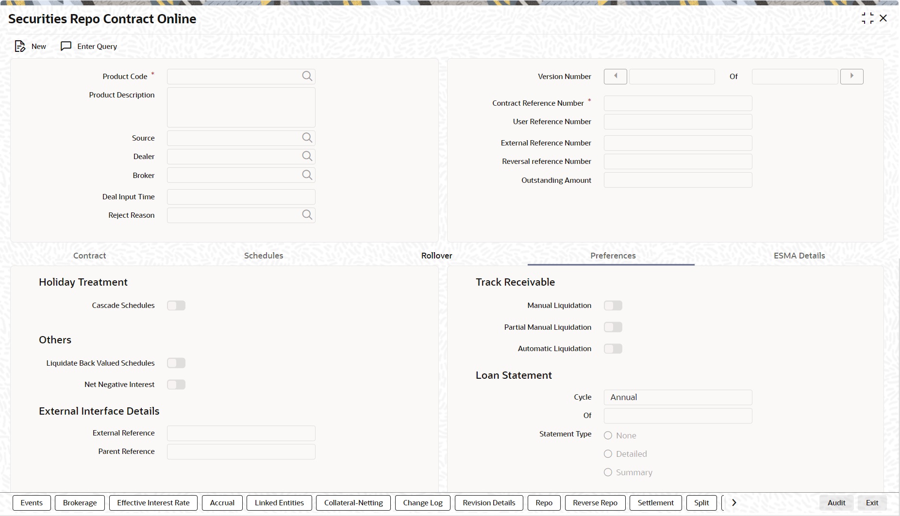

- On the Home page, specify SRDTRONL in the text box, and click next arrow.
The Securities Repo Contract Online screen is displayed.
Figure 2-16 Securities Repo Contract Online
Description of "Figure 2-16 Securities Repo Contract Online" - On the Securities Repo Contract screen, specify the fields.
The base number of the counterparty (customer)
- The currency of the contract
- The principal amount (for a deal with True Discounted interest, the user must enter the nominal).
- Securities pledged detail for repo
- Securities received detail for reverse repo
- The credit line under which the reverse repo has to be tracked
- The tenor related details for the deal
- The code of the broker involved
- The dealer involved
- The default settlement account
- The maturity details
- The interest details
- Whether the deal is rolled over

Table 2-19 Security Repo Contract - Field Description
Field Description Product Code
This is a mandatory field
Click the search icon and select the Product code from the list of options displayed.
Product Description
The description of the selected product code is displayed.
Source
Indicate the source from which contracts have to be uploaded.If this value is left null, then the user will not be able to amend the contract. Amendment for the contract can be uploaded only through the same source as that used for creation.
Dealer
Select the Dealer involved in the deal from the list
Broker
Select the Broker involved in the deal from the list
Deal Input Time
This field captures the deal execution time at the time of deal booking received from front office.
Format: YYYY-MM-DD HH:MM:SS:SSS (Default).
Here SSS is milliseconds.
Note: The above date format can be changed in the user setting option based on requirement.
System throws an error when the user gives the wrong date or time format on modification.
Reject Reason
Specify the Reject reason Code for payment reversal message. The option list displays all valid code maintained in the system. Choose the appropriate one. Contract Reference Number
The system automatically generates a Contract Reference Number for each deal. A running serial number, the date in Julian format, the product code, and the branch code are combined to book the deal.
A three-digit branch code, a four-character product code, a five-digit Julian Date, and a four-digit serial number make up the Reference Number.
The Julian Date has the following format:
“YYDDD”
Here, YY stands for the last two digits of the year. and DDD for the number of days (s) that has/have elapsed in the year.
For example, 31 January 1998 translates into the Julian Date: 98031.
On 5 February, the Julian format changes the number 1998 to 98036. This occurs when the number of days that have passed in January is added to the number of days that have passed in February. Therefore, 98036 is determined by the sum of the days in both months.
In case of entity length changes Contract Reference number format will be changed to Product/Process Code (4 char) + Julian Date (5 char) + Sequence Number (7 digits).
User Reference Number
The user can enter any reference number for a deal that the user enter. The deal is identified through this number in addition to the Contract Reference Number generated by the system. No two deals can have the same User Reference Number. By default, the Contract Reference Number generated by the system is taken as the User Reference Number. The user can use this number, besides the deal Reference Number, to retrieve information relating to a deal.
External reference Number
If the transaction is being uploaded from an external source, the user can specify the identification for the transaction in the external source, as the external reference number. The user cannot amend this value post contact save.
Reversed Reference Number
The reference number of the contract that is being reversed and rebooked is displayed here. To enable amendment of SR Contract details Oracle Banking Treasury Management will reverse the old contract and rebook a new contract with the old user reference number and external reference number. The old contract is reversed and a new contract is booked with Reversed FCC ref as the parent contract.
Outstanding Amount
The system displays the total amount due as of the value date.
Customer Number
This is a mandatory field.
Select the customer number from the list of values displayed.
Customer Name
The associated customer name from the selected customer number is displayed.
Currency
Select the currency from the list of values displayed.
Amount
Specify the Amount details as per requirement.
If a product has bearing or discounted type of interest, the user must enter the principal of the deal in this screen. For a deal involving a true discounted product, the user must enter the face value (nominal) of the deal. The user can enter “T” or “M” to indicate thousands or millions, respectively. For example, 10T means 10,000 and 10M means 10 million. Amendment to this field is considered a financial amendment.
Note: The amount, which the user enter, would be taken to be in the currency that the user specify as the deal currency.
Local Currency Amount
If the deal amount is in foreign currency, the system displays the equivalent local currency amount.
Line
By default, the user will view the Reverse Repo credit line defined for the customer. The user can change over to another authorized credit line if the user wants to track the Reverse repo under a different line.
During upload, the credit lines for the given Counterparty, Product, Branch, Currency combination are fetched by the system. If there is only one credit line available, the system will display it here. If there are multiple lines found, the field is left blank.
Interest Basis
The method in which the number of days are to be calculated for interest, charge, commission or fee components and whether their application is tenor based is displayed here based on the specification the user made at the product level. The user can choose to change it. The following are the options available:
- 30(Euro)/360
- 30(US)/ 360
- Actual/360
- 30(Euro)/365
- 30(US)/365
- Actual/365
- 30(Euro)/Actual
- 30(US)/Actual
- Actual/Actual
- 30(Euro)/364
- 30(US)/ 364
- Actual/364
The value of interest basis maintained here is used for calculating interest for repo contract.
Payment Method
The payment method defined for the main interest for the product (whether bearing, discounted or true discounted) applies to the contract as well. The method defined for the product is displayed here.
- Bearing: Interest is liquidated on schedule payment date(s).
- Discounted: In this interest payment method, the interest is deducted at the time of initiating the deal.
- True discounted: In this interest payment method, the interest is calculated on the principal of the deal and not on the nominal. All the same, like the discounted method, here too, it is deducted from the principal at the time of initiation of the deal.
Schedule Type
If the user has defined repayment schedules for a product, which is applied to a deal involving the product, automatically. However, the user can change the schedule while processing a deal under the product.
When a deal for which the repayment schedules a changed is rolled over, the new deal can have the repayment schedules defined for the product, or the schedules for the deal.
Tax Scheme
The tax scheme, which has been specified for the product, is displayed in this screen. The tax scheme cannot be changed at the time of deal processing.
Contract Derived Status
The status of placement is indicative of the status of repayments on it. If the user has specified automatic status movement for the placement, it is moved automatically to the status, as per your definition. However, if the user indicates the status change is made manually on the placement, the user can change the status manually in this screen. Even if the user has defined placement with automatic status movement, the user can still change the status manually before the automatic status change is due.
There is another scenario, where the user has defined placement with automatic status moving forward, but manual status movement in the reverse direction. That is, when the conditions for placement being in a particular status no longer exist, if the user has specified manual reverse movement, then the user has to move the placement to the appropriate status manually.
A placement on which the latest repayment has been made is in the Active status. If a payment is outstanding on a placement, its status is changed, based on your requirements of reporting placements with outstanding payments. The different status codes applicable for placement are defined for a product, and it applies to the placement, by default. However, the user can change the status of the contract through this screen.
When the user captures the placement details, the system allows the status Active by default. The user may change it to any of the status codes as per your requirement. While doing manual status change, ensure the status order as defined. For example, the status codes are defined as follows, in that order:
- Active
- Past Due
- Non-accrual
- Write-off
The user cannot change the status of placement from Active to Non-accrual, bypassing Past Due. If the requirement is that the placement has to be put in the Non-accrual status from the Active status, the user must first change the status to Past Due, store and authorize this status change and then change it to the Non-accrual status. If a status change is defined with a change in the GL, the entries are passed for the GL movement.
Remarks
The user can enter information describing the deal that the user is processing. This is available when the user retrieve information on the deal. However, this information will not be printed on any advice printed for the customer's benefit. This information is displayed whenever the user retrieve information on the deal either as a display or in print.

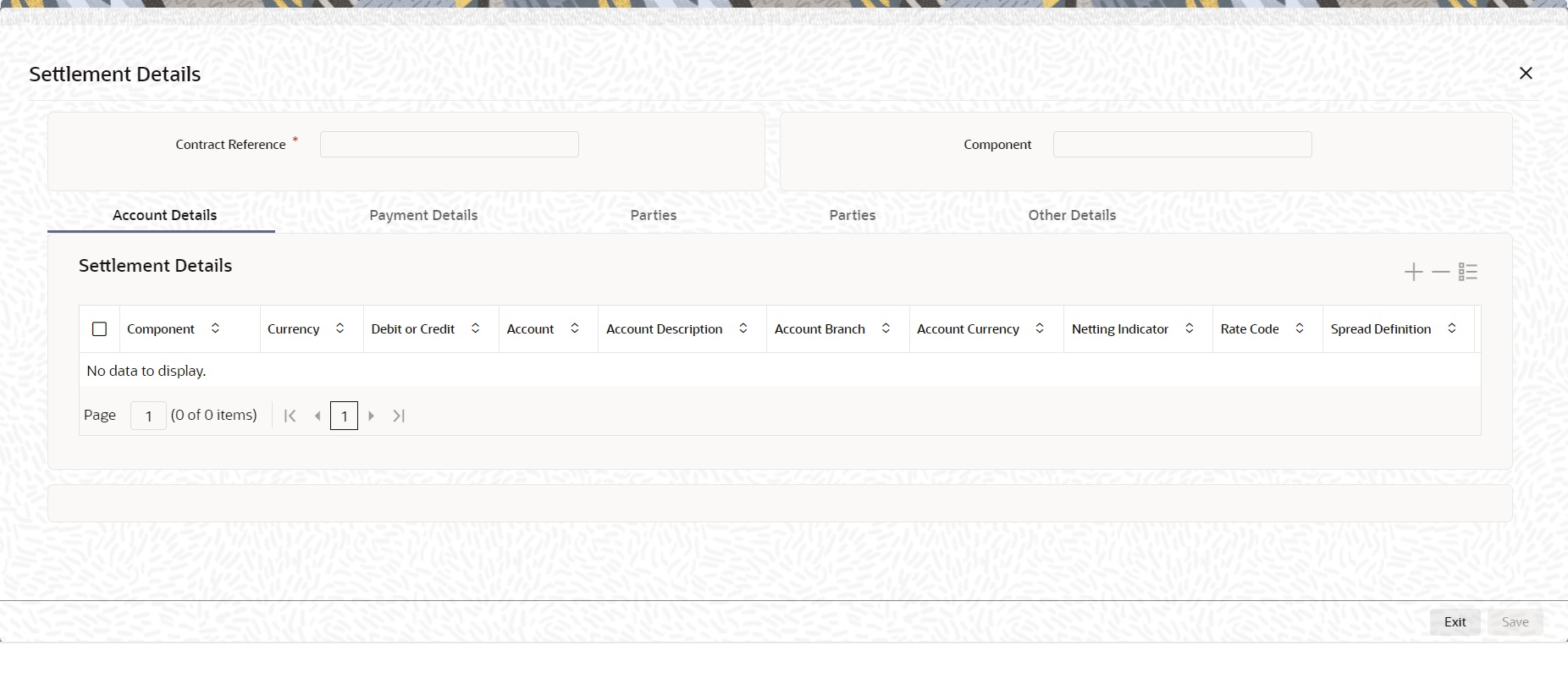

Settlement Details Specify the Settlement Details. Debit Branch
When selecting the settlement details of a deal, the user must specify the debit account Branch.
Debit Account
Specify the account to be debited for the money market deal.
Debit Account Description
The system displays the description of the specified debit account number based on the details maintained at 'Customer Account Maintenance' level.
Credit Branch
When selecting the settlement details of a deal, the user must specify the credit account branch.
Credit Account
Specify the account to be credited for the money market deal.
Credit Account Description
The system displays the description of the specified credit account number based on the details maintained at 'Customer Account Maintenance' level.
Liquidation
When setting up a product, the user specify the mode of liquidation, whether automatic or manual, for the different components of a deal. By default, all deals involving the product will inherit this definition. However, the user can change the mode of liquidation, from automatic to manual, or vice versa, while processing a deal.
Select the type of the Liquidation required.
The options are:
- Auto
- Manual
Rollover Allowed
Select the option if the Rollover is required or not.
While setting up a product, if the user specify the deals involving the product are automatically rolled over, all deals involving the product are rolled over on their respective Maturity Dates, if they are not liquidated. This feature is called auto rollover. If the auto rollover is specified for the product, the deal involves, it is indicated on this screen. However, if the user does not want the deal (whose details are being captured) to be rolled over, the user can disallow rollover for the deal. If rollover has been disallowed for a product, the user cannot rollover deals involving the product.
Note: For rollover to be applicable for the deal, it has to be defined for the product.
Original Start Date
For a deal that has been rolled over, this is the date on which the deal was originally initiated. If a deal has been rolled over more than once, this is the date on which the first deal was initiated.
If the users enter a deal that has already been initiated, the user must enter the date on which the deal began. In this case, the date is for information purposes only and for all accounting purposes the Value Date is considered as the date on which the deal was initiated.
Booking Date
The date on which the deal details are entered would be displayed in this screen. This defaults to the system date (today’s date). This date is for information purposes only. The accounting entries are passed as of the Value Date of the deal (initiation date of the deal). Amendment to this field is considered a financial amendment
Value Date
This is the date on which a deal takes effect. The accounting entries for the initiation of the deal is passed as of this date. The tenor of the deal will begin from this date, and all calculations for interest and all the other components based on tenor is made from this date onwards.
The system defaults to today’s date. The user can enter a Value Date of your choice here. The date that the user enter is any one of the following:
- Today’s date
- A date in the past
- A date in the future (the user can enter a date in the future only if Future Dating has been allowed for the product).
The Value Date must not be earlier than the Start Date or later than the End Date defined for the product involved in the deal. In case of a child rolled over the contract, this value is the same as the maturity date of the parent contract.
If the liquidation date for any component falls before today’s date, the liquidation entries (as defined by the user for the product) is passed if the user has specified for the product. If the Maturity Date of a deal is earlier than today, maturity entries are passed.
Once the deal details have been stored and authorized, this date is amended, if the deposit has a bearing type of interest and NO schedule has been liquidated. Modification to this field is considered as a financial amendment.
An override is sought if the Value Date falls on a holiday, in the country of the deal currency.
User Maturity Date
Change the maturity date of the deal here, based on the requirement.
Maturity Date
If the Maturity Type is fixed (that is, the Maturity Date of the deal is known when the deal is initiated) specify the Maturity Date. This date must be later than the Start Date of the product. If the product has a Default Tenor, this date is defaulted based on the tenor and the From date of the contract. If the user change this date, an override must be provided while saving the deal.
For a deal with Call or Notice type of maturity, the Maturity Date is not entered at the time of deal booking. The user can get this date updated through value dated amendment. This date must be later than the Start Date of the product.
If the product has a Default Tenor, this date is defaulted based on the tenor and the From date of the contract. If the user has specified auto liquidation for the deal, liquidation is done automatically on that date. If manual liquidation has been specified, the user will have to liquidate the deal through the Manual Liquidation function manually.
For a deal with Fixed Maturity Type, this date can either be extended or brought backwards through the Value Dated Changes function, once the deal has been initiated.
Notice Days
For a contract maturing at notice, the user must enter the notice period (in days). This is for information purposes only. When the notice to repay is issued to the counterparty, the user must indicate the Maturity Date of the deal using value dated amendment screen.
Intra Day
For Intra-day deals, the system populates the intra-day deal date in this field. The intra-day deal date is populated as value date +1. Only the user can enter intra-day deals using a product meant for intra-day deals (as set in the Product Preferences).
Tenor
If the product has a Default Tenor, this tenor is defaulted based on the tenor. On overriding this maturity date will get adjusted.
Maturity Type
Select the Maturity type from the options as required.
The Options available are:
- Fixed
- Notice
- Call
Rounding Details Specify the Rounding Details fields. Rounding Required
Select the checkbox if the Rounding process is required
Rounding Rule
Select the Rounding Rule from the drop-down box.
Decimals
Specify the decimal point to be rounded.
Units
Specify the Units to be rounded.
Reporting Details Specify the Reporting Details fields. Currency
Select the reporting currency from the option list.
Amount
The system displays the amount.
Outstanding Amount

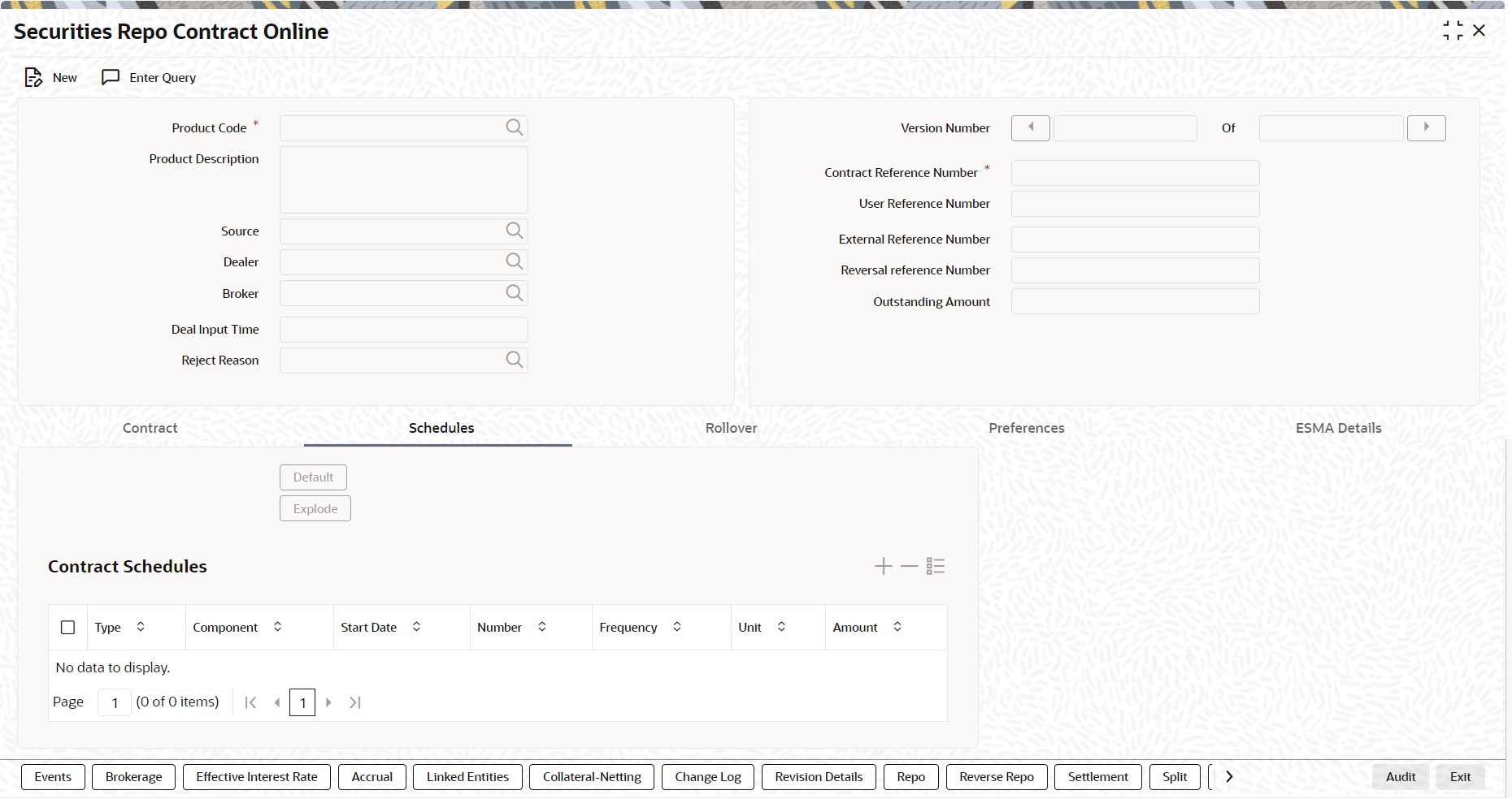

- On Security Repo Contract Online screen, click Schedules.
The contract inherits the schedule details from the associated product where the changes are allowed at the contract level.
The Security Repo Contract Online- Schedules Tab details is displayed.
Figure 2-17 Security Repo Contract Online - Schedules
Description of "Figure 2-17 Security Repo Contract Online - Schedules" - On the Security Repo Contract Online - Schedules Tab screen, click Explode.

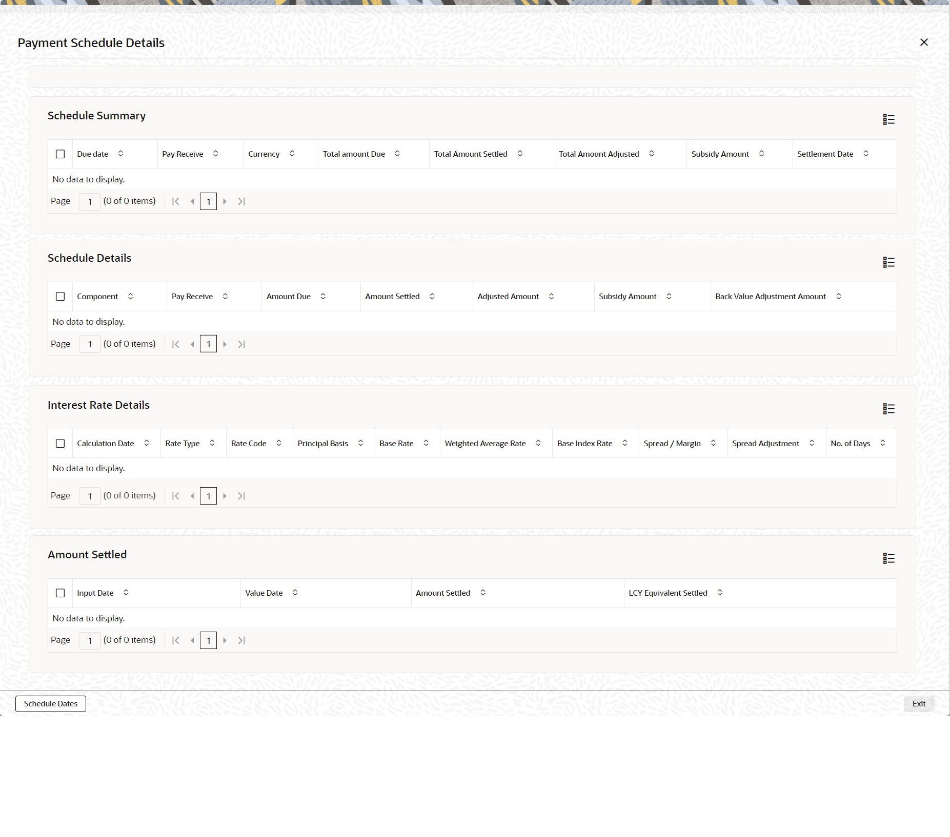

The Payment Schedule Details screen is displayed.
Description of the illustration srdtronl__payment_schedule.png - On the Payment Schedule Details screen, refer to the provided payment schedule break-up.
The following details are available:
Table 2-20 Schedule Breakup- Field Description
Field Description Schedule Summary
- Due Date after applying payment delay
- Pay Receive
- Currency
- Total Amount Due
- Total Amount Settled
- Total Amount Adjusted
- Subsidy
- Amount
Schedule Details
- Component
- Pay Receive
- Amount Due
- Amount Settled
- Adjusted Amount
- Subsidy Amount
- Back Value Adjusted Amount
Interest Rate Details
- Calculation Date
- Rate Type
- Rate Code
- Principal Basis
- Base Rate
- Base Index Rate
- Spread/Margin
- Spread Adjustment
- No. of Days
- Compound Interest
- Simple Interest
- Total Interest
- Cumulative Interest
- Rate Pickup Date
Amount Settled
- Input Date
- Value Date
- Amount Settled
- LCY Equivalent Settled
- On the Security Repo Contract Online - Schedules Tab screen, specify the details as required.
For information on fields, see the table below:
Table 2-21 Schedules Tab- Field Description
Field Description Contract Schedules Specify the Contract Schedules details. Type Specify the Type of schedule maintained for the contract.

- On the Security Repo Contract Online screen, click Rollover.
The Security Repo Contract Online- Rollover Tab details is displayed.
Figure 2-18 Security Repo Contract Online- Rollover
Description of "Figure 2-18 Security Repo Contract Online- Rollover" - On the Security Repo Contract Online - Rollover Tab screen, specify the details as required.
For more information on Rollover process, refer to the below table.
For information on fields, see the below table:
Table 2-22 Security Repo Contract Online - Rollover Tab - Field Description
Field Description Rollover Amount
Specify the option for the Rollover Amount from the drop down list as required. The options are:
- Principal
- Principal + Interest
- Principal + (Interest - tax)
Special Rollover Amount
Specify the special amount if applicable
Treat Special Amount As
If the Special amount is specified, from the following options specify the what must it be treated as:
- Rollover Amount
- Liquidation Amount
- Maximum Rollover Amount
- Ignore
Daily Refinance Rate
Specify the refinance rate as per the requirement.
Rollover Specify the Rollover details. Roll By
Select the option from the drop-down list.
The options available are:
- Days
- Months
- Quarters
- Semiannual
- Years
Method
Select the Method from the drop-down list.
- Normal
- Split
- Consolidated
Mechanism
Select the Mechanism from the drop-down list.
- New Version
- Spawn Contract
- Linked Contract
Mode
Select the Mode as required.
The options are:
- Auto
- Manual
ICCF Rollover
Select the ICCF Rollover details as required:
The options are:
- Product
- Contract
Schedule Basis
Select the Schedule Basis details as required.
The options are:
- Product
- Contract
Preferences Specify the Preferences details. Apply charge on Rollover Amount
Select this Check box if charge is applied on Rollover
New Components Allowed
Select this Check box if new component is allowed for the rolled over contract
Liquidate Overdue Schedules
Select this Check box to liquidate over due schedules on rollover
Apply Tax on Rollover Amount
The user must indicate if the tax must be applied on the rolled over deal.
Update Limits Utilization
Whether the credit limit utilization is to be updated when a reverse repo deal is rolled over, that is, the interest that has been accrued on reverse repo is also considered as a part of the ‘utilized amount’ for the purpose of risk tracking. This option applies only if the user wants to roll over a deal with interest.
Maturity Specify the Maturity details. Maturity Days
Specify the new maturity days for rolled over contract.
Maturity Date
Specify the new Maturity date for the rolled over contract.
Maturity Type
Select the Maturity Type as required.
- Fixed
- Notice
- Call
Interest Basis Specify the Interest Basis details. Component
System defaults the component which is to be rolled over.
Basis
Select the option from the drop-down list as required.
- Product
- Contract
- User Rate
Rate Type
Select the rate type from the drop-down list.
- Fixed
- Floating
Code Usage
Select the Code Usage from the drop-down list.
- Auto
- Periodic
Interest Basis
Select the Interest Basis from the drop-down list.
- 30-Euro/360
- 30(US)/360
- Actual/360
- 30(Euro)/365
- 30(US)/365
- Actual/365
- 30-Euro/Actual
- 30(US)/Actual
- Actual
Rate Code
Specify the new rate code for rolled over contract when the basis is user
Spread
Specify the new spread for the rolled over contract when the basis is user
Margin
Specify the new margin for the rolled over contract when the basis is user
Amount
Specify the new Interest amount for the rolled over contract when the BASIS is user.
Tenor
Specify the new tenor for the rolled over contract
- On Security Repo Contract Online screen, click Preferences.Preferences are options. For instance, for a product, the users have the option of:
- Making liquidation automatic or manual
- Allowing or disallowing rollover
- Applying tax or waiving it
- Applying prepayment penalty or waiving it etc
- Generation of Deliver verse Payment message
- Generation of Receive verse payment message
- Giving Cash margin details
The Security Repo Contract Online - Preference tab details is displayed.
Figure 2-19 Security Repo Contract Online - Preference
Description of "Figure 2-19 Security Repo Contract Online - Preference" - On the Preferences tab, specify the details as required.
Table 2-23 Securities Repo Contract Online - Preference Tab - Field Description
Field Description Holiday Treatment
Specify the Holiday Treatment details. Cascading schedules Select this check box, if one schedule is moved backwards or forward because of a holiday, the other schedules are accordingly shifted. If the user does not want to cascade schedules, then, only the schedule, which falls on a holiday, is shifted as specified and the others will remain as they were.
Move Across Months
Select this check box, if the user needs to move a schedule falling due on holiday either forward or backwards to the next or previous working day and it crosses over into a different month, then the system moves the scheduled date. If not, scheduled date is kept in the same month, on the last or first working day of the month, depending on whether the schedule is over the month-end or the beginning of the month.
Move Payment Schedule
Select this box, if user needs to move the payment schedule. When the system computes the repayment date, there is a chance that one or more schedules fall due on holiday.
Move Revision Schedules
Select this box, if user needs to move the Revision schedule falling on a holiday
Move Forward
Check against this field to indicate that the schedule of the contract must be moving forward to the next working day.
Move Backward
Check against this field to indicate that the scheduled date of the contract is moved back to the previous working day.
Others Specify the Others details. Liquidate Back Valued Schedules
Select this checkbox to define the product, that a back-dated deal with repayment schedules before today's date, the schedules are liquidated when the deal is initiated, the same will apply to the deal the user is entering. However, through this, the user can choose not to liquidate back valued schedules.
Net Negative Interest
Check this box to indicate that the system should internally net the positive and negative amounts being paid to the customer during interest liquidation.
Track Receivable Specify the track receivable fields. Manual Liquidation
Select this option to track receivables during manual liquidation. In case of manual payments, the system will display an override if sufficient funds are not available in the settlement account. If the user say Yes to the override, the system will mark the fund as a receivable amount.
Partial Manual Liquidation
During manual liquidation, if sufficient funds are not available in the settlement account of the contract, the user can opt to make a partial payment. In this case, the deal is liquidated to the extent of the amount available in the account. The balance due is tracked as a receivable amount. During EOD processing of the contracts, based on the availability of funds, the deal is liquidated. This process will continue until the deal is recovered fully. The deal is in the active status till full liquidation happens. If the user does not choose to make a partial payment, then the entire amount that is being manually paid are tracked as a receivable against the settlement account.
Automatic Liquidation
Select this option if the user want to track receivables during automatic liquidation.
Loan Statement
Specify the Loan statement details. Cycle
Specify the cycle on which loan statement must be generated
Statement Type
- None
- Detailed
- Summary
External Interface Details Specify the External interface details. External Reference System updates the external reference number
Parent Reference System updates the parent reference number
REPO Specify the Repo details. Delivery Verse Payment Select this checkbox to Generate MT543/MT541 message on Repo Booking and liquidation.
Reverse Repo Speify the Reverse Repo details. Receive Verse Payment Select this checkbox to Generate MT541/MT543 message on Repo Booking and liquidation.
Settlement Message Generation Details Specify the Settlement Message Generation Details. Settlement Message Generation Required Select this checkbox, to settle message generation required.
Demand Basis Select the option from the drop-down list.
The options are:
- SGEN
- Billing Notice
Cash Margin Specify the cash margin details. Margin Account Specify the value from the list of values displayed. The Options available are GL or CASA account for cash margin transaction.
Note: This is a Mandatory field if collateral revaluation preference is margin settlement at SR Product.
Account Currency Specify the Currency of the account maintained.
This is a Mandatory field if margin account is chosen
Account Branch Specify the branch of the account maintained.
- On the Security Repo Contract Online screen, click the ESMA Details tab.
The Security Repo Contract Online - ESMA Details page is displayed.
Figure 2-20 Security Repo Contract Online - ESMA Details
Description of "Figure 2-20 Security Repo Contract Online - ESMA Details" - On the Securities Repo Contract Online screen, click the ESMA Details tab and specify the ESMA details as required.For more information on fields, refer to the below table.

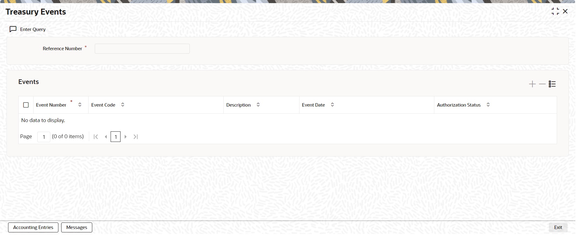

View all the events that have to take place on a Securities Repo deal through the View Events screen.
All the events that taken place on the deal so far are listed in this screen according to the sequence in which they have taken place. The Date on which the event took place will also be displayed.
- Access this screen by clicking on the view events button in any of the Contract On-line screens.
- View the list containing events like Booking, Initiation, Interest Accrual, etc
- On the Security Repo Contract Online screen, click Events
The Treasury Events screen is displayed.
Figure 2-21 Treasury Events
- On the Treasury Events screen, specify the details as required.
Table 2-25 Treasury Events - Field Description
Field Description Reference Number
Payment reference number automatically gets defaulted for the current payment.
Events Specify the events details. Event Number
This is a Mandatory field.
Event Code
Displays the contract event code
Description
Displays the Event description
Event Date
Displays the Date on which event is generated
Authorization Status
Displays the event authorization status
Maker Id
Displays the maker ID
Checker Id
Display the Checker ID

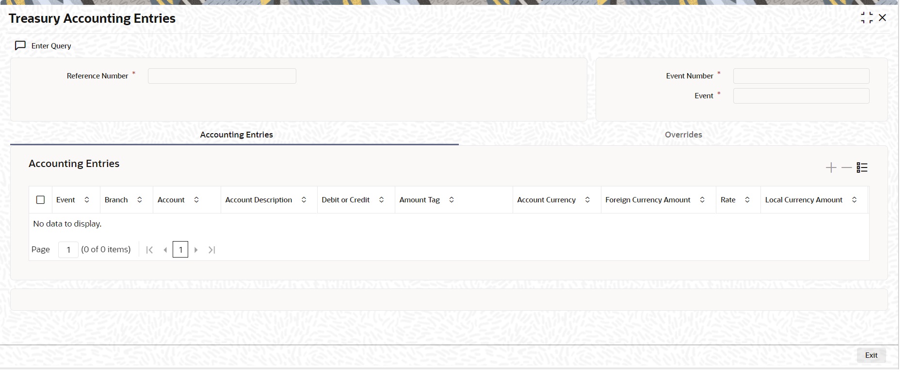

- On the Treasury Events screen, click Accounting Entries.The Treasury Accounting Entries screen is displayed.
Figure 2-22 Treasury Accounting Entries
- On the Treasury Accounting Entries screen, specify the details as required.
Table 2-26 Treasury Accounting Entries- Field Description
Specify the contract reference number.
Event Number
Specify the event number.
Event
Specify the event code.
Accounting Entries Specify the accounting entries details. Event
Displays the Event code for the contract
Branch
Displays the Account branch
Account
Displays the Account number
Account Description
Displays the Account Description
Debit or Credit
Displays whether the account is Dr or Cr
Amount Tag
Displays the amount tag associated to the event
Account Currency
Displays the account currency
Foreign Currency Amount
Displays the Foreign currency amount
Rate
Displays the exchange rate
Displays the Local currency equivalent amount when the contract currency is in FCY currency
Date
Displays the Transaction date
Value Date
Displays the value date of the event
Txn Code
Displays the transaction Code

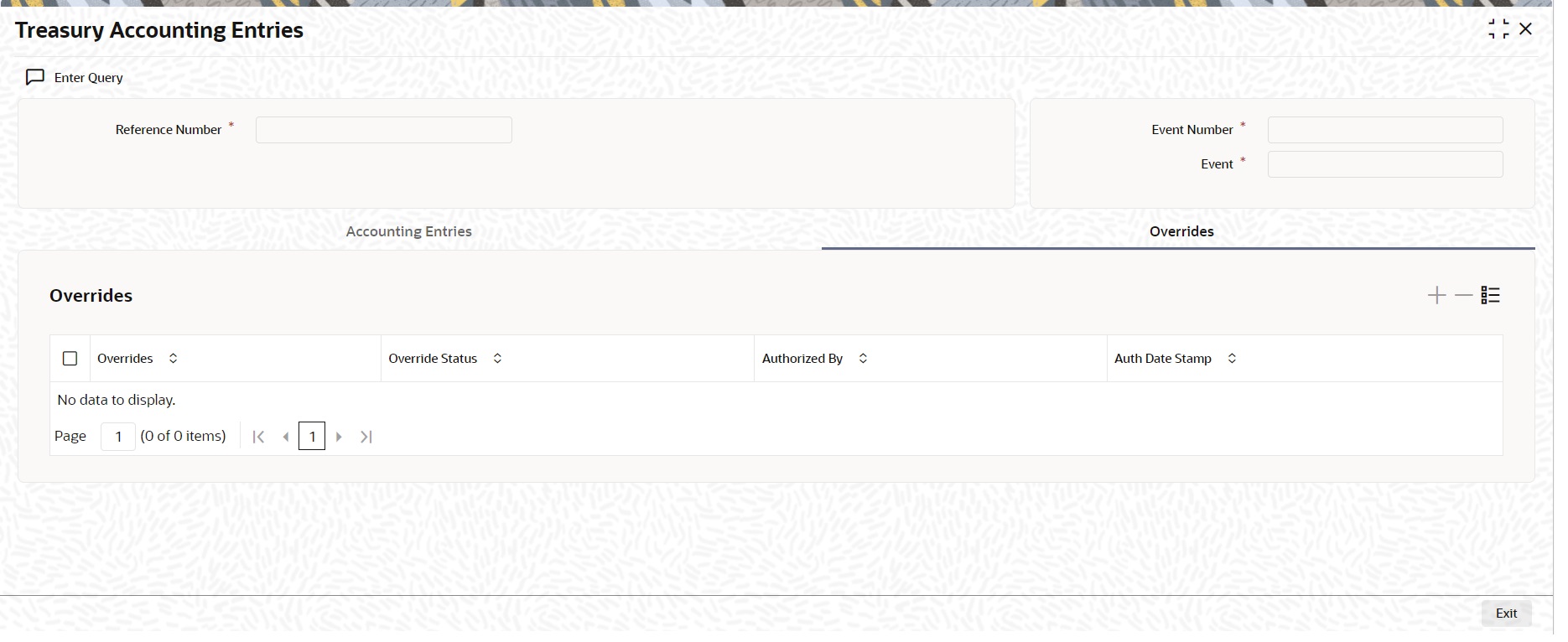

- On the Treasury Accounting Entries screen, click Overrides.
The Treasury Accounting Entries screen with Overrides tab details is displayed.
Figure 2-23 Treasury Accounting Entries- Overrides
Description of "Figure 2-23 Treasury Accounting Entries- Overrides" - On the Overrides tab, specify the details as required.
For more information on fields, see the below table:
Table 2-27 Overrides - Field Description
Displays the contract reference number
Event Number
Displays the event number
Event
Displays the event code
Overrides
Displays the Override message generated for the event
Override Status
Displays the override status
Authorized By
Displays the Authorizer user ID
Auth Date Stamp
Displays the authorization Time stamp

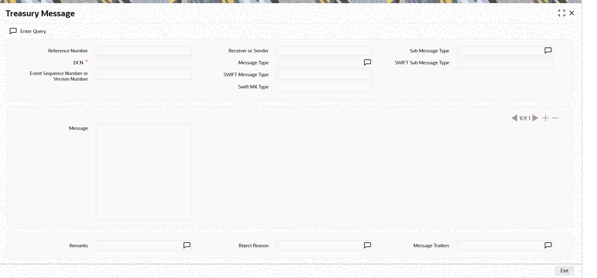

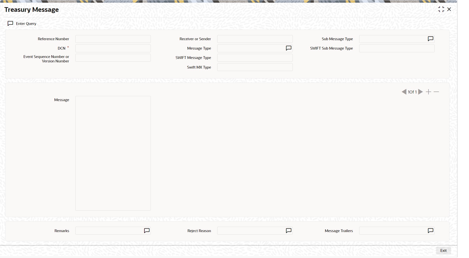

- On the Treasury Events screen, click Messages.
The Treasury Message screen is displayed.
- On the Treasury Message screen, specify the details as required.
For information on fields, see the below table.
Table 2-28 Treasury Message- Field Description
Field Description Contract Reference
Event Sequence Number
Displays the Event sequence number
Event
Messages Specifies the messages details. Message Type
Displays the Message Type
SWIFT Message Type
Displays the Swift Message Type
Sub Message Type
Displays the Sub Message Type
SWIFT Sub Message Type
Displays Swift Sub Message type
Test Status
Displays Test status
Medium
Displays message medium
Message Status
Displays the Message status
Displays Message Authorization status
Receiver
Displays the Receiver of the message
Receiver Name
Displays the Receiver name of the message

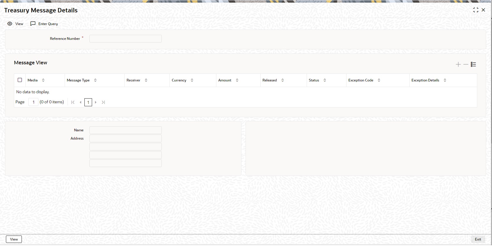

- On the Treasury Message screen, click Message Details.Treasury Message screen with Message Details is displayed.
To view the text of a message, highlight the message and click Message Details. Click Exit or Cancel button to exit the screen.

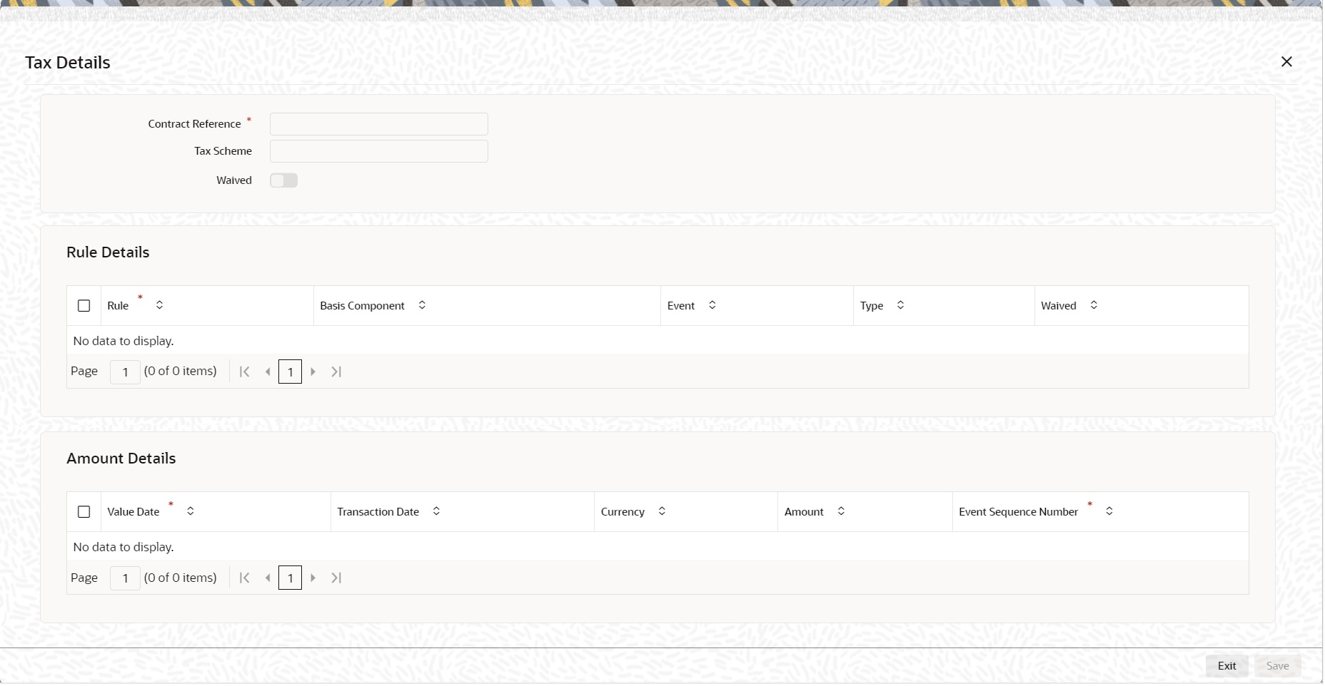

Display the Other Details of a Deal
Using the buttons that are displayed in the ‘Contract Online’ screens the user can view the following details of a deal:
- The settlement details
- The tax details
- The MIS details
- The ICCB details
- The brokerage details

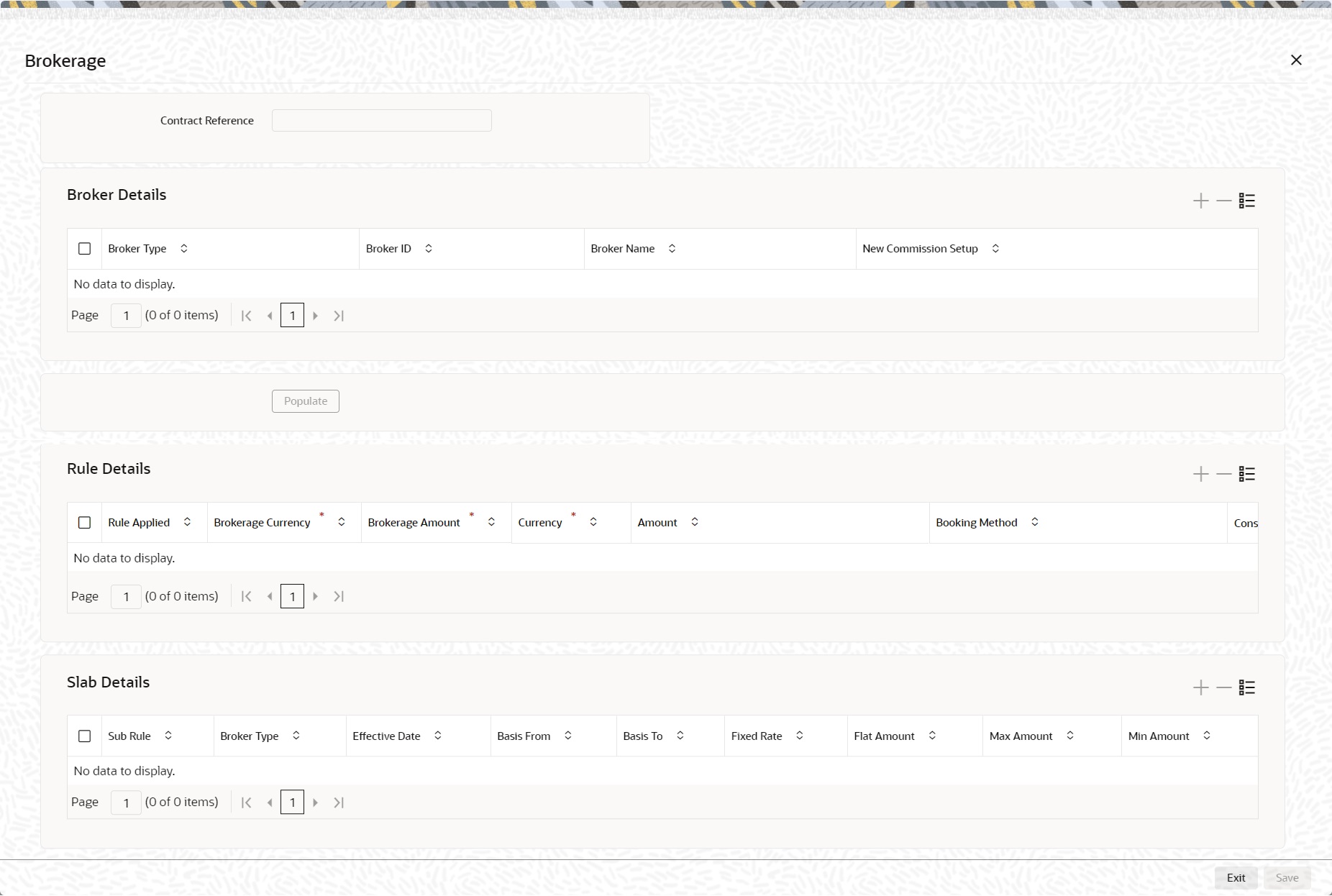

- On Security Repo Contract Online screen, click Brokerage.
The Brokerage screen is displayed.
- On Brokerage screen, specify the details as required.
Table 2-29 Brokerage- Field Description
Field Description Broker
Defaults Broker ID mapped for the deal
Broker Name
Displays the Broker name
Rule
Defaults the Broker Rule mapped at the product
Payable Specify the payable details. Currency
Defaults Broker payable currency
Amount
Defaults the Broker amount to be paid
Brokerage Specify the Brokerage details. Currency
Defaults the Broker currency
Amount
Liquidation Specify the Liquidation details. Status
Displays the brokerage liquidation status
Reference Number
Displays the brokerage liquidation reference number
Booking Specify the Booking details. No Booking
To waive brokerage for the transaction, choose the 'No Booking' option.
Advance
Brokerage is booked when the deal is initiated
Arrears
Brokerage is booked when the deal is liquidated
Consider For Discount
This option is defaulted from the deal product level. However, checkbox is unchecked if the booking method is other than Advance.

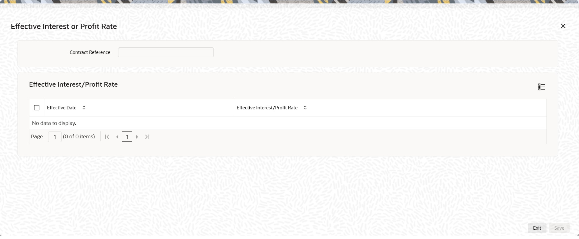

- On Security Repo Contract Online screen, click Effective Interest Rate.The Effective Interest or Profit Rate screen is displayed.
Figure 2-27 Effective Interest or Profit Rate
Description of "Figure 2-27 Effective Interest or Profit Rate" - The processing related to Effective Interest Rate is
as follows:
- During rate revision of contracts with negative interest allowed products, based on the effective interest rate after rate revision being positive or negative, the system assigns the interest rate to main interest or negative interest component internally.
- If the effective rate is negative, the system updates the main interest component rate as zero and assigns the negative rate to negative interest component.
- If negative interest is not allowed for the product, then the system skips rate revision for the contract, if the effective rate becomes negative. Exception is logged for the same. You need to initiate amendment of the spread such that net interest rate becomes positive in such cases.
- If default minimum value is maintained for the main interest component, then the system defaults the same during rate revision, if the interest rate goes below the specified rate.
- On the Effective Interest or Profit Rate screen, specify the details as required.
For Information on fields, see the below table
Table 2-30 Effective Interest or Profit Rate- Field Description
Displays the Contract reference number.
Effective Date
Displays the effective date on which rate is revised.
Effective Interest/Profit Rate
Displays the Revised Effective interest rate.

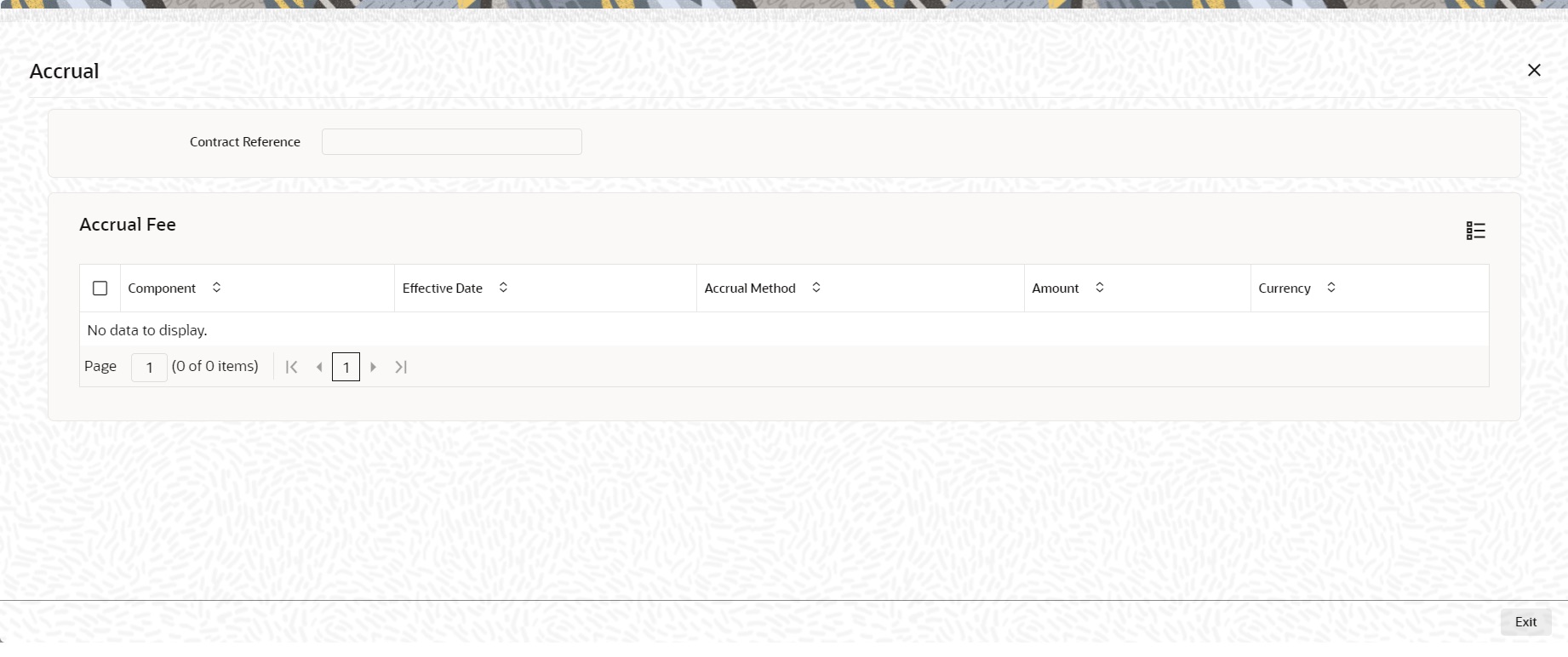

- On the Security Repo Contract Online screen, click Accrual.
The Accrual screen is displayed.
Figure 2-28 Security Repo Contract Online- Accrual
Description of "Figure 2-28 Security Repo Contract Online- Accrual" - On the Accrual screen, specify the details as required.
Table 2-31 Accrual- Field Description
Component
Displays the accrual component
Effective date
Accrual Method
Displays the Accrual method
Amount
Displays the Accrual amount
Currency
Displays the Accrual currency

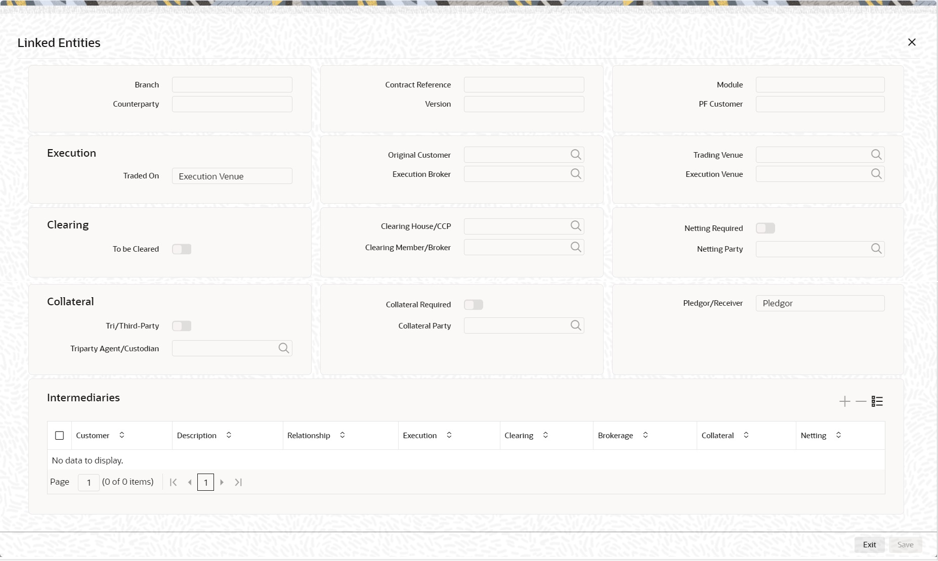

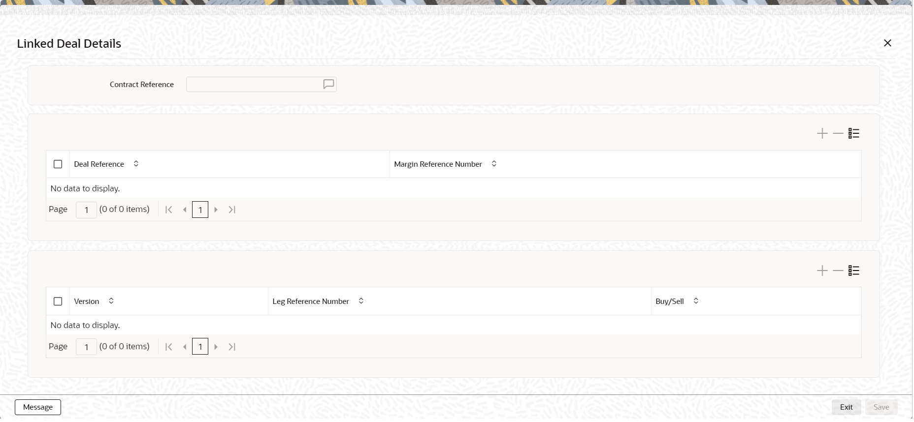

- On Security Repo Contract Online screen, click Linked Entities.
Security Repo Contract Online- Linked Entities screen is displayed.
- On the Linked Entities screen, specify the details as required.

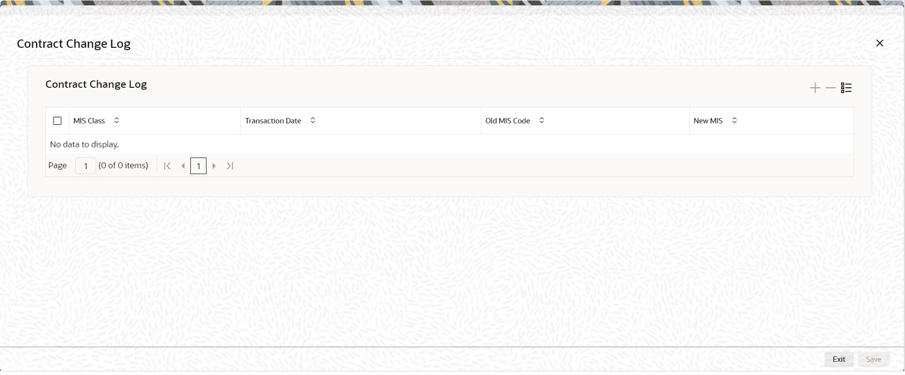

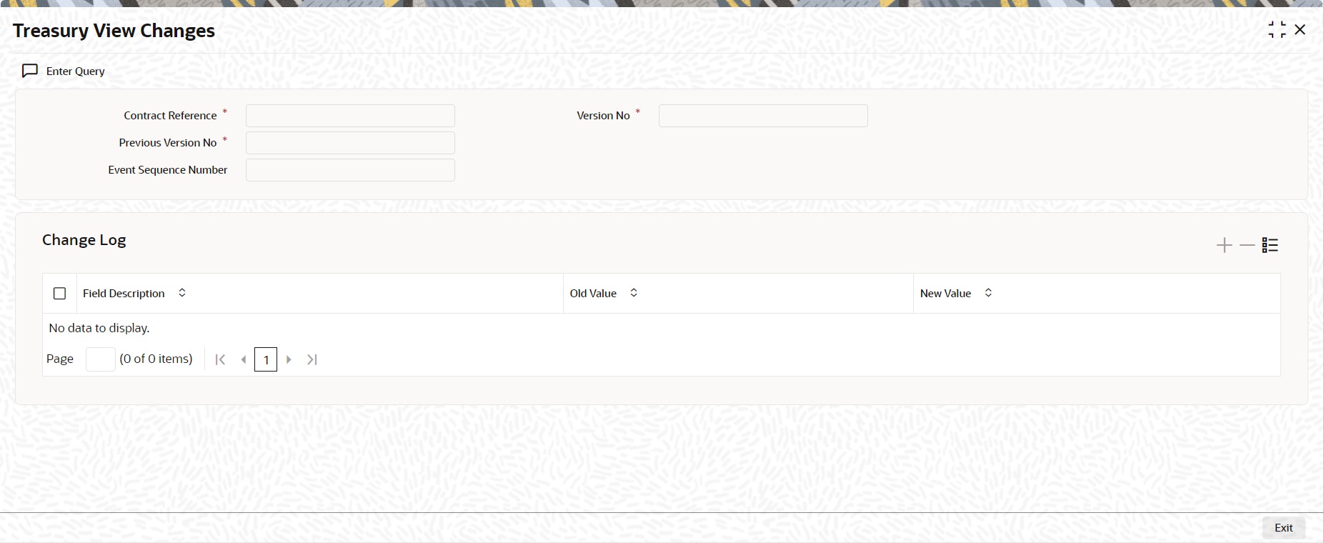

- On the Security Repo Contract Online screen, click Change Log.
Treasury View Changes screen is displayed.
- On the Treasury View Changes screen, specify the details as required.
Table 2-32 Treasury View Changes- Field Description
Field Description Event Sequence Number
Displays the event sequence number
Version No
Displays the event version number
Field Description
Displays the modified field
Old Value
Displays the old value
New Value
Displays the New value

To define a schedule with periodic rate code usage, through the Contract Schedules screen, mark the component as a revision schedule and specify the component, say INTEREST, from the pick list. Give the frequency at which the interest rate has to be refreshed, say weekly. Give the Start Date, say 8 October. The first revision will happen on this day, and every week from then on. Save the inputs.
Define a date based rate revision schedule
If the user were to define specific dates - 7 October, 15 October and 23 October - for the rate revision to happen, then, through the Contract Schedules screen, mark the component as a revision schedule and specify the component, say INTEREST, from the pick list.
Specify the date on which the rate revision is to be done, in the Start Date field, as 7 October. Similarly, define the other dates, but by picking up the same component INTEREST from the pick list each time.
Define a repayment schedule for the same component
Now to define a repayment schedule for the same component, INTEREST, click schedules Tab and choose the component interest from the pick list. Now draw up a repayment schedule for this component. Give a value in the Start Date field, say 15 October 1997. The first interest liquidation will be done on this date.
In the frequency field enter ‘monthly’ and in the unit field specify ‘2’. This means the interest repayments will be done every fortnight beginning 15 October.
That is, for a deal defined with frequency-based periodic rates, the rates prevailing on the refresh dates will be used for accruals and liquidation. In the deal we are discussing, with the refresh frequency defined as weekly and the Start Date as 15 October, the rate applied for the interest liquidation on 15 October will be as follows:
Table 2-33 Interest liquidation on 15 October
| From | To | Rate |
1 October |
8 October |
12 |
9 October |
15 October |
11.5 |
For a deal with Periodic rate code usage (date based), the rates prevailing on the specific refresh dates will be used for accruals and liquidation. Shown below are the rates applicable on the specified revision dates.
Table 2-34 Rates Applicable
| From | Rate Applicable |
7 October |
12 |
15 October |
11.5 |
23 October |
11.5 |
In the deal we are discussing, the rates applied for the interest liquidation on 15 October will be as follows:
Table 2-35 Interest Rates
| From | To | Rate |
1 October |
7 October |
12 |
8 October |
14 October |
12 |
15 October |
11.5 |

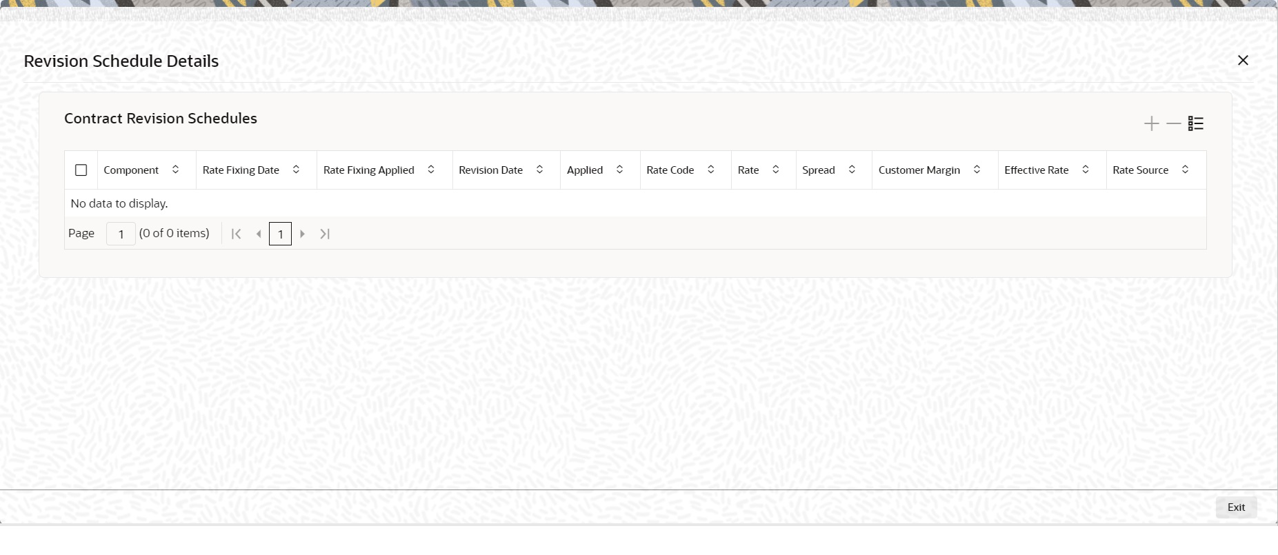

- On Security Repo Contract Online screen, click Revision Details.
The Revision Schedule Details screen is displayed.
Description of the illustration srdtronl_cvs_revsionscheduledetails.png - On the Revision Schedule Details screen, specify the details as required.
Table 2-36 Revision Schedule Details - Field Description
Field Description Component
Specify the component for which the schedule is being defined. The options are
- Principal
- Fee
- Commission
- Charge or interest
Rate Fixing Date
Displays the derived Rate fixing date
Rate Fixing Applied
Displays whether Rate fixing is applied for the contract or not.Values - N, Y
The system generates the SGEN only when the rate fixing applied option is Y for all the revision schedules.
Revision Date
Displays the revision date for the schedule
Revision Applied
Displays whether revision is applied or not Values - N, Y.
Rate Code
Displays the Floating Rate code mapped to the contract
Rate
Displays the Floating rate from the floating rate table
Spread
Displays the Rate Code spread for the contract
Customer Margin
Displays the customer margin
Effective Rate
Displays the Effective interest rate
Rate Source
Displays the Rate source from where the rate is taken

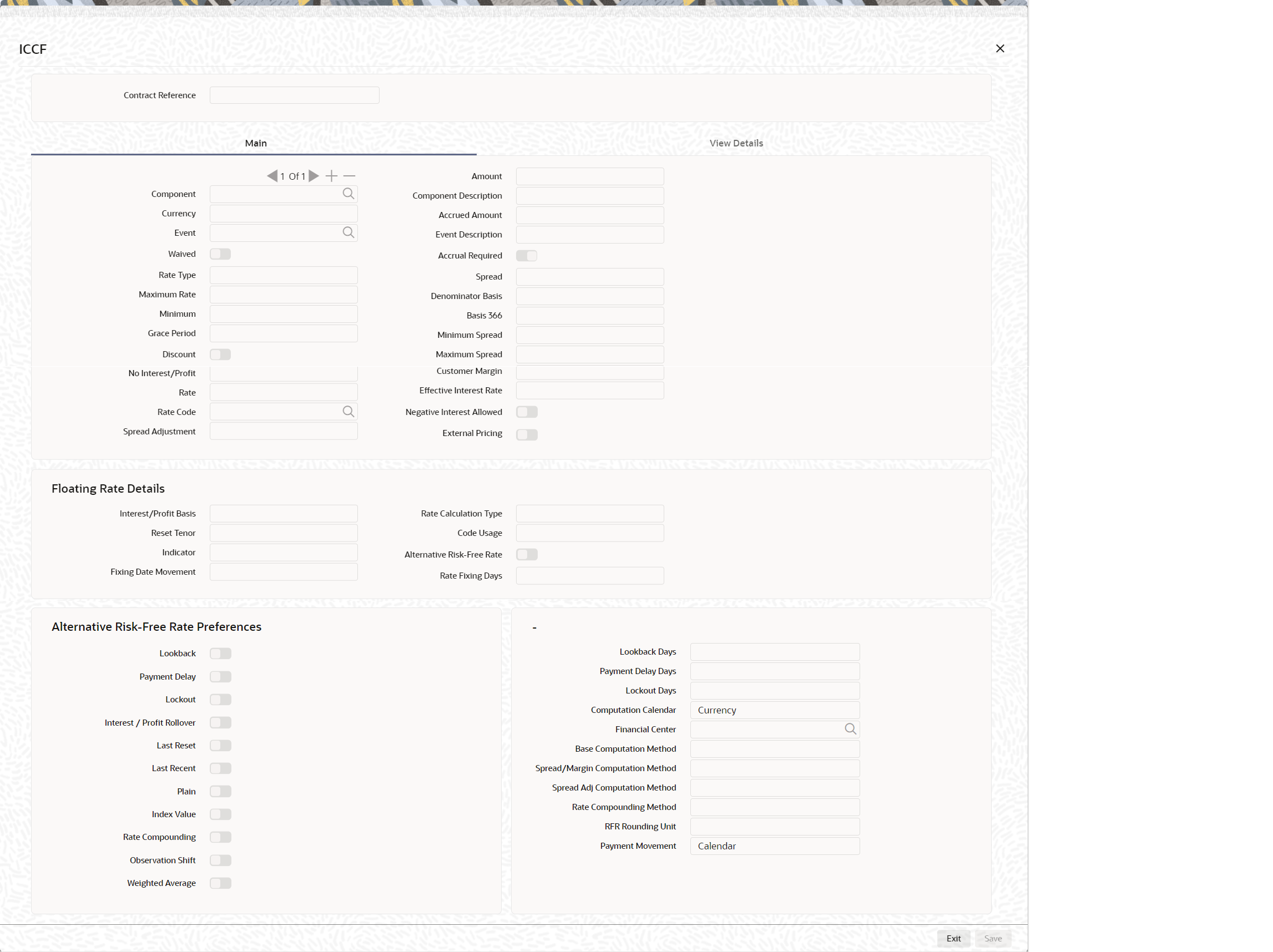

- On the Security Repo Contract Online screen, click Interest.
The ICCF screen is displayed.
- On Interest screen, specify the fields.
Table 2-37 Interest- Field Description
Displays Contract reference number
Component
Displays the Interest component mapped to the contract
Currency
Displays the Interest component currency
Event
Display the Event associated with the component
Waived
Specify whether user wants to waive the interest
Rate Type
Select the Rate Type from the drop-down list.
The options are:
- Floating
- Special
- Fixed
Maximum Rate
Displays the maximum rate for the component
Minimum
Displays minimum rate for the component
Grace Period
Select the Grace Period from the drop-down list.
The options are:
- Months
- Years
- Days
Discount
Defaults discount flag from product
No Interest/Profit
Displays the contract Interest
Rate
Specify the contract Fixed interest rate. System defaults 'Default rate' from product. User can modify the same.
Rate Code
Defaults Floating rate code from product. User can modify the same.
Amount
Specify the special interest amount for the contract.
Spread Adjustment
Specify the Rate code spread adjustment.
Component Description
Display the component description.
Accrued Amount
Displays the Interest accrued amount
Event Description
Accrual Required
Specify if Interest accrual required or not
Spread
Specify the rate code spread for a floating interest rate
Denominator Basis
Denominator Basis is used to specify how the month of February is treated when the denominator is 'Actual'.
Basis 366
Defaults from product. This is applicable only if the Denominator Basis is set to 'Per Annum'.
Minimum Spread
Displays minimum spread for the floating rate code
Maximum Spread
Displays maximum spread for the floating rate code
Customer Margin
Specify the customer margin
Displays the effective interest rate of the contract
Negative Interest Allowed
Check this box to indicate that the negative interest should be allowed for the product.
If this box is checked, then the system allows Negative fixed rates or resolved rates at the SR contract and during VAMI,
External Pricing
Defaults external pricing from product
Interest/Profit Basis
Defaults Interest Basis from product, which indicates the Interest basis for the component for which penalty is being computed
Reset Tenor
Floating interest rates are defined for specific amount slabs and tenor combinations.
User can indicate the reset tenor for which floating rates need to be picked up.
Indicator
The user can use this field to indicate whether the borrowing rate, lending rate or mid rate must be picked up from the floating rate table, for the specified rate code.
Fixing Date Movement
Defaults Rate fixing date movement from product. user can modify the same. The options are:
- Backward movement
- Forward movement
Rate Calculation Type
Defaults the rate calculation type from product
Code Usage
Specify the rate code usage. It can be periodic or automatic. In case of periodic user needs to define revision schedule for the floating interest component
Alternative Risk-Free Rate
Specify if the interest rate code is a risk free rate
Rate Fixing Days
Defaults the rate fixing days from product.
The method in which the number of days are to be calculated for interest, charge, commission or fee components and whether their application is tenor based is displayed here based on the specification the user made at the product level. The User can choose to change it.
- 30(Euro)/360
- 30(US)/ 360
- Actual/360
- 30(Euro)/365
- 30(US)/365
- Actual/365
- 30(Euro)/Actual
- 30(US)/Actual
- Actual/Actual
- 30(Euro)/364
- 30(US)/ 364
- Actual/364
Select the movements from the drop-down list.
The available movements are:- Forward
- Backward
- None
Select the Alternate Risk-Free Rate check box to enable the Alternate Risk Free-Rate preferences. For more information on the
Alternate Risk Free-Rate preferences fields, refer to . - The processing and validations involved in this screen
are as follows:
- Contract interest rate, irrespective of whether it is positive or negative, can be specified against main interest component only. Effective rate is displayed against Main Interest component only in both positive or negative cases. Internal allocation of the effective rate to negative interest component is done by the system.
- Effective Interest rate is derived based on the interest rate (Fixed/ Floating) and Margin (Spread) value captured for the SR contract (Deal) in OBTR.
- On a particular day, for a contract, only one interest component from main or negative components is active, based on the effective interest rate being positive or negative.
- If negative rate or amount is specified, then the system validates that product is enabled for negative interest.
- Negative Interest amount for 'Special Rate type' is not allowed
- Special interest amounts will not be allowed in ‘Interest Amount’ of ICCF screen, for negative interest allowed SR contracts.
- Negative interest amounts will not be allowed as ‘Acquired Amount’ in ICCF screen.

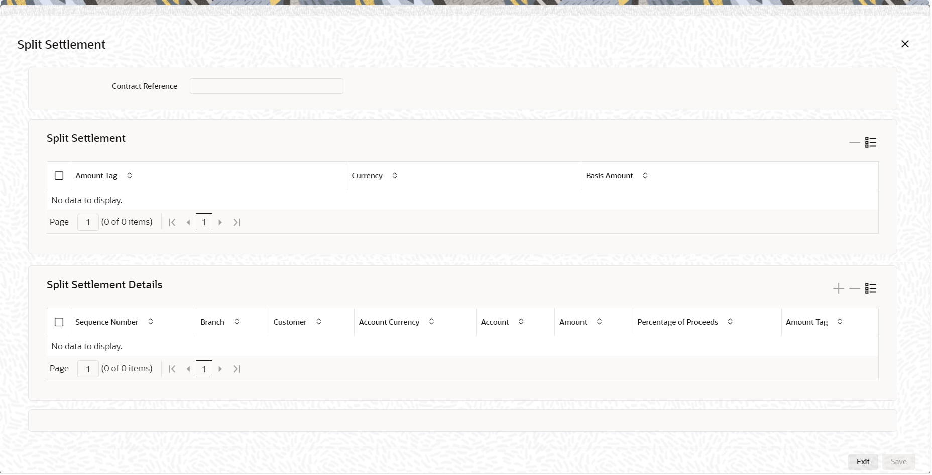

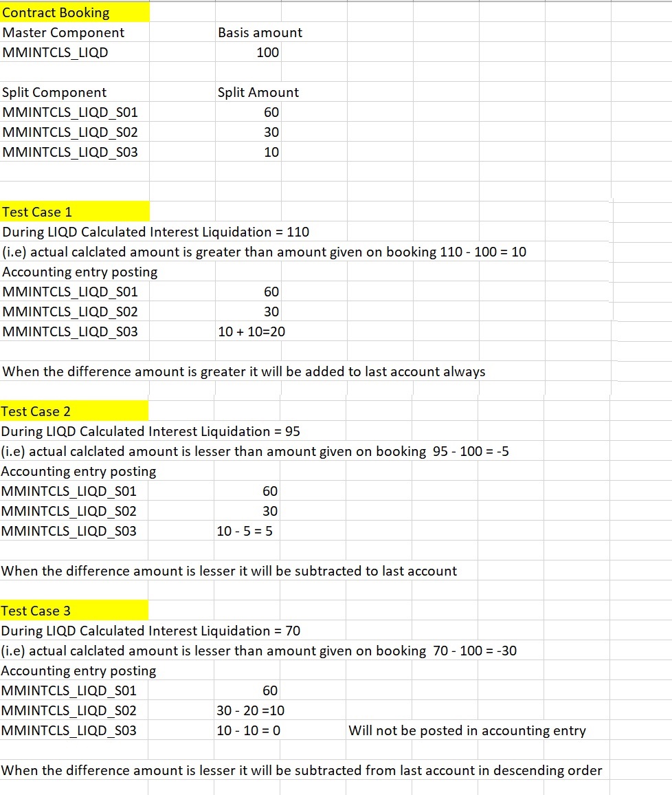

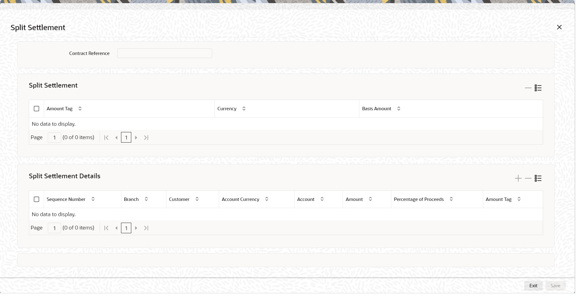

- On the Securities Repo Contract Online screen, click Split.
The Split Settlement Screen is displayed.
- On the Split Settlement screen, select a contract.
- On the Split Settlement screen, under the Split Settlement Details, click the + Icon.
Split Settlement screen with new row is displayed.
Figure 2-33 Split Settlement with a new row added
Description of "Figure 2-33 Split Settlement with a new row added"Note:
This process of splitting the settlements for a contract is allowed on the principal, Interest (Anticipated Interest for new contracts), and charges. - On the Split Settlement screen, specify the details as required.
For information on fields, refer to the below table:
Table 2-38 Split Settlement- Field Description
The selected contract reference number is displayed.
Basis Amount
The Basis Amount details is displayed.
Sequence Number
The Sequence number details is displayed.
Branch
The Branch details is displayed.
Click the search icon and select the branch as required.
Customer
The Customer number is displayed.
Click the search icon and select the customer as required.
Account Currency
Click the search icon and select the account currency from the list displayed.
Account
Click the search icon and select the account details from the list displayed.
Amount
Specify the amount details as required.
Percentage of Proceeds
This is a read only field, system displays the percentage of proceeds after save.
Amount Tag
System displays the amount tag details as required.
- Choose the Account Currency, Account, and other necessary
details, to create a split.
- For every Settlement contract the system allows a maximum of twelve splits.
- In case of auto-liquidation, the user must unlock the contract and register the split, upfront, that is prior to auto-liquidation. The updating provision, split settlement for the interest portion, is only available after saving and first approval. For each split amount, SGEN is produced. In field 72 of MT202 and MT202COV, the system will suffix the reference number with a hyphen followed by a running sequence number for each SGEN.
- Only if split settlement details are available, system will process the transaction accordingly, else the payment/settlement is treated as a single payment transaction
- If the user are splitting the contract during the rollover, the application considers the latest available split details and process the liquidation amount, if any. If split settlement details are not available, the transaction (partial (liquidation as part of rollover) is treated as normal/regular/non-split liquidation. The split is allowed in manual rollover as well.
- For a single component, the user can split the settlement amount and use the same settlement account more than once. There is no restriction on the repetition of split settlement amount for the same NOSTRO/settlement account.
- Cross currency split settlement is supported. The Amount field/column in the Split tab is, by default, in the contract currency (though not evident in the User Interface). The currency of the settlement account can be in a different currency. The converted amount has to be viewed in the accounting entries as part of Events tab only.
- Appropriate Amount tags, for each component like principal, interest and charges, are made available at the relevant event(s) for enriching the split settlement details.
- On Security Repo Contract Online screen, click Messages.
Treasury Message Details screen is displayed.
- On the Treasury Message Details Screen, specify the details as required.
The following details of Advices are displayed:
- The message type
- The Name and ID of the recipient of the message and
- The status of the message.
click Messages to view the list of advices applicable to a particular event in the lifecycle of the repo.
- On the Treasury Message Details screen, click View.
To view the text of a message, highlight the message and click . Click Exit or Cancel button to exit the screen.
View the following details:
- Reference number of the message/advice
- Document number generated for the message/advice
- Version number of the message/advice
- Receiver/sender of the message
- Type of the message
- Type of the SWIFT message
- Complete text of the message/advice
- Remarks, if any
- Reject reason, if any
- Message trailer
- On Security Repo Contract Online screen, click Settlement.
The settlement account details of each deal is displayed in the Settlement Instructions screen. Click on the contract for which the user want to view the settlement details and it is displayed in the Settlement Instructions section. For each amount tag, the following settlement details are displayed:
- Settlement account
- Currency of the settlement account
- Settlement account branch
- Payable or Receivable
- Ordering Institution
- Ordering Customer
- Beneficiary Institution
- Ultimate Beneficiary
- The settlement details for the latest event of the deal is displayed.
The Settlement Details screen is displayed. - On the Settlement Details screen, specify the details as required.
The deal gets settled based on the details specified in the settlement screen.
For more details on this screen, refer to Settlements User Manual, section Processing Settlements. - On the Security Repo Contract Online screen, click Charges.

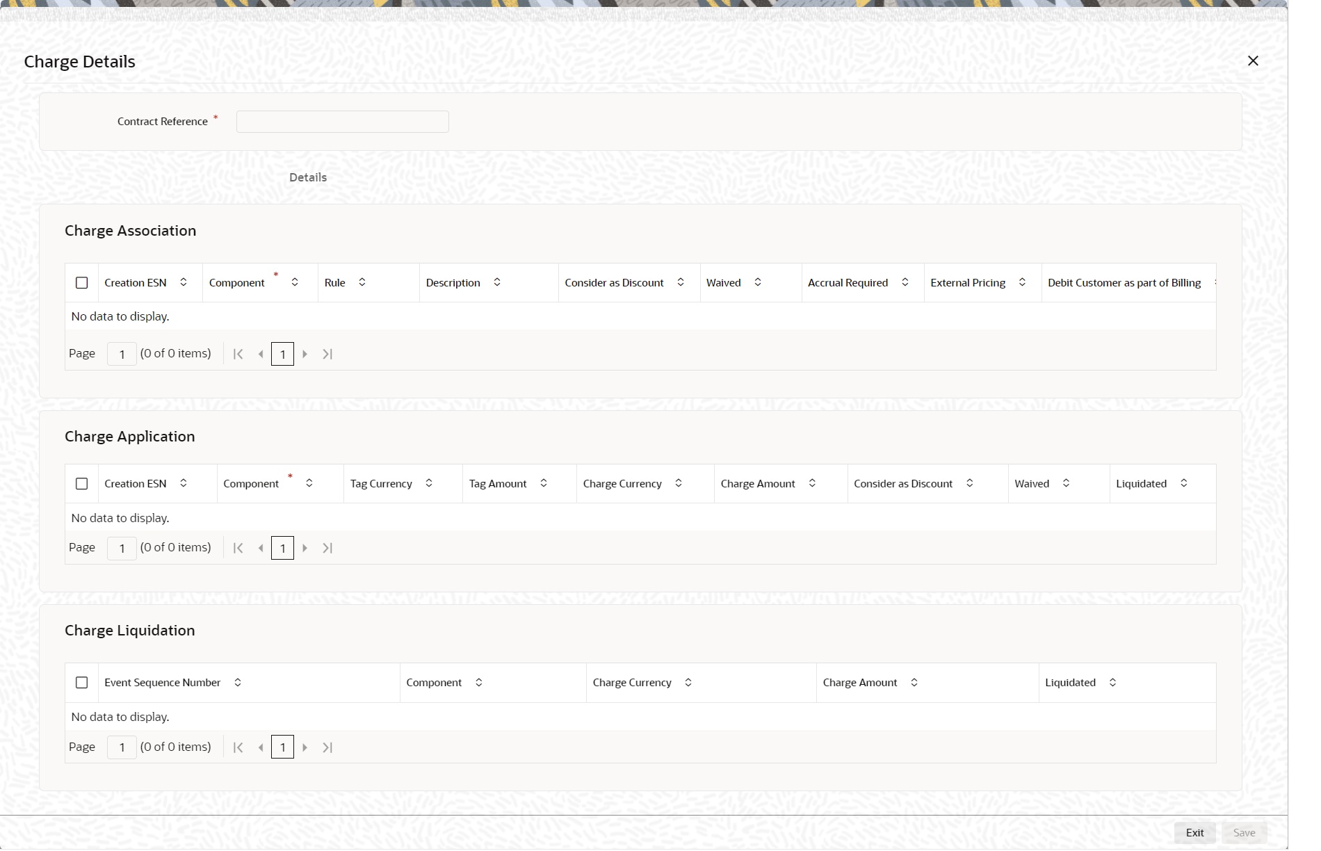

The Charge Details screen is displayed.
- On the Charge Details screen, specify the details as required.
The ICCF rate, amount, currency and the user can specify waive charge parameter. The Processing Charges and Fees manual, details the procedure for maintaining charge rules. - On the Security Repo Contract Online screen, click Tax.
The Tax Details screen is displayed.
- On the Tax Details screen, specify the details as required.
Table 2-39 Tax Details - Field Description
Field Description Contract References
Tax Scheme
Displays the tax scheme associated to the product.
Waived
Specify if the tax must be waived
Rule Details Specify the Rule details. Rule
Displays the tax rules
Basis Component
Defaults the basis component from the product.
Event
Displays the event associated to the tax.
Type
Displays the type of tax.
Waived
Amount Details Specify the Amount details. Value Date
Value date of tax liquidated
Transaction date
Transaction date of the tax processing
Currency
Displays the tax currency
Amount
Displays the tax amount collected

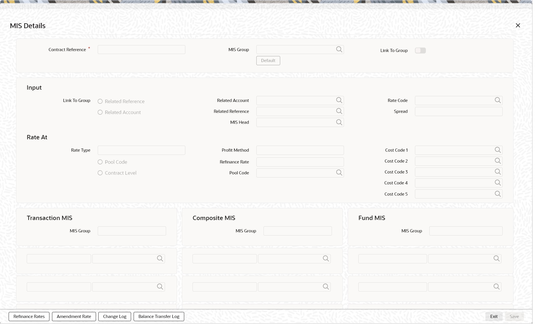

- On the Security Repo Contract Online screen, click MIS.
The MIS Details screen is displayed.
Figure 2-39 MIS Details
- On the MIS Details screen, specify the details as required.
For information on fields, refer the MIS User Guide.

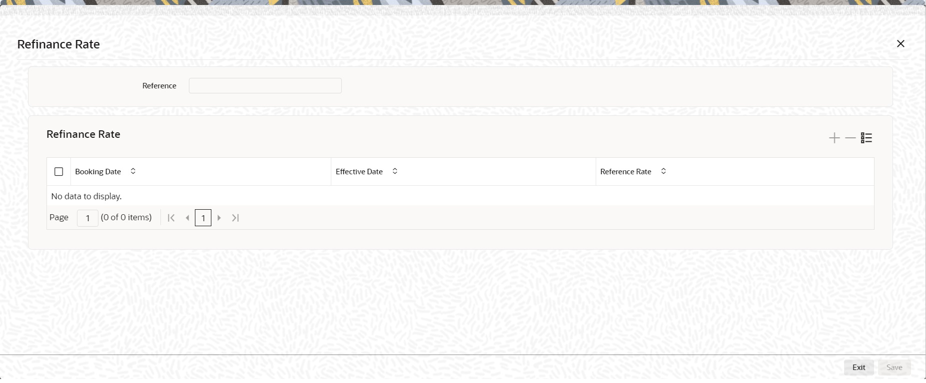

- On the MIS Details screen, click Refinance Rate.
The Refinance Rate screen is displayed.
- On the Refinance Rate screen, specify the details as required.

- On the MIS Details screen, click Change Log.
The Change Log screen is displayed.
- On the Change Log screen, specify the details as required.

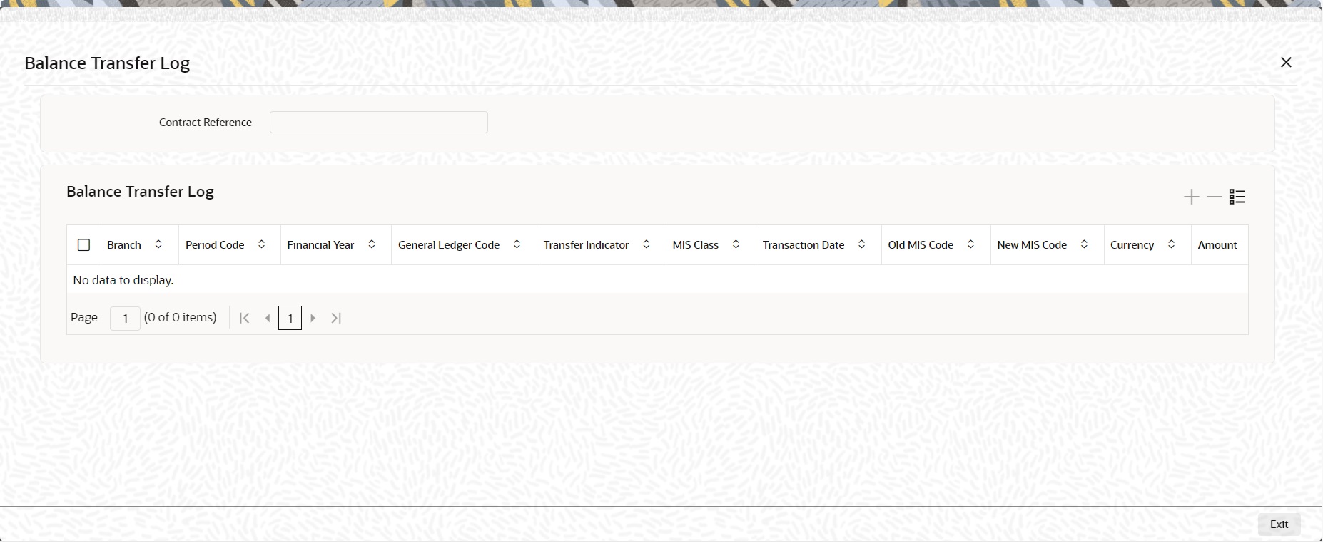

- On the MIS Details screen, click Balance Transfer Log.
The Balance Transfer Log screen is displayed.
- On the Balance Transfer Log screen, specify the details as required.

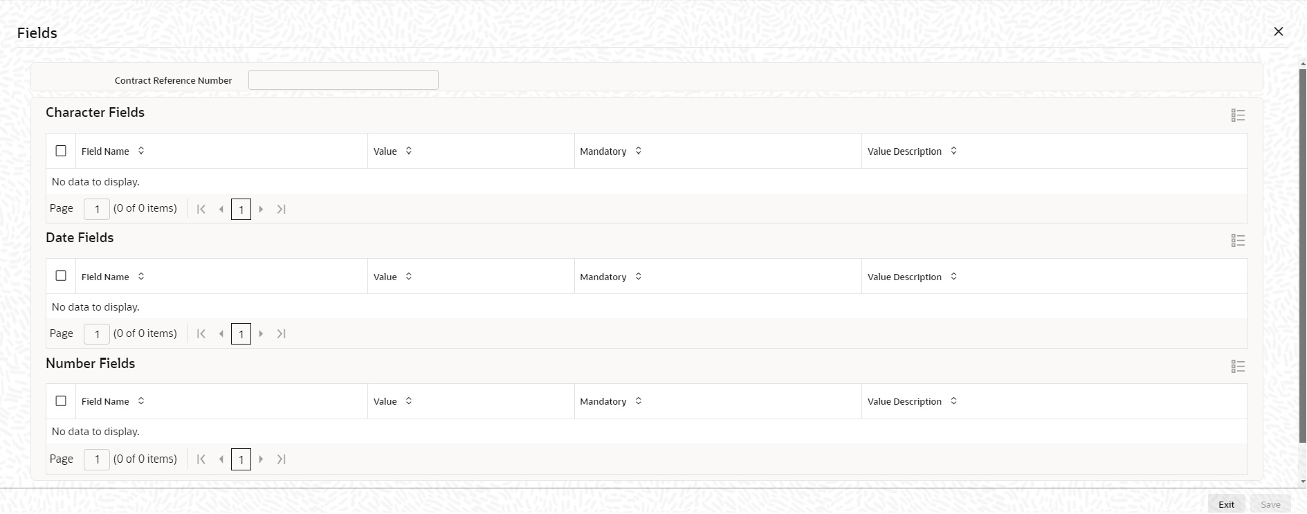

- On the Security Repo Contract Online screen, click Fields.
The Fields screen is displayed.
Figure 2-44 Fields
- On the Fields screen, specify the details as required.
Table 2-41 Fields - Field Description
Field Description Contract Reference Number
Displays contract reference number
Field Name
Defaults user defined field name mapped to the product
Value
Specify the UDF value
Mandatory
Defaults the mandatory flag from user defined maintenance screen
Value Description
Displays the user defined value description
- On the Security Repo Contract Online screen, click Linked Deal Details.
The Linked Deal Details screen is displayed.
- On the Linked Deal Details screen, specify the details as required.
Table 2-42 Linked Deal Details - Field Description
Deal Reference
Displays all linked deal reference number for the repo contract.
The options of Deal type are:
- Buy deal
- Sell deal
- Block deal
Margin Reference Number
Displays all the margin reference number created for the repo contract on margin processing
Version
Once the user clicks the Deal reference, system displays the leg reference version number
Leg Reference Number
Once the user clicks the Deal reference, system displays the leg reference number
Buy/Sell
Displays the leg type
- On the Linked Deal Details screen, click Messages.
User can view the MT5X message generated for a repo/reverse repo deal.
Treasury Messages Details screen is displayed.Figure 2-46 Treasury Messages Details
- On the Treasury Messages Details screen, specify the details as required.
Table 2-43 Treasury Messages Details - Field Description
Media
Displays the message media
Message Type
Displays the message type
Receiver
Displays Receiver ID.
Currency
Displays message currency
Amount
Displays the amount
Released
Displays the released status
Status
Displays current status of message.
Exception Code
Displays the exception code, if the message goes in exception
Exception Details
Displays the exception details.
Name
Displays the name of the receiver.
Address
Displays the receiver address.
- On the Treasury Messages Details screen, click View.Treasury Messages screen is displayed.
Figure 2-47 Treasury Messages
- On the Treasury Messages screen, specify the details as required.
Table 2-44 Treasury Messages - Field Description
DCN
Displays document reference number of a contract
Event Sequence Number or Version Number
Receiver or Sender
Displays Receiver or Sender ID.
Message Type
Displays the type of message.
SWIFT Message Type
Displays the Swift MT number of the message sent or received.
Sub Message Type
Displays the sub message type
Displays the Swift sub message type.
Message
Displays the Message view
Remarks
Displays the remarks
Reject Remarks
Displays the reject remarks.
Message Trailers
Displays the message trailers.

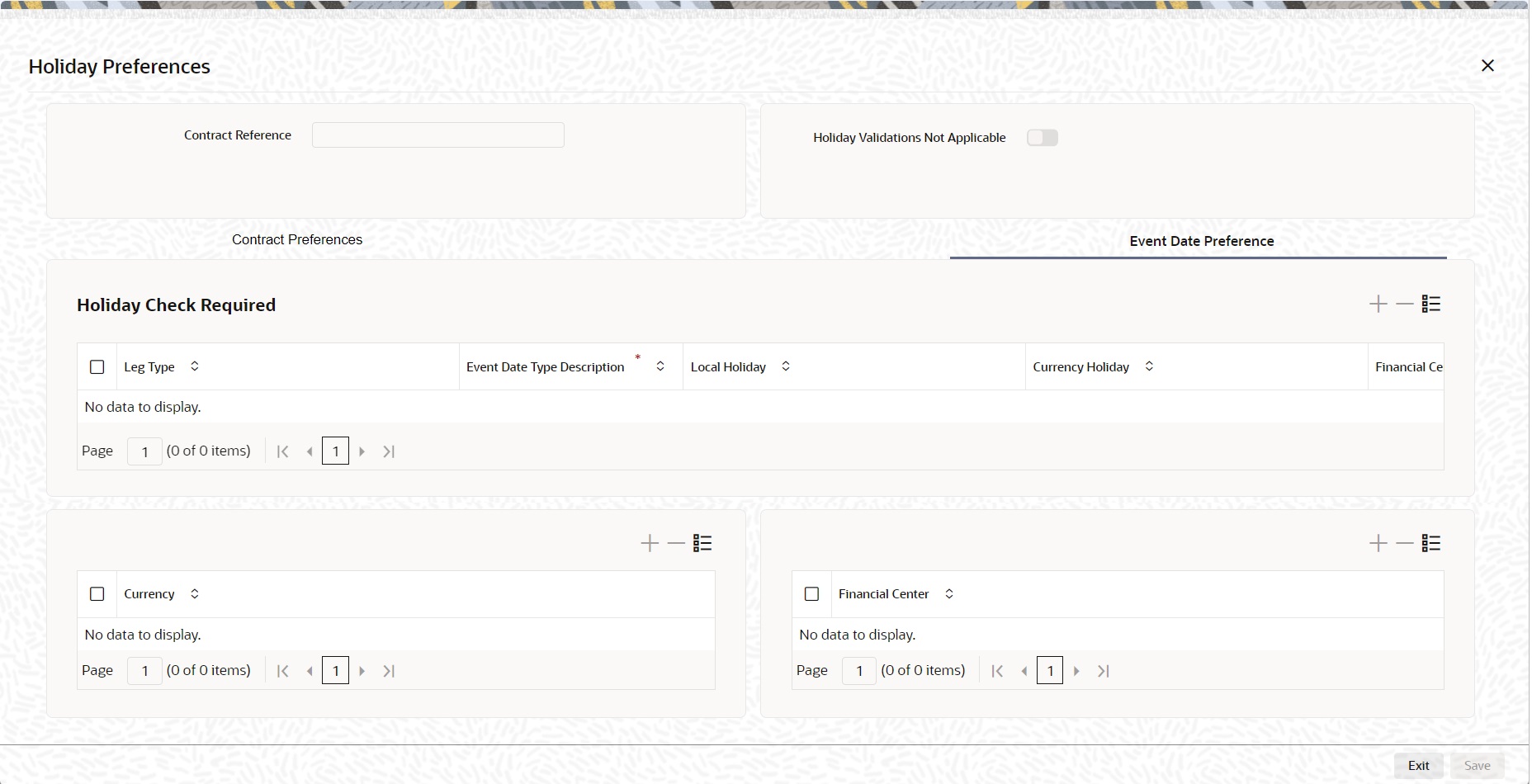

- On the Securities Repo Contract Online screen, click Holiday Preference.
Holiday Preference screen is displayed
- On the Holiday Preference screen, specify the details as required.
Table 2-45 Holiday Preference - Field Description
The Contract Reference number from the main screen is displayed here.
Holiday Validations Not Applicable
Check this box to indicate that the holiday calendar validation must not be performed.
Local Holiday
Select this check box, if the local holiday validation of dates and schedule movement is required, which is defaulted from product and amendable.
Currency Holiday
Select this check box, if the currency holiday calendar validation of dates and schedule movement is required, which is defaulted from product and amendable.
Financial Center Holiday
Select this check box, if the financial center holiday calendar validation of dates and schedule movement is required, which is defaulted from product and amendable.
Move Across Months
Check this box to indicate that the final date must be derived next month if the date falls on holiday. Otherwise, final date becomes end of the month though actual date derived is on next month.
Date Movement
Select the holiday date movement when the date falls on holiday. The adjoining drop-down list displays the following values:- Forward
- Backward
Currency
Specify the currency details for which the holiday validation for dates and schedules movement is required, which is defaulted from product and amendable.
Financial Center
Specify the financial center from the adjoining option list. The list displays all active financial centers maintained in the system. You can choose the appropriate one.
- On the Holiday Preferences screen, click Event Date PreferenceThe Holiday Preferences with Event Date tab details is displayed.
Figure 2-48 Event Date- Holiday Preferences
Description of "Figure 2-48 Event Date- Holiday Preferences" - On the Event Date Preference tab, specify the details as required.
The following are the field descriptions:
Table 2-46 Event Date Preference- Field Description
Field Description Leg Type
Select the leg type for the holiday preferences from the adjoining drop-down list. The list displays the following values:- In Leg
Event Date Type Description
Specify the description of event date type for which the holiday calendar validations must be performed. The adjoining option list displays all valid event description maintained in the system. You can choose the appropriate one.
Local Holiday
Select this check box if the local holiday validation of the dates and schedule movement has to be executed.
Currency Holiday
Select this check box, to execute the currency holiday calendar validation of the dates and movement of schedules.
Financial Center
Select this check box, to execute the financial center holiday calendar validation of the dates and movement of schedules.
Event Date Type
The event date type details is displayed in this field.
Move Across Months
Date Movement
Select the holiday date movement when the date falls on holiday. The adjoining drop-down list displays the following values:- Not Applicable
- Forward
- Backward
Currency
Specify the currency from the adjoining option list. The list displays all valid currencies maintained in the system. You can choose the appropriate one.
This field is mandatory if event date level currency holiday validation is required.
Financial Center
This field is mandatory if event date level financial center holiday validation is required.
Based on the requirement you can choose more than one holiday check at the same time.The Value Date, Maturity Date, Rate Revision Schedule Date, Rate Fixing Date and Interest Schedule date fields will be validated for Local, Currency and Financial Center holidays while Repo deal booking and the system displays an appropriate override message.
When any one or all of Rate Revision Schedule Date, Rate fixing date and Interest Schedule date falls on a holiday, then the date will be moved according to the date movement selected in ‘Event Preference’ tab, either Forward or Backward to a Business day.
When any one or all of Rate Revision Schedule Date, Rate fixing date and Interest Schedule date falls on a holiday and the date movement is selected as ‘Not Applicable’ in ‘Event Preference’ tab, an error message will be displayed and the date movement needs to be changed to ‘Forward’ or ‘Backward’.

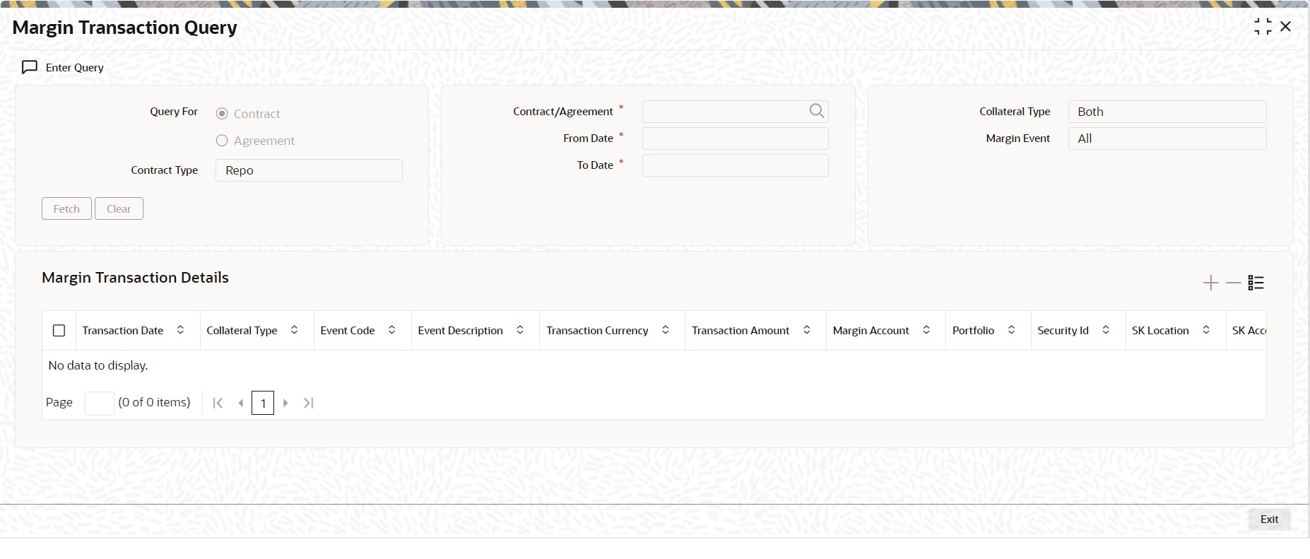

- On the Securities Repo Contract Online screen, click Margin Details.
Margin Transaction Query screen is displayed.
- On the Margin Transaction Query screen, Specify the details as required.
For information on fields, refer to the section 6.1.1.1 Margin Transaction Query screen in Collateral Margin and Settlement Netting User Guide
