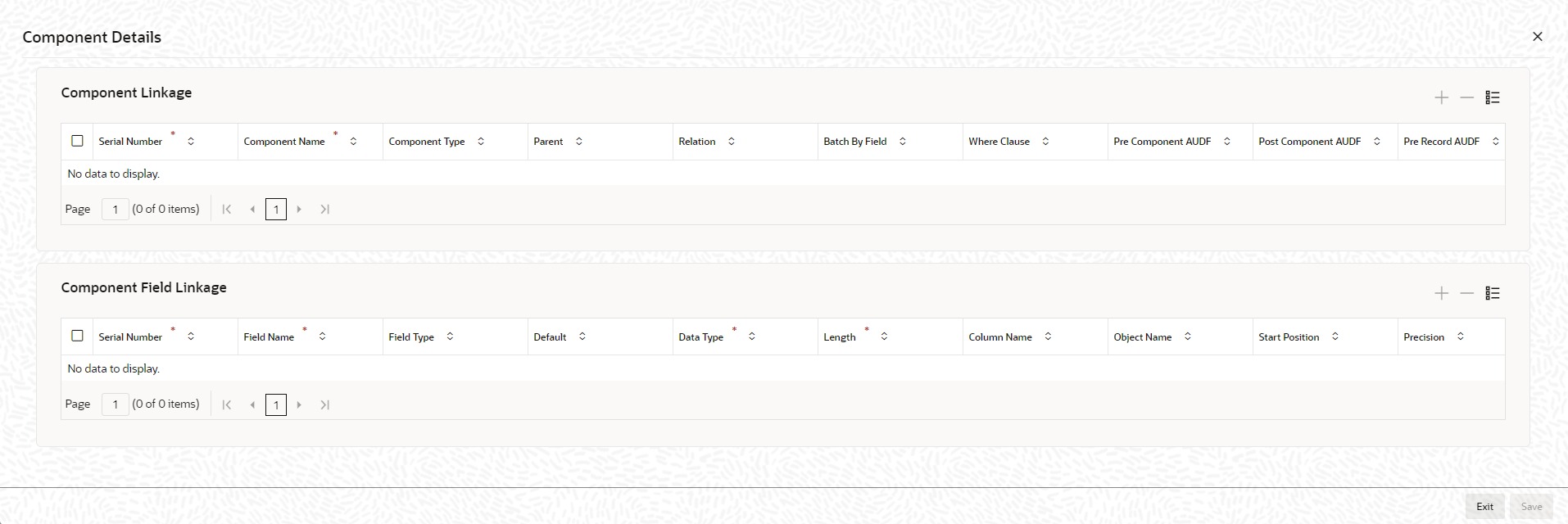

  1. On the Interface Definition screen, click Component Details.
    The Component Details screen displays.
  2. On the Component Details screen, specify the fields.
    Table 1-46 Component Details - Field Description
    Field Description
