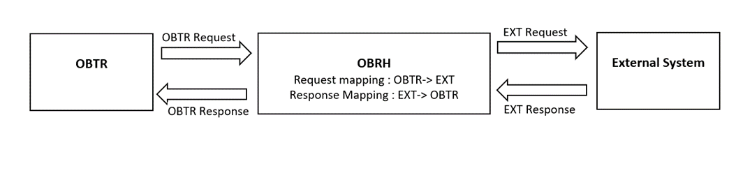

APIs are configured in OBTR through Oracle Banking Routing Hub (OBRH). These APIs were earlier configured to use the jars directly for the endpoint for different APIs like Utlization/ Genpaymessage, and so on. OBRH Enables seamless & standardized integrations between FSGBU Banking Products using configurations provided as part of the product Infrastructure.

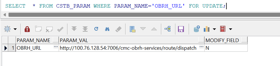

Cstb param needs to be updated with OBRH URL for Routing as shown in below image:
