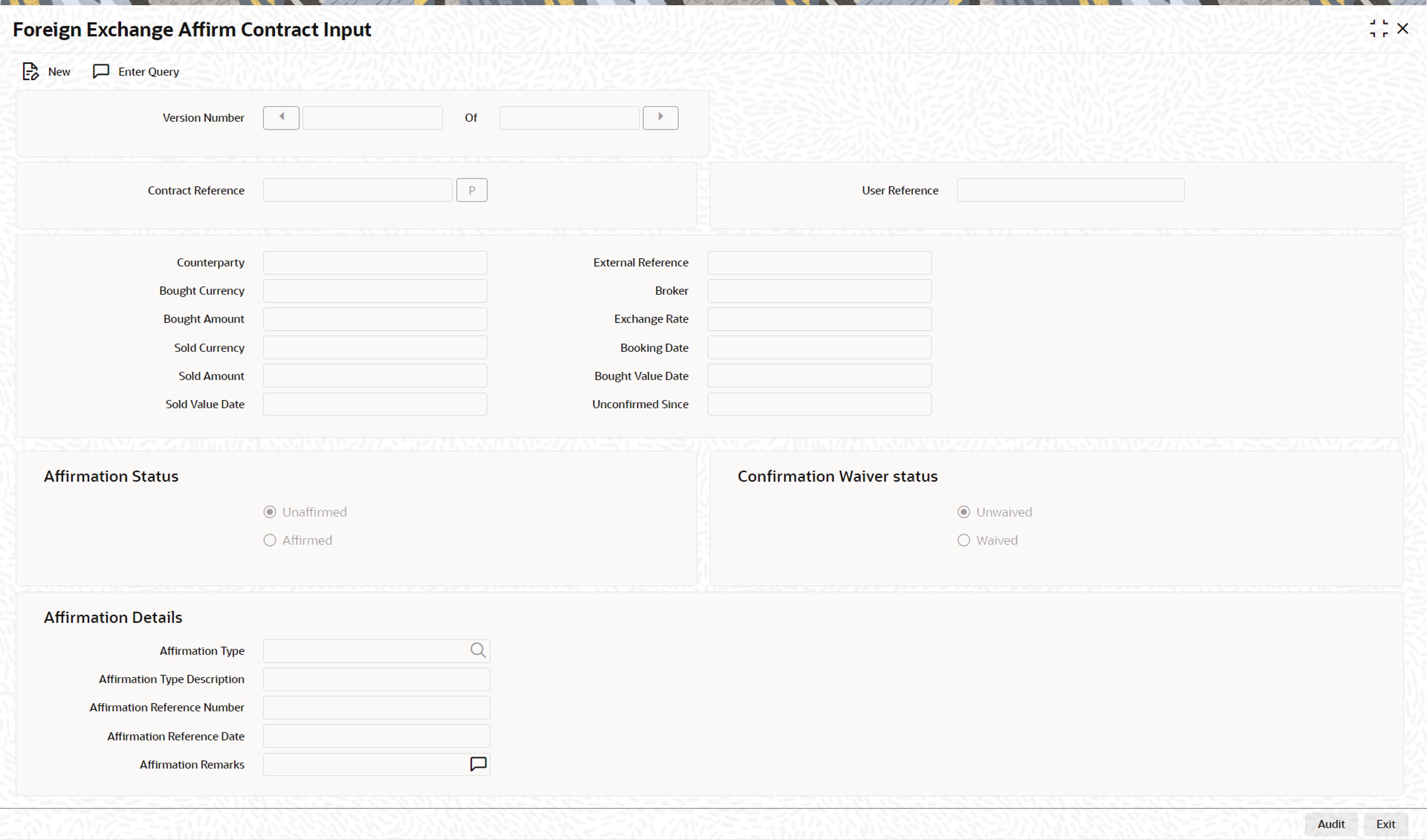

5.22 FX Affirmation Input Screen
You can affirm or un-affirm, waive or un-waive a deal from Foreign Exchange Affirmation contract Input screen.
  1. On the Home page, type FXDAFFRM in the text box, and click the next arrow.
    Foreign Exchange Affirmation contract Input screen is displayed.
    Figure 5-27 Foreign Exchange Affirmation Contract Input
    Description of fxdaffrm--cvs-main.jpg follows
    You can maintain only one contract record in Foreign Exchange Affirmation Contract Input screen.

    Table 5-24 Foreign Exchange Affirmation Contract Input - Field Description
    Field Description
    Affirmation Status
    Select the affirmation status of the FX deal. The options available are as follows:
    • Unaffirmed - If the status of the FX deal is not affirmed.
    • Affirmed - If the status of the FX deal is affirmed
    If the affirmation status is changed from unaffirmed to affirmed and the affirmation type or affirmation reference number is not specified then the system displays an error message
    Confirmation Waiver Status
    Select the FX deal confirmation waiver status. The options available are as follows:
    • Unwaived - If the FX deal is not waived off.
    • Waived - If FX deal is waived off.
    Modify either ‘Affirmation Status’ or ‘Confirmation Waiver Status’ at a time.
    Affirmation Type
    Specify the affirmation type. Alternatively, select the affirmation type from the option list. The list displays all valid affirmation type maintained in the system.
    Affirmation Type Description
    The system displays the description for the selected affirmation type.
    Affirmation Reference Number
    Specify the affirmation reference number.
    Affirmation Reference Date
    Select the affirmation reference date from the adjoining calendar.
    Affirmation Remarks
    Specify remarks, if any.
