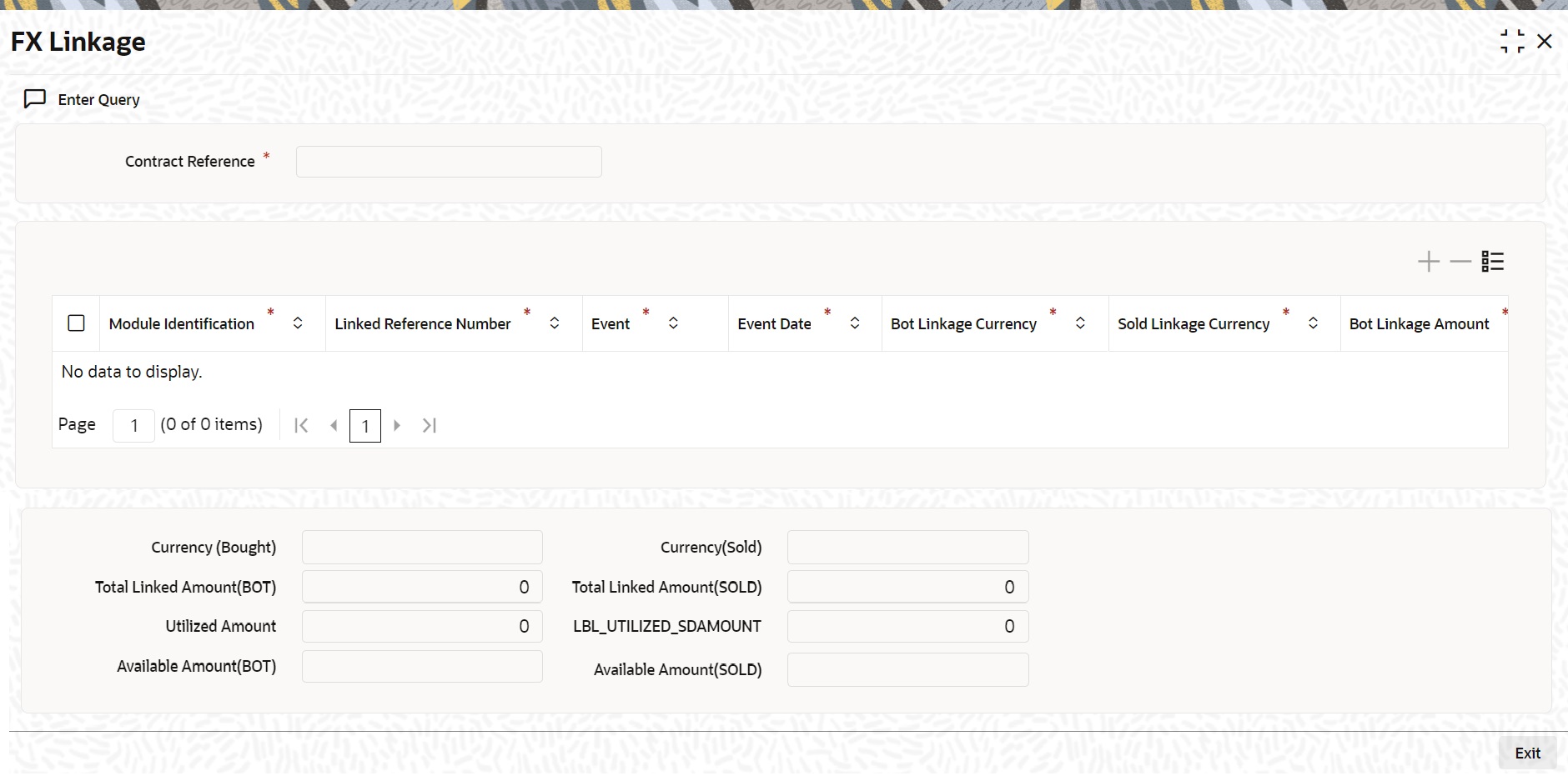

  1. On the Foreign Exchange Contract Online screen, click FX Linkages button.
    FX Linkage screen is displayed.
  2. Following details will be defaulted by the system:
    For more information on the fields, refer to the below table.
    Table 5-11 FX Linkage - Field Description
    Field Description

    The external application OBTF can select the following FX transactions:
    • Active and authorized forward FX transactions not marked for auto liquidation.
    • The FX forward contract cannot be a part of a combination product.
    • FX forward contract cannot have NDF feature
    • The settlement for the FX contract should not be through CLS.
    • FX contracts having netting agreement with counterparty should not be allowed.
    • FX contract should have the same bought and sold value date i.e., split value dates are not allowed.
    • Option date is mandatory for the forward FX deal, which is to be attached as linkage to external transactions.
    • Once the FX deal amount is fully availed the FX deal should not be available in LOV fetch and cannot be linked further towards other transactions.
    • Once the FX deal amount is fully utilized the FX deal should not be available in LOV fetch and cannot be linked further towards other transactions.
