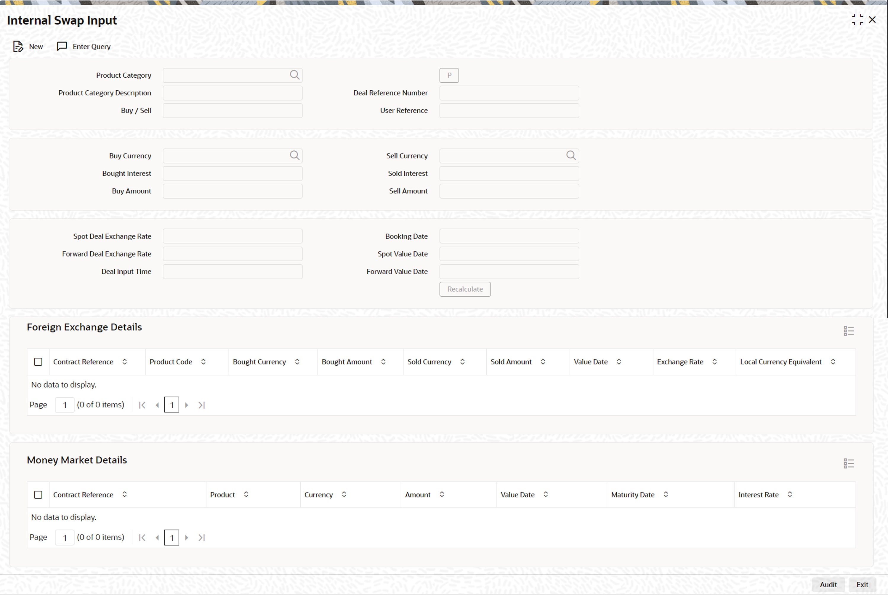

Define internal swap transactions through the Internal Swap Transactions screen. An Internal swap transaction is a combination of FX and MM transactions generated for a deal between the FX desk and MM desk.
  1. On the Home page, type FXDSWPIN in the text box, and click next arrow.
    Internal Swap Input screen is displayed.
    Figure 5-28 Internal Swap Input
    Description of fxdswpin--cvs-main.jpg follows
  2. Click New on the Internal Swap Input screen and specify the details as required. Click Save to save the details, or click Cancel.
    For information on fields, refer to xref.

    The screen will also display the individual transactions created in detail blocks upon authorization of the internal swap input transaction. Three FX transactions created will be created within a single block and two MM transactions will be created in the other.
