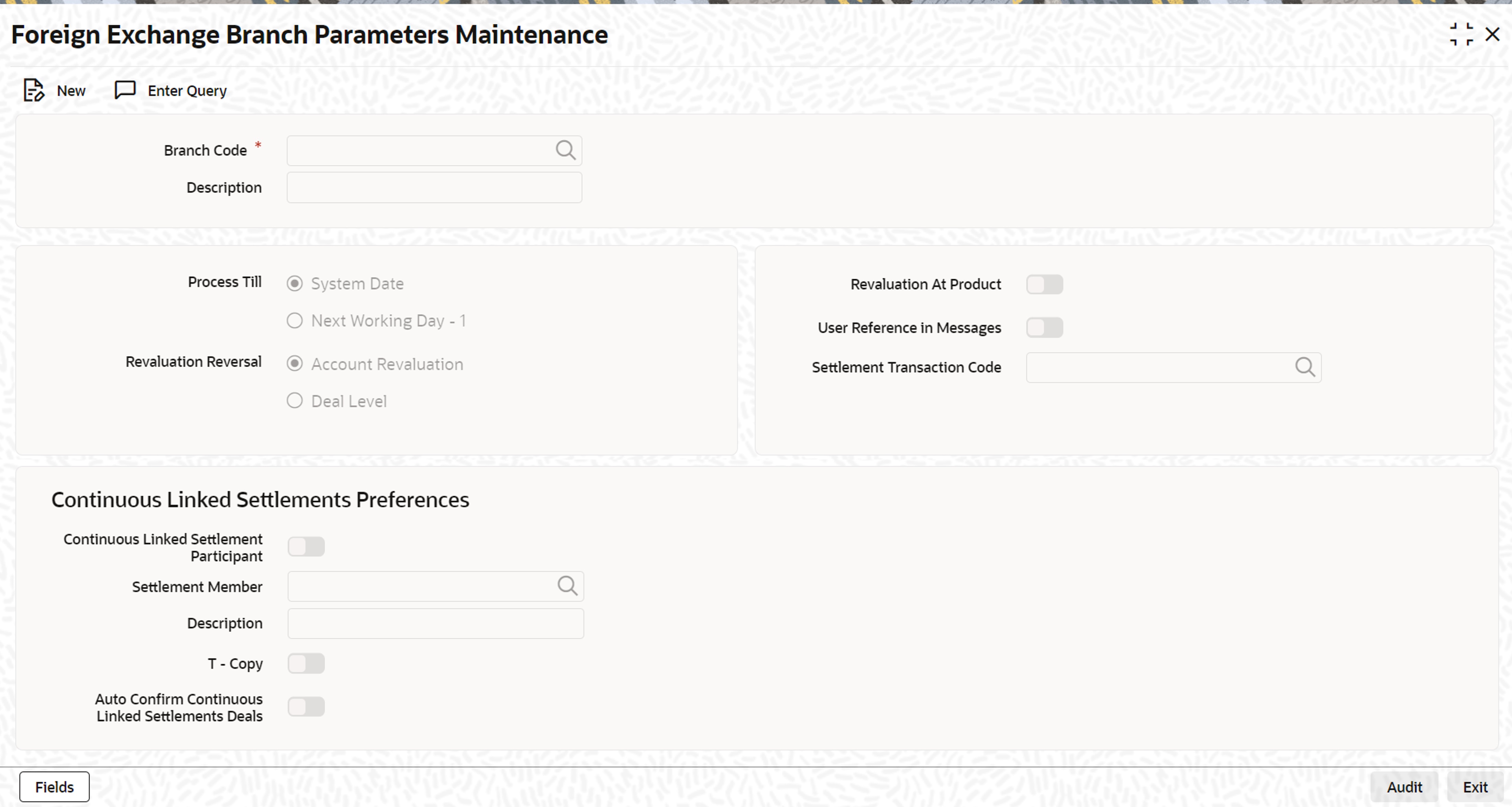

  1. On the Homepage, type FXDBRMNT in the text box, and click the next arrow.
    Foreign Exchange Branch Parameters Maintenance screen is displayed.
    Figure 6-1 Foreign Exchange Branch Parameters Maintenance
    Description of fxdbrmnt--cvs-main.jpg follows
  2. On the Foreign Exchange Branch Parameters Maintenance screen, specify the details as required.
    The branch code, with the name of the branch for which the preferences are maintained, is defaulted in the screen.
    For information on fields, refer to the below table.

    CLS participant
    You have to select this option to identify the branch as a CLS participant. This will enable you to process the FX deals entered into at your branch via the CLS bank.
    Only after you mark the branch as a CLS participant, you will be allowed to maintain the following CLS preferences.
    Settlement Member
    Here, you have to select the BIC Code of the customer who will be the intermediary /settlement member through whom the FX deals of your branch will be routed to the CLS bank. The Messaging System of Oracle Banking Treasury Management will identify this customer as the receiver of the MT 304 (Confirmation Message/ Advice of a Third Party deal).
    T- Copy
    This is applicable if the counterparty is a SWIFT member. If you specify that ‘T-Copy’ is required, the SWIFT media will send the CLS Confirmation Message (MT300) to the counterparty of the deal with a copy to your settlement member. If multiple addresses are maintained, MT300 is sent to the location, marked as the counter party’s primary address.
    If the third party does not subscribe to T-copy or if the counterparty is not a SWIFT member, Oracle Banking Treasury Management will automatically generate the MT304 message and identify the BIC of the Settlement Member (where your branch is the Third Party participant) as the receiver of the message. In such a case, MT300 is a normal confirmation, which is sent to your counterparty if it is a SWIFT subscriber.
    If you check T - Copy, the system will include the TPS identifier in MT300 message for CLS NDF deals. However, the system will not generate MT304 message for the message type FS_FMCONF.
    Auto-Confirm CLS Deals
    You may select this option to enable the system to automatically confirm the CLS deals processed at your branch automatically. In this case, the system will ignore the MT300 received from the counterparty and mark the confirmation status as Confirmed.
