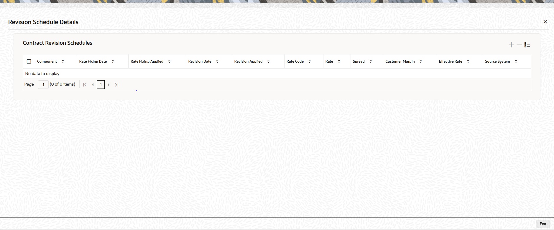

  4. On Money Market Contract Input screen, click Revision details.
    Revision Schedule Details screen is displayed.
    Figure 4-6 Revision Schedule Details
    Description of mmdtronl--cvs-rev-schedule-details.jpg follows
  5. View the details of the revision schedules for a particular deal.
    In this screen you can see the following details for the component:
    • Rate Fixing date
    • Rate fixing applied
    • Revision date
    • Revision Applied
    • Rate Code
    • Rate
    • Spread
    • Customer Margin
    • Effective rate
    • Source System
    Note that the system generates the SGEN only when the rate fixing applied option is Y for all the revision schedules.
