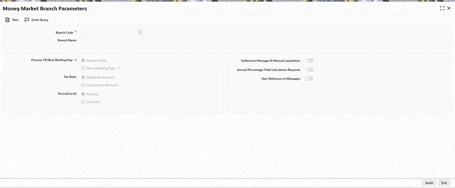

  1. On the Home page, type MMDBRMNT in the text box, and click the next arrow.
    Money Market Branch Parameters screen is displayed.
    Figure 8-1 Branch Parameters
    Description of lddbrmnt--cvs-main.jpg follows
  2. On the Branch Parameters screen, click New.
  3. On the Branch Parameters - New screen, specify the details as required.
  4. Click Ok to save the details or Exit to close the screen.
    For information on fields, refer to the below table.
