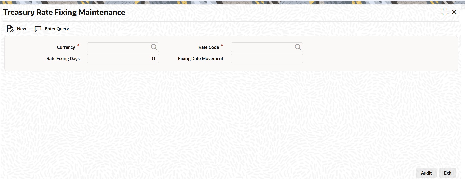

  1. On the Home page, type TRDRTFXD in the text box, and click the next arrow.
    The Treasury Rate Fixing Maintenance screen is displayed.
    Figure 4-29 Treasury Rate Fixing Maintenance
    Description of trdrtfxd-cvs-main.jpg follows
  2. On the Treasury Rate Fixing Maintenance screen, Specify the details as required.
