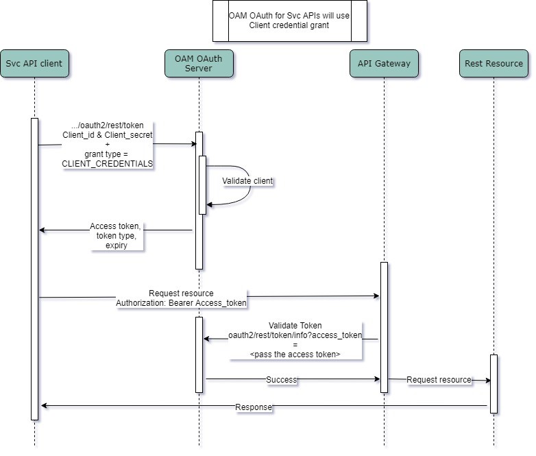

The flow is depicted below
- API clients pass the client id & client secret and grant
type as CLIENT CREDENTIALS. To get the access token, use the endpoint
/oauth2/rest/token. - API clients passes the access token in the authorization header as bearer token in their subsequent calls to access the Service API's.
- API Gateway validates the client access token on OAM Authorization server.
- If valid, it passes the request onto the Svc API's and gets the response.
- The client can refresh to get a new token before the current token expires. If the token expires, they can pass the client ID and client secret to get a new token.

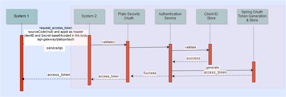

The flow for token generation is depicted below:
Figure 1-2 OAuth without OAM - Token Generation flow

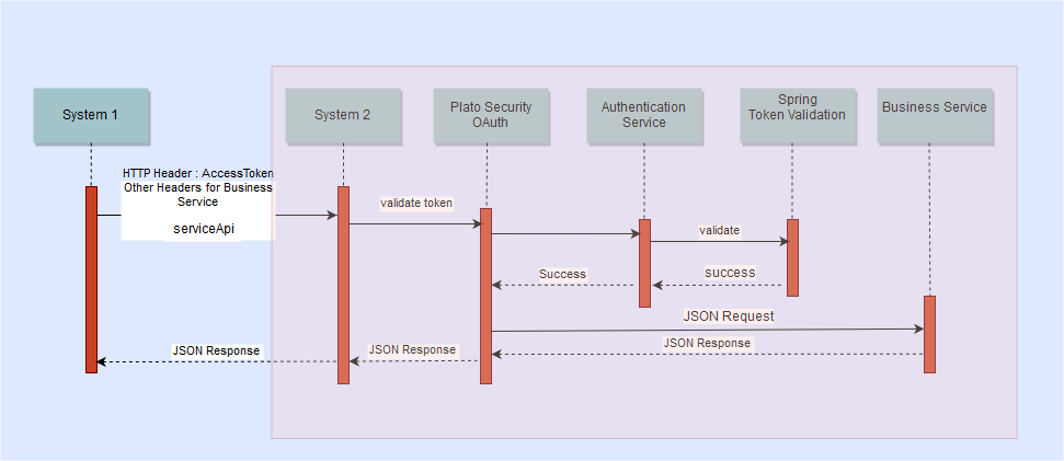

The flow for accessing svc is depicted below:
Figure 1-3 OAuth without OAM - Accessing svc flow
- API clients passes the client id & client secret in the
body and other required headers. To get the access token, use the below
endpoint.
http://<<hostname>>:<<port>>/api-gateway/platojwtauth/. - API clients passes the access token in the authorization header as bearer token in their subsequent calls to access the Service API's.
- API Gateway validates the client access token on Authorization server.
- If valid, it passes the request on to the Svc API's and gets the response.
- The client can refresh to get a new token before the current token expires. If the token expires, they can pass the client ID and client secret to get a new token. Additional facility of increasing the tokens are also provided.
