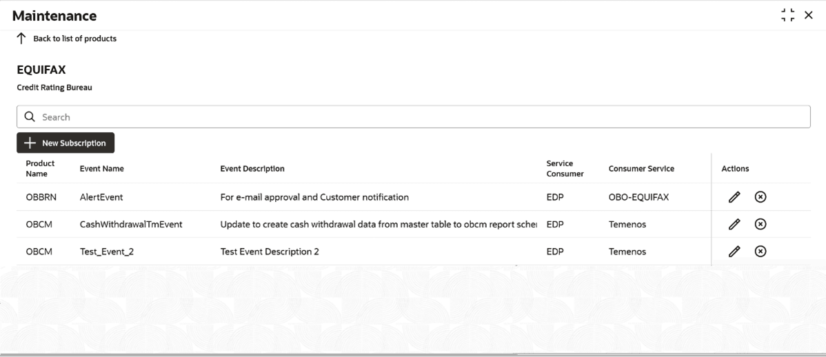

  3. click on the View Subscribed Events to view the subscribed events for an external product.
    The View Subscribed Events screen displays.
    Figure 4-2 View Subscribed Events
    Table 4-2 View Subscribed Events - Field Description
    Field Description
    Product Name Displays the name of the product.
    Description Displays the description of the product.
    Event Name Displays name of the event published under the selected internal product.
    Event Description Displays description of the event published under the selected internal product.
    Service Consumer Displays name of the service consumer for the selected subscribed event.
    Consumer Service Displays the consumer service details for the selected subscribed event.
