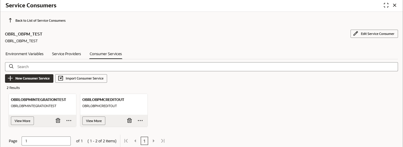

  1. On Service Consumers screen, click Consumer Services.
    The Consumer Services screen is displayed.

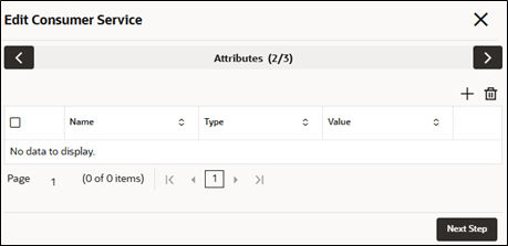

  2. Click Next Step
    The Edit Consumer Service - Attributes screen is displayed.
    Figure 7-7 Edit Consumer Service - Attributes
