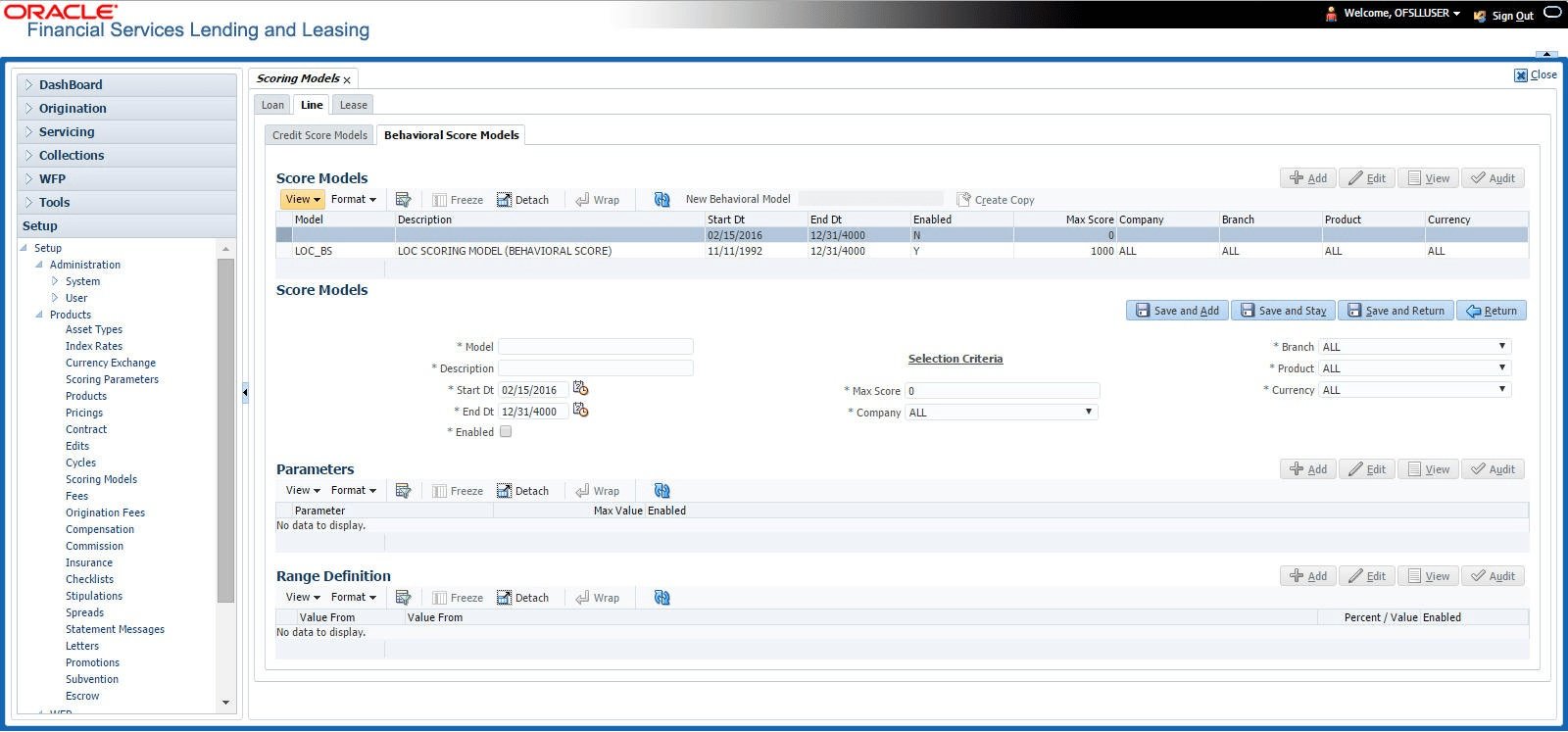

4.6.1 Behavioral Score Models
You can either define new Behavioral Score Model details or specify a new name in the New Behavioral Model field and click Create Copy to create a copy of selected score model with details.
  1. Click Setup > Setup > Administration > User > Products > Scoring Models > Loan > Behavioral Score Models.
  2. In the Score Models section, perform any of the Basic Operations mentioned in Navigation chapter.
    Figure 4-7 Behavioral Score Models
    Behavioral Score Models - Loan
