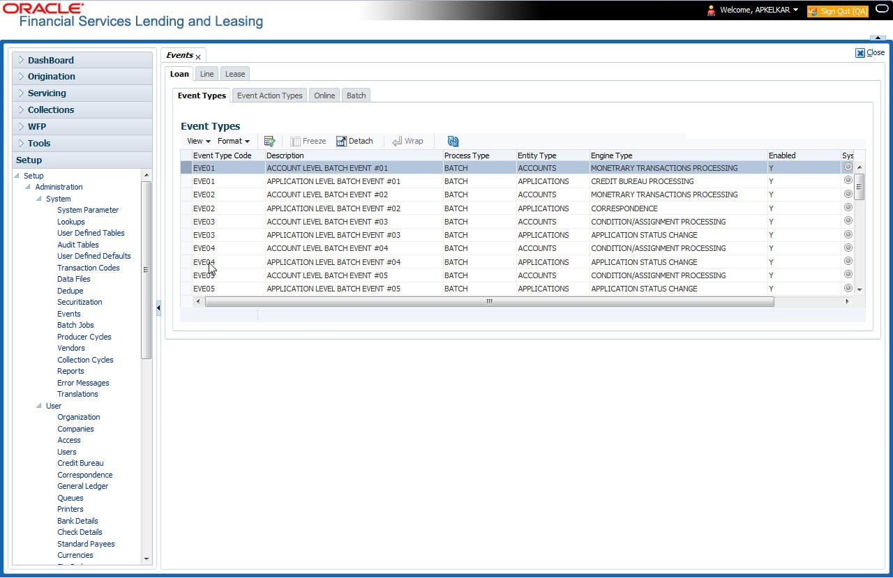

2.11.1.1 Event Types
  1. Click Setup > Setup > Administration > System > Events > LoanLine of creditLease > Events Types.
  2. In the Event Types tab, you can view the existing events and its details maintained in the system.
A brief description of the fields is given below:
Table 2-39 Event Types
Field Do this
Event Type Code View the event type code.
Description View the event description.
Process Type View the event action processing type (BATCH or ONLINE).
Entity Type View the entity type (ACCOUNTS or APPLICATIONS).
Engine Type View the engine type (MONETARY TRANSACTIONS PROCESSING, NON-MONETARY TRANSACTION PROCESSING, CONDITION/ASSIGNMENT PROCESSING, APPLICATION STATUS CHANGE, CREDIT BUREAU PROCESSING, LETTERS PROCESSING or CORRESPONDENCE).
Enabled Y indicates event type is enabled and N indicates disabled.
System Defined If Yes indicates that the event type is system defined. If No indicates that the event type is user defined.
