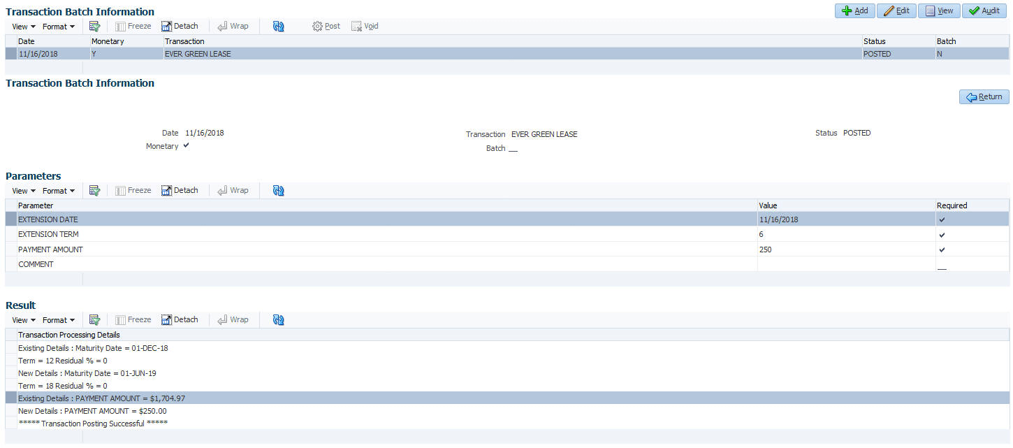

Table A-69 To post ever green lease transaction
| Transaction | Parameters |
| EVER GREEN LEASE | EXTENSION DATE |
| EXTENSION TERM | |
| PAYMENT AMOUNT | |
| COMMENT |
- Specify the extension date as either current transaction posting date or a future date. However, system does not allow to post a backdated transaction.
- Specify the extension term which is agreed term between customer and financial institution.
- Specify the payment amount which is rental amount for asset usage.
- Specify additional details (if any) in comment field.
On successfully posting the transaction, the Results section displays the details of old and new Maturity Date, Term, Payment Amount and the Residual % is set as zero. The lease receivables are updated with new amount (calculated as New Payment Amount x Term) in Servicing > Balances tab and new repayment schedule is generated.
