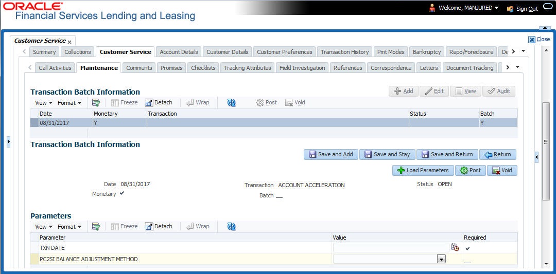

You can accelerate only those accounts which are in ACTIVE status and post the transaction either manually in the Customer Service > Maintenance screen or through Web Service (generic post transaction service).
Figure A-53 Account Acceleration

Transaction Parameters Description
ACCOUNT ACCELERATION TXN DATE
Select the date from which the acceleration is effective on the account. The same can either be the current date or a back date (up to contract date or account back date whichever is higher) but not a future date.
The selected date will be the acceleration start date and the new maturity date of the account.
