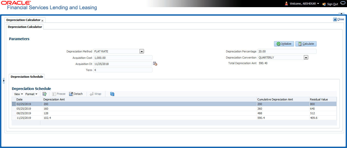

The Depreciation Calculator screen facilitates you to simulate depreciation calculation of an asset based on asset acquisition cost and using specific depreciation method, frequency and term. Further, you can view the depreciation amortization schedule based on calculation.
Depreciation Calculator is a standalone tab and information calculated here can only be viewed. They cannot be copied to the application / contract.
If you want to clear (or “refresh”) the Depreciation Calculator at any time, click Initialize in the Parameters section.

  1. On the Oracle Lending and Leasing home screen, click Tools > Tools > Depreciation Calculator.
    Figure 11-4 Depreciation Calculator
  2. In the Parameters section, complete the following fields:

  3. In the Parameters section, click Calculate to view the results. System displays the total depreciation amount for the simulation values along with the Depreciation Schedule in below sub tab.
  4. The Depreciation Schedule sub tab displays the following details:
    • Date - depreciation date for the selected cycle
    • Depreciation Amt - calculated depreciation amount for the cycle
    • Cumulative Depreciation Amt - calculated depreciation amount till date
    • Residual Value - residual value for the corresponding cycle calculated by Acquisition Cost - Cumulative Depreciation Amt
