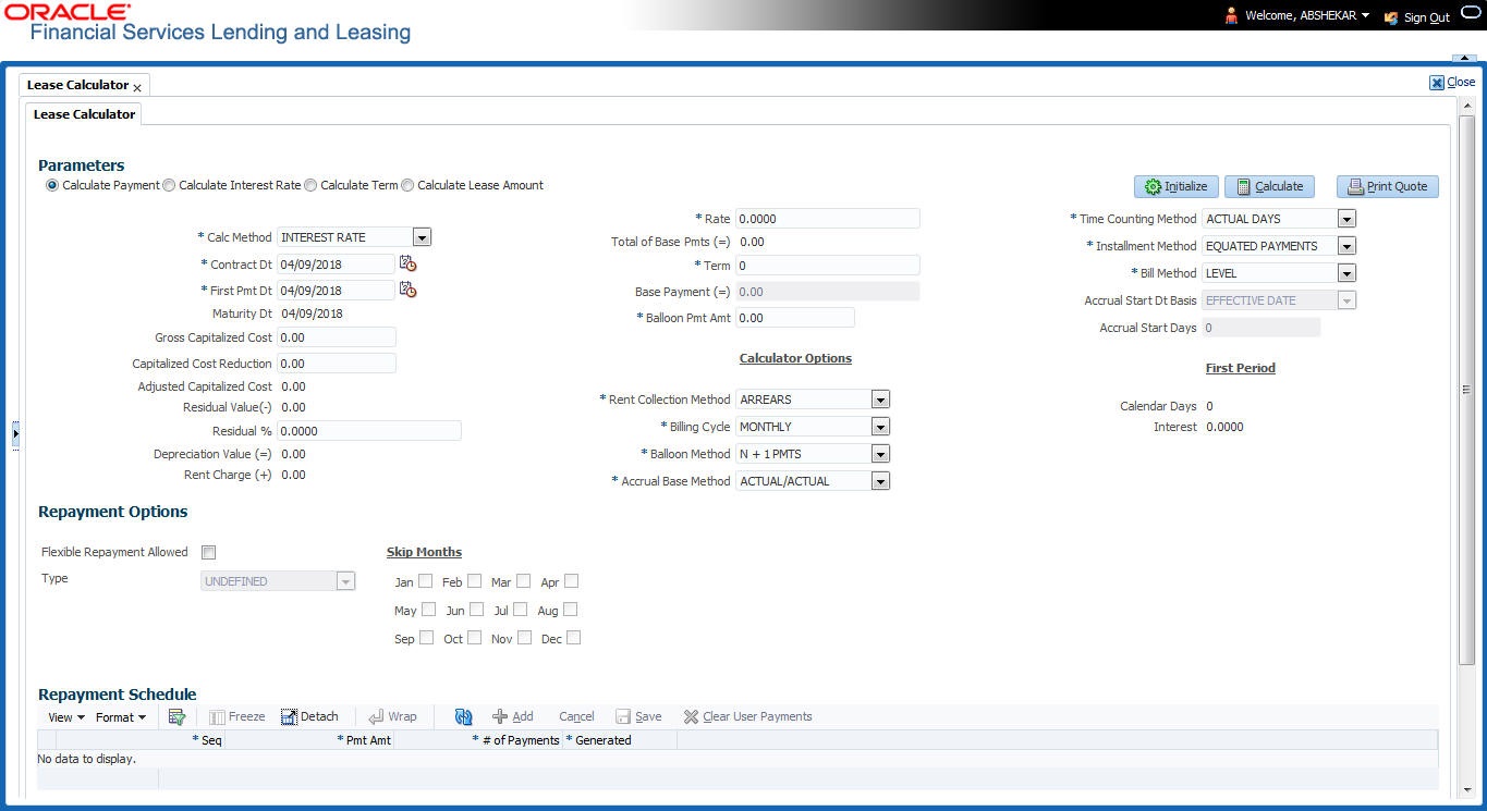

To calculate a lease payment
  1. On the Oracle Lending and Leasing home screen, click Tools > Tools > Lease Calculator.
  2. In the Parameters section, Calculate Payment option is selected by default and the lease calculation method as Rent Factor. Select the required calculation method and the calculation parameter to display the applicable fields in Lease Calculator screen.
  3. In the Lease Details section, complete the following fields:

    Calculator Options section
    Note: Except for Rent Collection Method (as Advance or Arrears), the other fields in this section are available only for Interest Rate type of lease calculation method and the default values are populated from Setup > Contract screen. Also the Rent Collection Method field is view only for Rent Factor calculation method.

  4. In the Lease Calculator section, click Calculate to view the results. You can further proceed with below sections to define flexible repayment options, repayment/rate schedule and generate amortization schedules.
