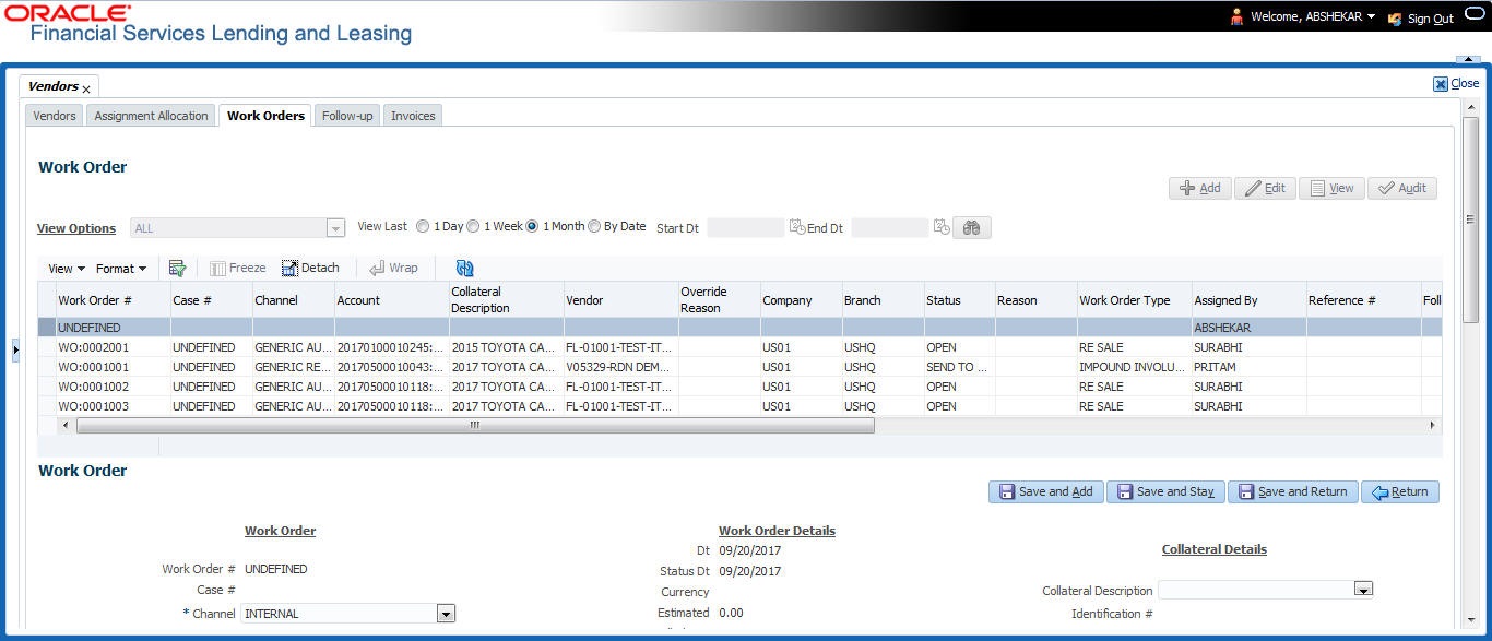

14.3 Work Orders Tab
The Work Orders link allows you to assign an account to a vendor for a service that the vendor provides, view the history of work order changes and define tracking attributes.
  1. Click CollectionOriginationServicing > CollectionOriginationServicing > Vendors > Work Order. The details are grouped under three tabs:
    • Services
    • Work Order History
    • Tracking Attributes
  2. In the CollectionOriginationServicing > CollectionOriginationServicing > Vendors > Work Order > Work Order, sort the list of work orders based on status using the View Options drop- down list. You can further sort the list of work orders based on elapsed days by selecting the View Last option as 1 Day / 1 Week / 1 Month / By Date. When By Date is selected you can specify a date range (within 3 months) in Start Dt and End Dt fields using the adjoining calendar and clicking Search.
  3. Perform any of the Basic Operations mentioned in Navigation chapter.
