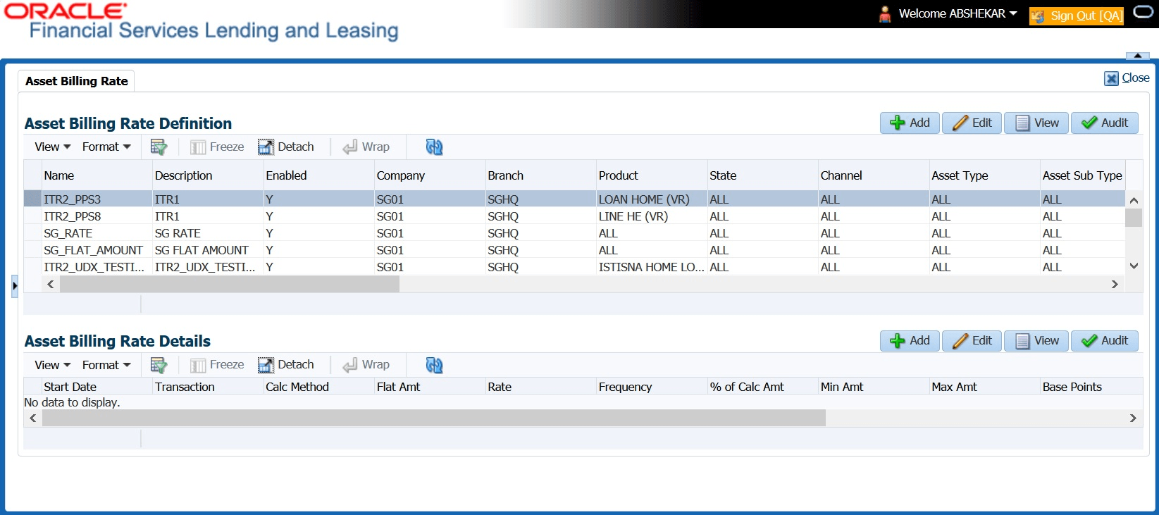

4.13.1 Asset Billing Rate Definition
In the Asset Billing Rate Definition tab you can create and maintain Timeshare specific Home collateral and account details of an account which are used as a selection criteria.
To set up Asset Billing Rate Definition
  1. On the Oracle Financial Services Lending and Leasing home screen, click Setup > Setup > Administration > User > Products > Asset Billing Rate.
  2. In the Asset Billing Rate Definition section, perform any of the Basic Operations mentioned in Navigation chapter. A brief description of fields are given below:
    Table 4-48 Asset Billing Rate Definition
    In this field Do this
    Name Enter a unique name for Asset Billing Rate definition. This field is not editable after saving the record or during EDIT.
    Description Enter the description for Asset Billing Rate definition.
    Enabled Check this box to enable the record.
