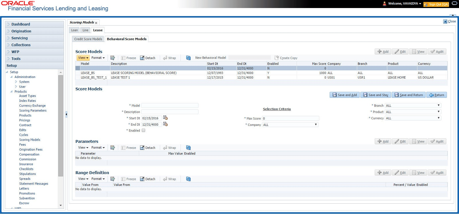

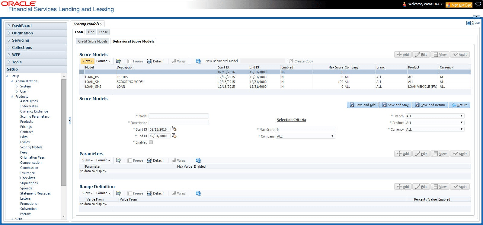

    Behavioral Score Models - Loan

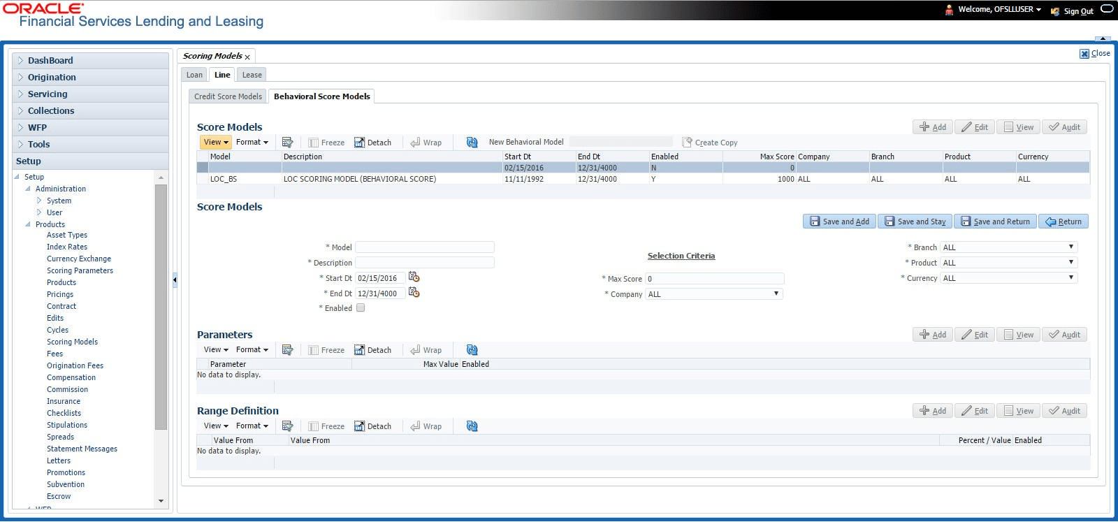

    Behavioral Score Models - Line

    Behavioral Score Models - Lease
