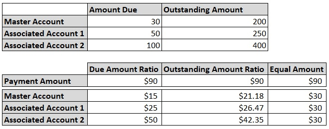

| EQUAL AMOUNT |
To allocate payment equally to all the accounts picked. This is traditional method of payment allocation in which the total payment amount received is divided and adjusted equally to all customer linked accounts. |
| DELQ DUE AMOUNT RATIO |
To allocate payment based on the ratio of amount due on all accounts. In this method, the due accounts are identified based on the defined selection criteria and the payment appropriation is done on the ratio of amount due on each account using the below formula. Following is an illustration on payment allocation: |
| DUE AMOUNT RATIO (INCLUDING CURRENT DUE) |
To allocate payment by including the existing unpaid delinquent due amount of pre-bill days on all accounts. This is calculated as: (Single Account Total Due Amount Ratio (Including Current Due) * Payment Amount) / All Accounts Total Due Amount Ratio (Including Current Due) The value is derived from lookup code DUE_RATIO_CUR_DUE. |
| OUTSTANDING BALANCE RATIO |
To allocate payment based on the ratio of total outstanding due on all accounts. Similar to above, even in this method the due accounts are identified based on the defined selection criteria and the payment appropriation is done on the ratio of outstanding amount due on each account using the below formula. This method can be selected if the received payment amount is equal to total outstanding due on all linked accounts indicated in Customer Service > Transaction History > Balances screen. |
| ACCOUNT COLUMN BASE |
To allocate payment based on hierarchy order. In this method, the due accounts are identified based on the defined selection criteria and the payment appropriation is done as per the sequence of due accounts defined either in ascending/descending order. |
