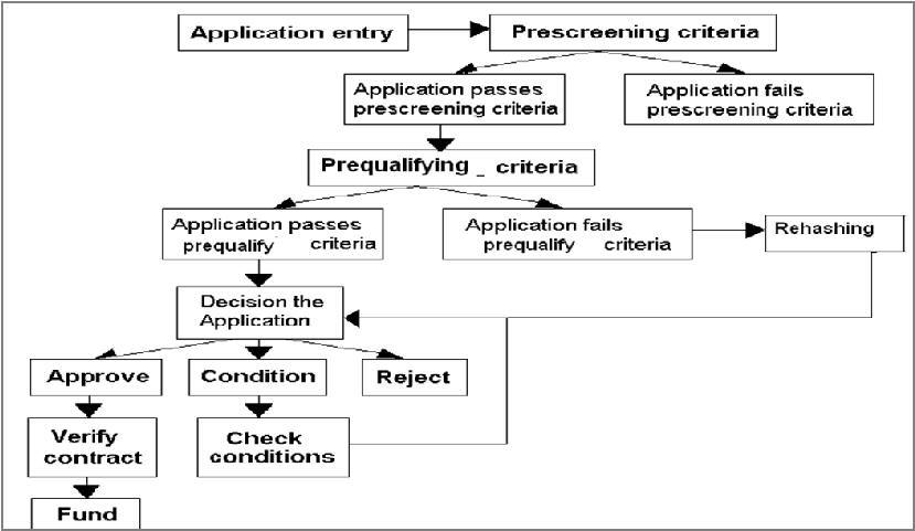

The following diagram displays the general concept of workflow:
Figure 4-18 Application Entry - Flowchart

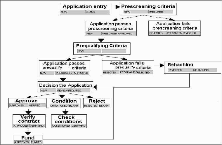

Using these status and sub status, let us re-examine the early workflow diagram in this section.
Figure 4-19 Application Entry - Flowchart 2

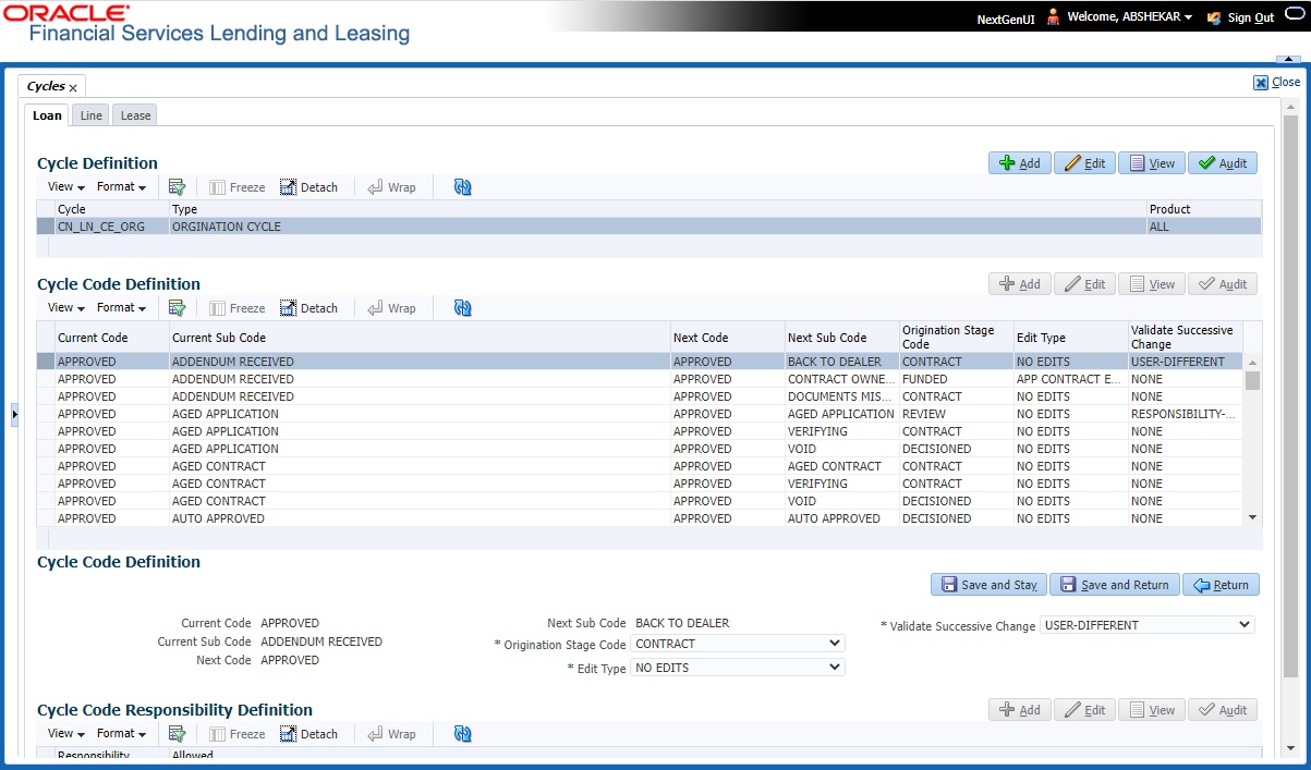

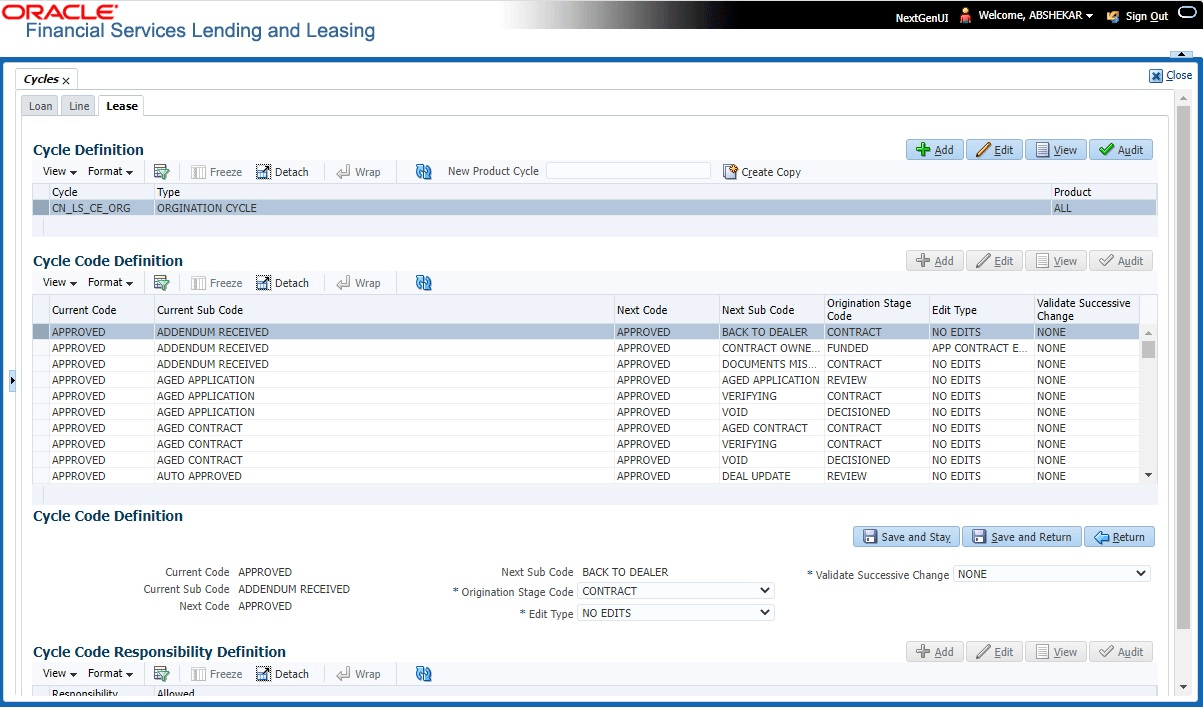

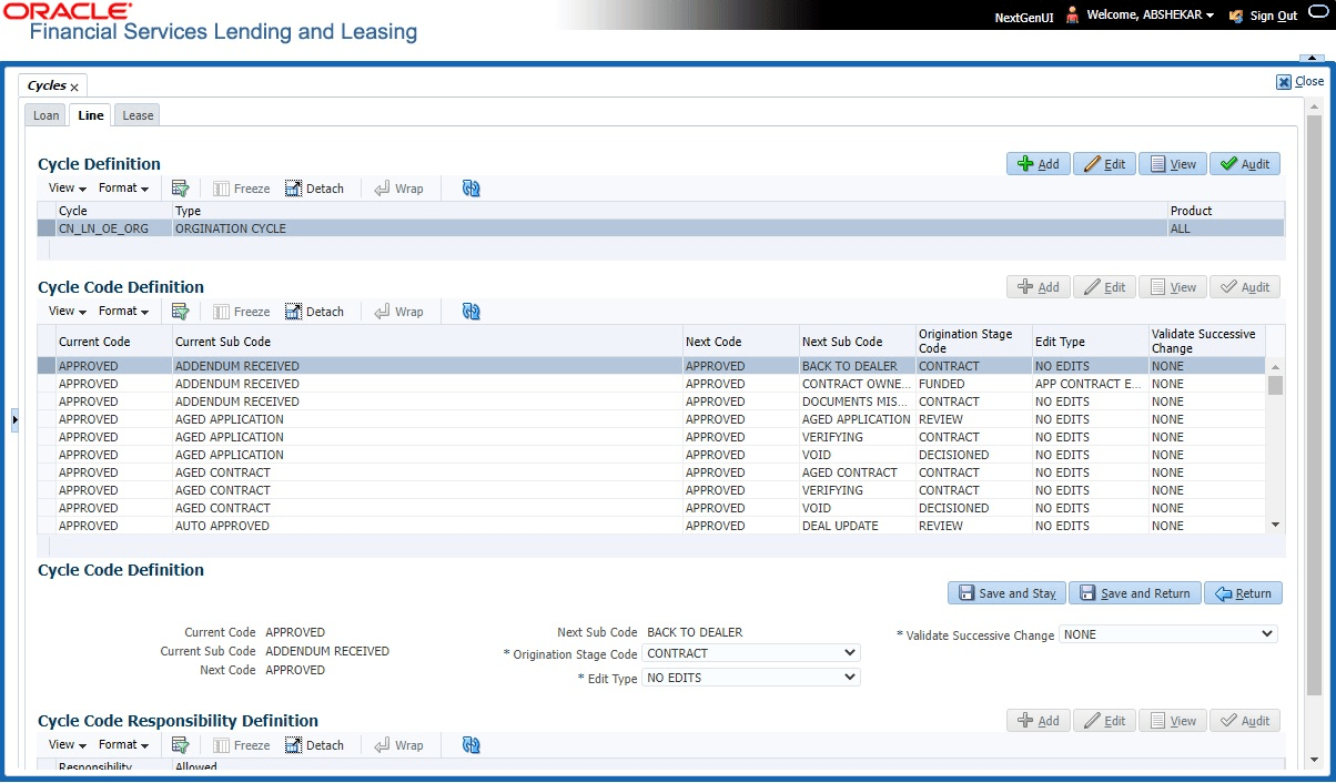

  1. On the Oracle Financial Services Lending and Leasing home screen, click Setup > Setup > Administration > User > Products > Cycles > LoanLineLease.
  2. While defining new cycle definition, you can make use of copy feature to quickly create new cycle using the existing cycle definition details. Click on the required record in Cycle Definition section and specify the product name (available in Products setup screen) in New Product Cycle field. Click Create Copy. New cycle definition is created with selected cycle setup details but without user responsibility.
  3. In the Cycle Definition section, perform any of the Basic Operations mentioned in Navigation chapter.
    A brief description of the fields is given below:
    Table 4-37 Cycle Definition
    Field Do this
    Cycle Specify the cycle code.
    Type Displays the cycle type.
    Product Select the product from the drop-down list.
  4. In the Cycle Code Definition section, perform any of the Basic Operations mentioned in Navigation chapter.
    Table 4-38 Cycle Code Definition
    Field Do this
    Current Code Select the current code to transition FROM, from the drop-down list.
    Current Sub Code Select the current sub code to transition FROM, from the dropdown list.
    Next Code Select the current code to transition TO from the drop-down list.
    Next Sub Code Select the next sub code to transition TO, from the drop-down list.
    Origination Stage Code Select the origination stage code of the application from the adjoining drop-down list.
    Edit Type Select the edit type to associate to the cycles, from the drop-down list.

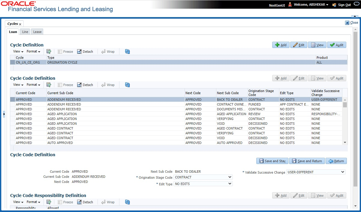

    Validate Successive Change
    Select the type of user / responsibility who is permitted to perform application status change. The following options are available in the drop-down list as maintained in the Lookup Type STATUS_ CHANGE_VALIDATION_CD.
    NONE: (Default option) Here system does not validate for User / Responsibility while making status change.
    USER - SAME: Here system validates for same User while making the status change.
    USER - DIFFERENT: Here system validate for different User while making the status change.
    RESPONSIBILITY - SAME: Here system validates for same Responsibility of the Current User while making the status change.
    RESPONSIBILITY - DIFFERENT: Here system validates for different Responsibility of the Current User while making the status change.
    Note that, the application status change is further controlled by Sub Code value defined in cycle setup for Lookup Type STATUS_ CHANGE_VALIDATION_CD. For example, if Sub Code =2 for USER - SAME Lookup Code, then the previous 2 cycles of status change has to performed by the same user.
    When a wrong user/responsibility is trying to change the status of the application, system validates with above selection and displays an error indicating User/Responsibility must be same or different between current and previous status change.
    During such cases, to know which User or Responsibility has performed the previous application status change, refer to appropriate columns in Underwriting / Funding > Verification tab > History sub tab.
