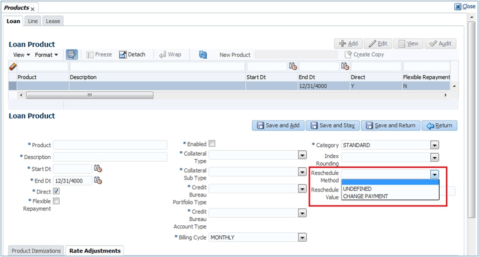

During the Product setup, you can define and control the changes in loan paymentlease amount using Reschedule Method and Reschedule Value fields.
Figure D-1 Variable and Fixed Interest Rate
  • When Reschedule Method is selected as UNDEFINED, no payment changes are allowed.
  • When Reschedule Method is selected as CHANGE PAYMENT, and Reschedule Value is specified as 0, loan paymentlease amount changes every time depending on the variable rate.
  • When Reschedule Method is selected as CHANGE PAYMENT, and Reschedule Value is specified in percentage (i.e. 5%, 10%) loan paymentlease amount changes only when the variable rate increases upto the defined percentage. (For example, if change percentage is specified as 10%, loan paymentlease amount changes only if the variable rate increases by 10%. Else, no change is allowed.)
Hence the impact of variable rates on loan paymentlease amount can be controlled to stop negative amortization.
