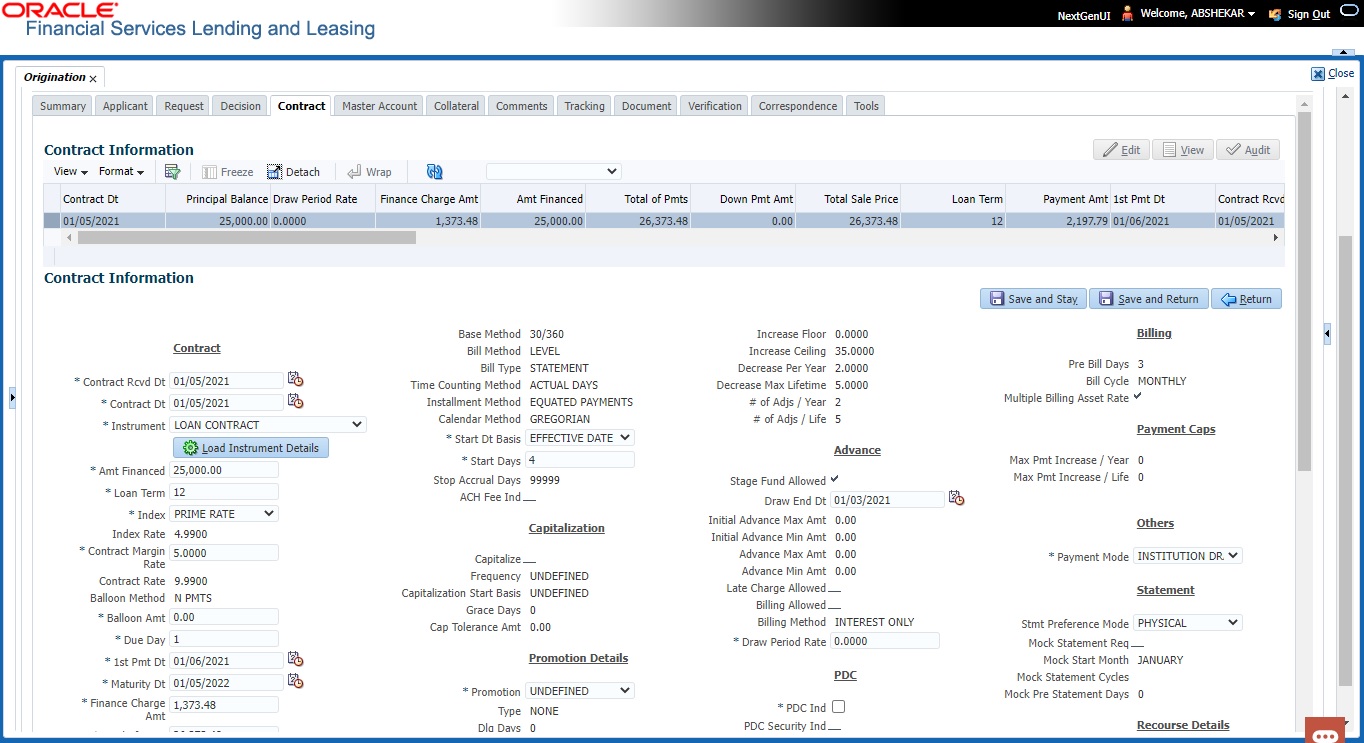

To enter the contract details
  1. Open the Funding screen and load the application you want to work with.
  2. On the Funding screen, click the Contract tab.
    • If the application you opened is for a Islamic LoanLine of creditLease, the LoanLine of creditLease screen appears.
  3. Using the information in the contract packet, complete the Contract section.
    (The system calculator may used when completing this section. For more information, see the Tools chapter.)
  4. In this section, you can perform any of the Basic Operations mentioned in Navigation chapter.
    A brief description of the fields is given below:
    Table 8-1 Contract
    Field Do this
    Contract section
    Contract Rcvd Dt Specify the contract received date.
    Contract Dt Specify the contract date.
    Instrument Select the required instrument from the drop down list and click on Load Instrument Details.
    Amt Financed Specify the amount financed: the Loan amount applied minus the prepaid finance charges. Prepaid finance charges can be found on the Good Faith Estimate/Settlement (HUD-1 or 1A). For example, if the borrower’s note is for $100,000 and the prepaid finance charge total is $5,000, the amount financed would be $95,000. The amount financed is the figure on which the annual percentage rate (APR) is based.
    Loan Term Specify the term/number of payments.
    Index Select the index.
    Index Rate View the index rate.
    Contract Margin Rate Specify the margin rate.
    Contract Rate View the interest rate.
    The following 3 fields - Regulatory Name, Regulatory Rate, and Contract Imputed Rate are displayed only if the Imputed Interest check box is selected in Contract Setup (i.e. Setup > Administration > Products > Contract screen).
    The value in these fields are automatically populated from setup on selecting a Instrument with imputed interest and clicking on Load Details.
    Regulatory Name The regulatory name is populated with the value defined in Setup > Administration > Products > Regulatory Rates screen.
    Regulatory Rate
    The regulatory rate is populated on loading an instrument with the Interest Rate defined for that definition in Setup > Administration > Products > Regulatory Rates screen.
    Note: If there are no matching records with regulatory rate, the Edits (underlying rules) validation fails (if Edits are enabled) and system does not allow to save the contract information.
    View the contract imputed rate which is derived based on Contract Rate and Regulatory rate as indicated below:
    • If Contract Rate - Regulatory Rate = 0, Imputed Rate = 0
    • If Contract Rate - Regulatory Rate > 0, Imputed Rate = 0
    • If Contract Rate - Regulatory Rate < 0, Imputed rate = Regulatory Rate (minus) Contract Rate.
    While funding if the contract Imputed Rate is greater than 0, system automatically calculates Imputed Interest Amortization schedule. For more information, refer to Imputed Interest section below.
    Balloon Method View the balloon payment method.
    Balloon Amt Specify the balloon amount.
    Due Day Specify the due day.
    1st Pmt Dt Specify the first payment date.
    Maturity Dt Specify the maturity date.
    Finance Charge Amt Specify the finance charge: the amount of interest, prepaid finance charge, and certain insurance premiums (if any) that the borrower will be expected to pay over the life of the Loan.
    Total of Pmts Specify the total of payments.
    Down Pmt Amt Specify the down payment amount.
    Total Sale Price Specify the total sales price.
    Payment Amt Specify the payment amount.
    Final Pmt Amt Specify the final payment amount.This amount will be same as that in the Payment Amt field when the installment method is EQUAL PAYMENTS. (required).
    Repmt Currency Specify the currency to be used for repaying the Loan.
    Principal Balance View the principal balance on the Loan.
    APR Specify the annual percentage rate: the cost of the Loan in percentage terms taking into account various Loan charges of which interest is only one such charge. Other charges which are used in calculating the APR are private mortgage insurance of FHA mortgage insurance premium (when applicable) and prepaid finance charges (Loan discount, origination fees, prepaid interest and other credit costs). The APR is calculated by spreading these charges over the life of the Loan, which results in a rate higher than the interest rate shown on the mortgage/deed-of-trust note. If interest was the only finance charge, then the interest rate and the annual percentage rate would be the same.
    Verified Dt Specify the contract verification date.
    Verified By View the user id who verified the contract.
    Signing Dt Select the signing date on when the documents is signed.
    Probable Delivery Dt Select the probably delivery date.
    Note: For Islamic products the following additional fields will be displayed.
    Residual Income View the residual income for the residual days.
    Residual Days View the number of residual days.
    IRR View the interest rate of return.
    Profit Rate View the profit rate (display only).

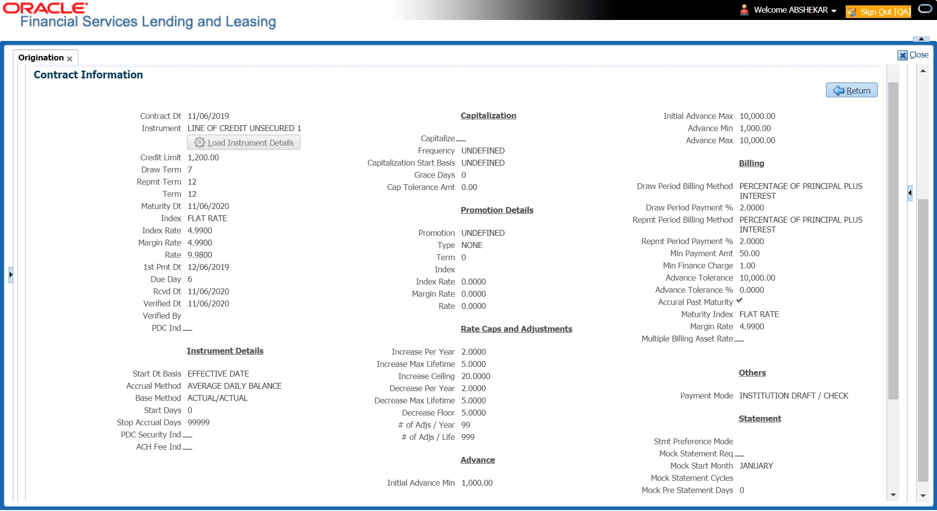

    Field Do this
    Contract section
    Credit Limit Specify the credit limit.
    Draw Term Enter the draw term. This is the period of time during which you can receive advances.
    Repmt Term Enter the repayment term. This is the period of time during which you must pay the outstanding balance of your account, with accrued interest, but may not request further advances. The repayment period begins at the end of the draw period.
    Term Enter the term.
    Maturity Dt Enter the maturity date.
    Rcvd Dt Enter the contract received date.
    Verified Dt Enter the contract verification date.
    PDC Ind If selected, indicates that the customer has opted for PDC.
    Instrument Details – An instrument is a contract with specific rules tied to it. An instrument associated with the application indicates OFSLL of the type of contract being used for the approved loan. Items defined in the contract are locked in when you select the instrument from drop down list and click on Load Instrument Details. These values cannot be changed on the funding screen.
    Any changes to the instrument in account will be handled by monetary/non-monetary transactions.
    The system loads all the rules established by the company that are required at the time of funding; for example, the accrual method, billing method, type of billing, tolerance, due dates, extensions and so on.
    Start Dt Basis View the accrual start basis.
    Accrual Method View the accrual calculation method.
    Base Method View the accrual base method.
    Start Days View the accrual start days.
    Stop Accrual Days View the accrual stop days.
    PDC Security Ind If selected, indicates that the customer has submitted the PDC as a security.
    ACH Fee Ind
    Indicates that the ACH fee should be applied or not. Depending on the status of check box, the ACH fee is applied based following conditions
    • When the check box is selected and the fee amount is ZERO, system will not apply the ACH fee.
    • When the check box is selected and the fee amount is BLANK, system will apply the ACH fee from Contract setup.
    • When the check box is selected and the fee amount is specified, system will apply the specified amount and overrides the ACH fee amount mentioned in Contract Setup.
    • When the check box is not selected, system will apply the ACH fee amount mentioned in Contract Setup.

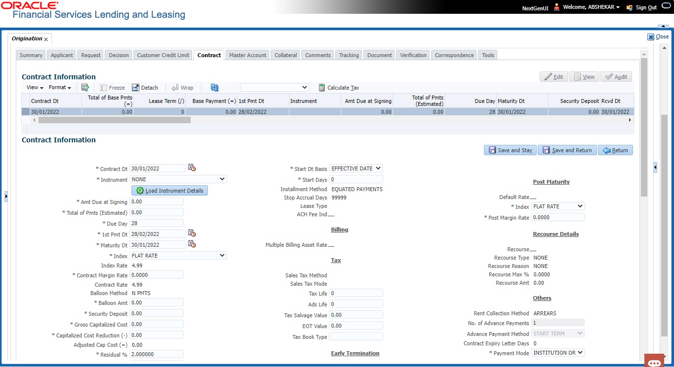

    Table 8-3 Contract
    Field Do this
    Contract section
    Amt Due at Signing Enter the prepaid amount.
    Total of Pmts (Estimated) Enter the estimated total of payments.
    Index
    Select the applicable index type from drop-down list.
    Note: If the lease calculation method is selected as Rent Factor, then Flat Rate Index type is applicable by default.
    Index Rate Specify the approved index rate.
    Contract Margin Rate Specify the contract margin rate.
    Contract Rate Specify the contract rate.
    Amortization Rate Specify the Amortization Rate for the Lease Contract. This is the rate used to generate the amortization schedule. The default value is maintained as '0.000'.
    Balloon Method
    Note: This field is displayed only if the lease calculation method is Interest Rate.
    Balloon Amt
    Security Deposit Specify the security deposit amount.
    Gross Capitalized Cost Enter the gross capitalized cost.
    Capitalized Cost Reduction (-) Enter the cap cost reduction.
    Adjusted Cap Cost (=) Enter the adjusted cap cost.
    Residual % View the residual percentage.
    Residual Value (-) Enter the residual value.
    Depreciation Value (=) Specify the depreciation value.
    Rent Charge (+) Enter the rent.
    Rent Factor
    View the rent factor.
    Note: This field is applicable only if the lease calculation method is selected as Rent Factor.
    Total of Base Pmts (=) Enter the total of payments.
    Lease Term (/) Enter the term.
    Base Payment (=) Enter the payment amount.
    Estimated Sales Tax (+) Enter the sales tax amount.
    Sales Tax View the sales tax percentage.
    Estimated Pmt (=) Enter the payment amount percentage.
    Rcvd Dt Specify the date on which deposit is received.
    Depreciation section
    The depreciation details defined in Setup > Contract > Lease screen are auto populated in this section and can be modified as required. The same is used for asset depreciation calculation when the batch job TAMDEP_BJ_121_01 (DEPRECIATION RATE PROCESSING) is executed.
    Depreciation Start Dt
    System auto populates the contract date as the default date for Depreciation Start Date. You can enter the required depreciation start date from the adjoining calendar. Ensure that date selected is not earlier than lease contract date or greater than account maturity date.
    Depreciation accounting is done from this date onwards and is calculated till the time asset is associated with this Account.
    Depreciation Method
    View / Select the asset depreciation method to be used for calculation as one of the following from the drop-down list.
    • FLAT RATE: This method is used to depreciate the asset over a fixed time using a fixed rate. This method of calculation is similar to Written Down Value Method (Diminishing Balance Method / Reducing Installment Method). On selecting this option, the details specified in Contract Setup screen for the following fields - Base Rate, Adjusting Rate and Bonus Rate are considered for calculation.
    • LIFE BASED: This method is used to depreciate the asset over a fixed time using the specified rates. This method of calculation is similar to Straight Line Method (Original Cost Method / Fixed Installment Method). On selecting this option the details specified in Depreciation Rate Schedule sub tab of Contract Setup screen is considered for calculation.
    Depreciation Convention View / Select the frequency at which the leased account should be updated with depreciation details from the drop-down list. The list is populated with frequency details (i.e. monthly, weekly, and so on) maintained in ‘FIRST_LAST_YEAR_CONVENTION_CD’ lookup code.
    Payment Caps
    Max Pmt Increase / Year The maximum payment that can be increased for the year.
    Max Pmt Increase / Life The maximum payment that can be increased in the life of an application.
    Instrument Details – An instrument is a contract with specific rules tied to it. An instrument associated with the application indicates OFSLL of the type of contract being used for the approved lease. Items defined in the contract are locked in when you select the instrument from drop down list and click on Load Instrument. These values cannot be changed on the funding screen.
    Calculation Method View the type of interest calculation method used for the selected instrument.
    Bill Method View the billing method.
    Bill Type View the billing type.
    Time Counting Method View the time counting method.
    Calendar Method View the Calendar Method.
    Start Dt Basis
    Select to define the start date from when the interest accrual is to be calculated for this instrument from the drop-down list.
    If you select the Effective Date, then the interest is calculated from the Contract date + Start Days (indicated below).
    If you select the Payment Date, then the interest is calculated based on (first payment date + Start Days (indicated below) minus one billing cycle).
    Start Days Specify the number of grace days after which the interest accrual is to be calculated. Ensure that the number of grace days is less than first payment date.
    Installment Method View the installment methods.
    Lease Type View the type of lease such as Direct Finance or Operating Lease.
    ACH Fee Ind
    Indicates that the ACH fee should be applied or not. Depending on the status of check box, the ACH fee is applied based following conditions:
    Billing section
    Multiple Billing Asset Rate
    Check this box to indicate if multiple asset rates are applicable for one billing period.
    System considers billing period from current due date to the next due date. Multiple rates are fetched only when rate end date (rate start date + rate frequency) ends one or more cycle(s) before the next due date i.e. current rate record does not cover the entire billing period.
    Tax section
    Sales Tax Method View the sales tax method used for tax calculation.
    Sales Tax Mode View the sales tax mode.
    Tax Life View the tax life.
    Ads Life View the ads life.
    Tax Salvage Value View the tax salvage value.
    EOT Value View the EOT value.
    Tax Book Type View the tax book type.
    Early Termination section
    Allowed To Terminate If checked, indicates that early termination of lease contract is allowed.
    Billed Term View the total billed amount on the lease contract.
    Lease Amt Recovered % View the percentage of lease amount recovered against the lease contract amount during early termination.
    Residual Details section

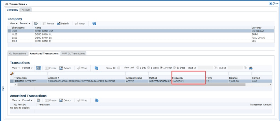

To record the imputed interest amount during loan creation stage, system automatically posts FND IMPUTED INTEREST monetary transaction with total imputed interest amount. In case of loan reversal/cancellation, REVERSE FND IMPUTED INTEREST transaction is posted to post reversal entry on account for imputed interest.
Once the application is funded, the Contract Imputed Rate is propagated to Servicing > Account Details > Contract Information tab.
Amortization Transactions record is created in Servicing > GL Transactions > Amortized Transactions with the following details:
Figure 8-15 Interfaces-GL Transactions-Imputed Amortization
  • Opening balance is updated with total imputed interest amount which is calculated as part of Imputed Interest amortization schedule.
  • Transaction = IMPUTED INTEREST, Method = IMPUTED SCHEDULE, and Frequency same as account billing frequency.
If case there is a change in repayment schedule due to change in interest rate, then respective imputed interest rate also changes since the principal changes. Along with this, if there is an early Payoff or account Charge-off, the remaining unearned imputed interest is written-off. On posting monetary transactions which changes the repayment schedule such as Due Date Change, Due Date Change Override, Change Term and so on, system recalculates imputed interest amortization schedule along with repayment schedule and posts an Imputed Interest amortization adjustment transaction.
In above cases, system posts the following adjustments/write-off and reversal transactions automatically on loan account to basically write-off some amount:
