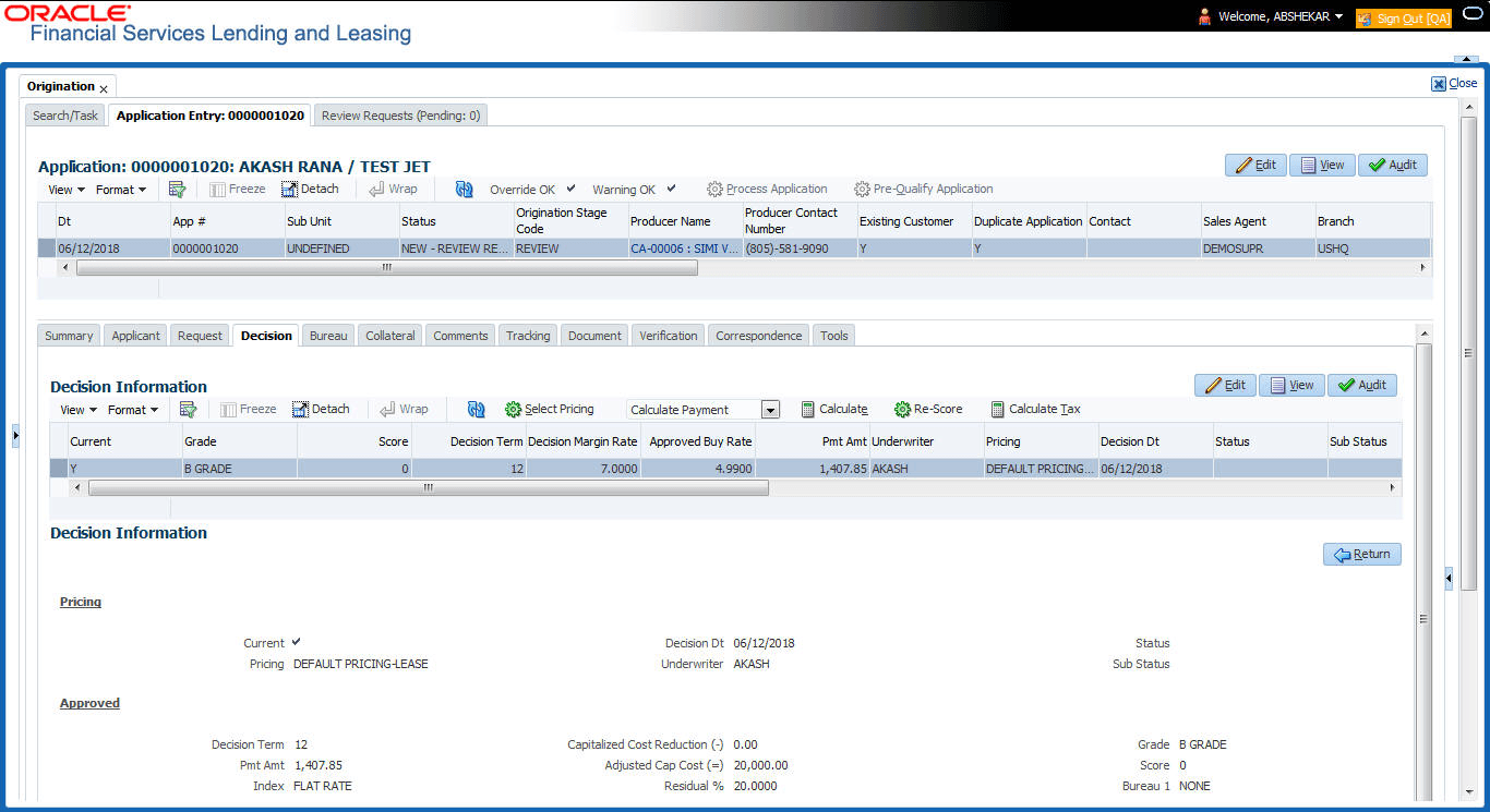

If you choose to approve or reject the LoanLine of creditLease manually, you must manually select the pricing (rule) set by the portfolio company for a specific product. The system validates this pricing against the information in the System Recommendation sections. The information in the Requested section comes from the application entry process and can be edited.
  • If the data meets your approval, change the status of the application to either APPROVED or REJECTED and enter any stipulations.
  • If you reject the application, change the status to REJECTED and enter the reasons for the adverse action on the Stipulations sub screen.
    You can use the quick calculator provided with the drop-down list adjacent to the Calculate button to calculate the required LoanLease parameters. You can also use the calculator available in Tools section for completing this step. For detailed information on using the Calculator tools, refer Tools chapter in the document.
To verify the application decision data
  1. Open the Underwriting screen and load the underwriting application you want to work with.
  2. Click Decision tab.
  3. Perform any of the Basic Operations mentioned in Navigation chapter.

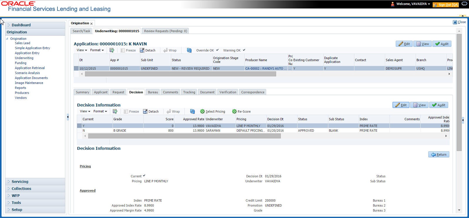

    Approved section
    Index Specify the index type.
    Approved Index Rate Specify the approved index rate.
    Approved Margin Rate Specify the approved margin rate.
    Approved Rate Specify the approved rate.
    Maturity Index Select the approved maturity index.
    Maturity Margin Rt Specify the maturity margin rate.
    Credit Limit Specify the credit limit.
    Promotion Select the promotion.
    Grade Select the credit grade.
    Score Specify the credit score.
    Draw Term Specify the draw term.
    Repmt Term Specify the repayment term.
    Bureau 1 Specify the Bureau 1.
    Bureau 2 Specify the Bureau 2.
    Bureau 3 Specify the Bureau 3.
    Comments Specify comments, if any.

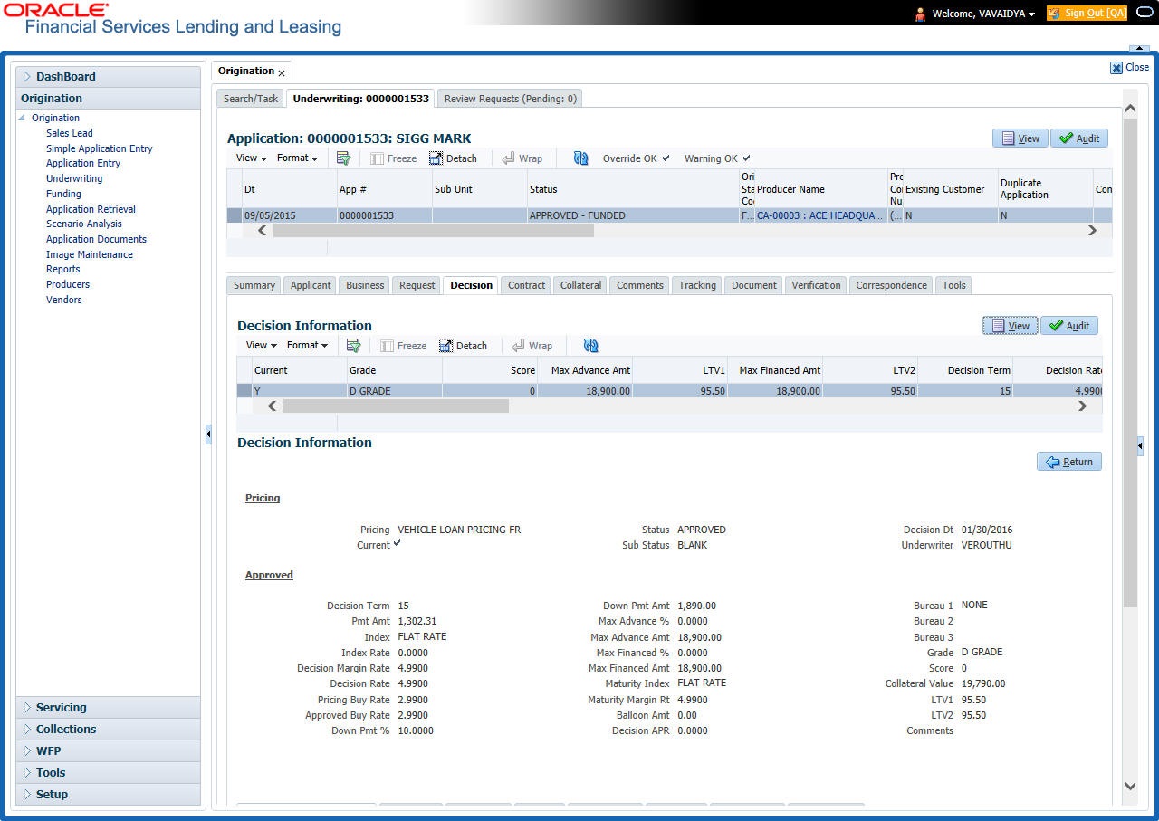

    Approved section
    Decision Term Specify the approved decision term.
    Pmt Amt Specify the approved payment amount.
    Decision Margin Rate Specify the approved decision margin rate.
    Decision Rate
    Specify the approved decision rate.
    Note: For Islamic products this field is displayed as Profit Rate.
    Pricing Buy Rate View the pricing buy rate.
    Approved Buy Rate View the approved buy rate which is by default the Pricing Buy Rate displayed above. You can also specify the required approved buy rate.
    Down Pmt % Specify the approved down payment percentage.
    Down Pmt Amt Specify the approved down payment amount.
    Max Advance % Specify the approved advance percentage.
    Max Advance Amt Specify the approved advance amount.
    Max Financed % Specify the maximum amount financed percentage.
    Max Financed Amt Specify the maximum amount financed.
    Maturity Index Select the approved post maturity index.
    Maturity Margin Rt Specify the maturity rate.
    Balloon Amt Specify the balloon amount.
    Decision APR Specify the decision APR.
    Collateral Value View the collateral value.
    LTV1 View the loan to value ratio.
    LTV2 View the loan to value ratio.

  5. Click Select Pricing.
    The system determines the best pricing match of all enabled LoanLine of creditLease pricing strings in the Setup menu and displays the results in the Pricing and Approved sections.
  6. Quick Calculate
    In the Decision Information section, there is a drop-down list adjacent to the Calculate button with following options to auto calculate different LoanLease decision parameters based on the data provided. Select the required option from the drop-down list and click Calculate:
    Table 7-32 Quick Calculate
    Lease Type Calculate Option
    Rent Factor
    Calculate Payment
    Calculate Residual Percent
    Calculate Gross Capitalized Cost
    Interest Rate
    Calculate Payment
    Calculate Interest Rate
    Calculate Term
    Calculate Lease Amount
    • CALCULATE PAYMENT
    • CALCULATE INTEREST RATE
    • CALCULATE TERM
    • CALCULATE LOAN AMOUNT
    The system displays the requested calculation in the respective field.
  7. Re-Score
    A Re-Score button is available next to Calculate. Whenever any sensitive Financial or Collateral information is amended in the Application, OFSLL displays a warning message Scoring sensitive information is changed. Re-score the application. You need to click on Re-Score to re-validate the grade and pricing accordingly.
    The display of the warning message to Re-score the application can be controlled using the respective System parameter. If the defined System Parameter is flagged Y, only then the message is displayed.
